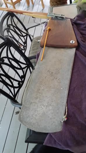

The picture attached is the tiller that I had to rebuild. Don't know if is to factory specs, but it works good.

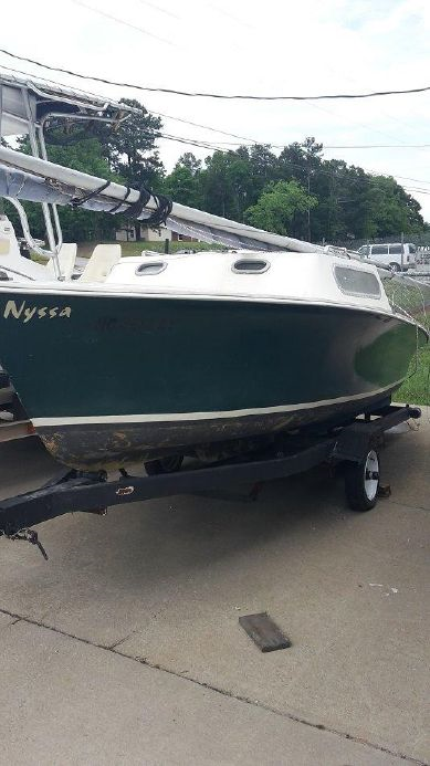

View attachment 124234Shown as a 1969 model for sale at Lake Lanier GA for $950.
Not to revive a dead thread, but I believe I am the new owner of 'Nyssa' as of 02/19/2020.
I purchased it for $400. The color, windows, and trailer in this photo, look identical to the "ship" I just bought. Even the year is correct.
She has a bent up mast, but, otherwise, she is in great shape.
The mast appears to have the same crosscut dimensions as a Hobiecat 16'. I'm currently trying to source one; but need to get the exact measurements first. Due to weather and work, it's going to be a week before I can get to the drydock and take exacting measurements.
But if my suspicion is correct, finding a mast will be easy.
I'm,also, going to be refurbishing the cabin, to give her some modern amenities and technology.
Plus the stove, head, and berth cushions are gone. The cabin is, basically, gutted. However, all the bulkheads and wood structures are still intact and in good, solid, shape. (They sure don't build them this stout these days) This is an impressively built "pocket yacht".
The only complaint I have, regarding it's construction, is that the rear deck relies on the styrofoam flotation for structural support. I'll be building up a solid framework to support the deck. (with locking storage cabinets) I do like the fact that the deck can be reconfigured as seats, or a flat "picnic" floor, with the simple removal of the center floorboard. So I will, definitely, keep that feature intact; in my redesign.
I purchased it for $400. The color, windows, and trailer in this photo, look identical to the "ship" I just bought. Even the year is correct...
Update: I was able to confirm that my boat is in fact Nyssa.
While prepping for new paint, I found the outline of leftover glue that spelled out the name, and quite clearly.
Pretty cool that I have one of the very few used as examples, across the internet.
After the restoration is completed, she will be getting renamed to "Miss Guided"

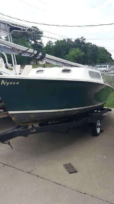

Already have the vang set. I just didn;t set it up, in these photos. Was just playing with the rigging, etc. The main sail is definitely stretched., and worn. The Jib, looks to be basically brand new, and hardly used. it's in great shape. I am missing the spinnaker, but I'm not to concerned with getting a spinnaker. Those are good for consistent winds, and where I sail, there isn't much of that. (mtn lake and all)
