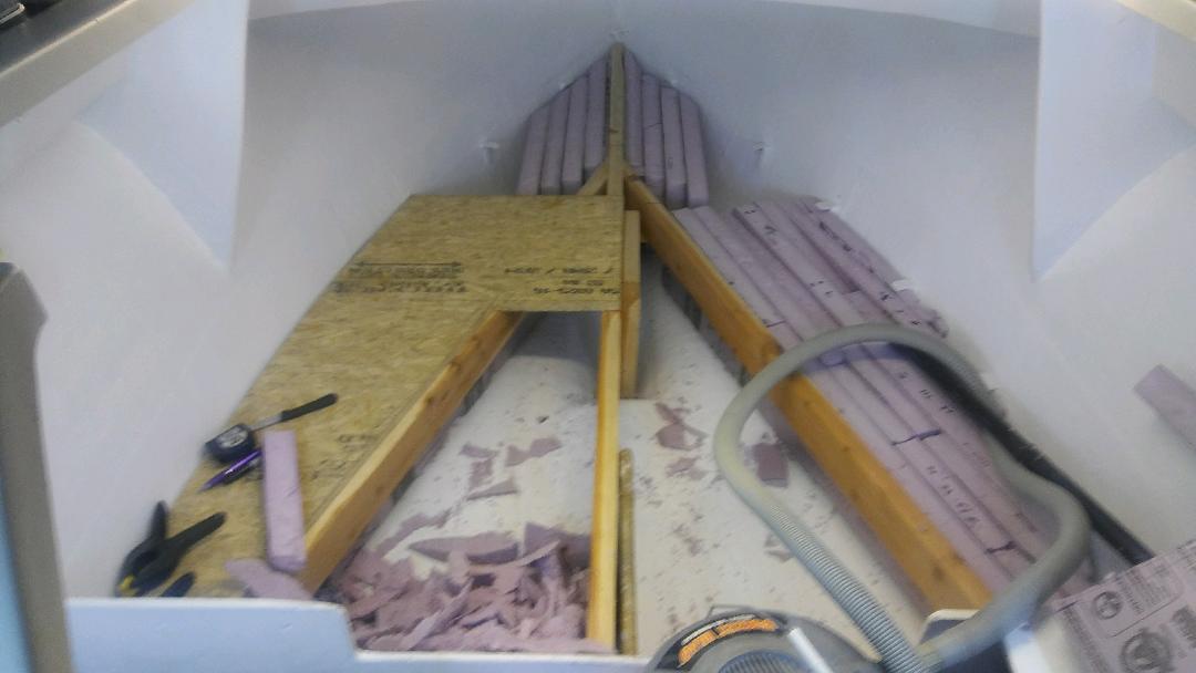

Hi Lofland 17 club.

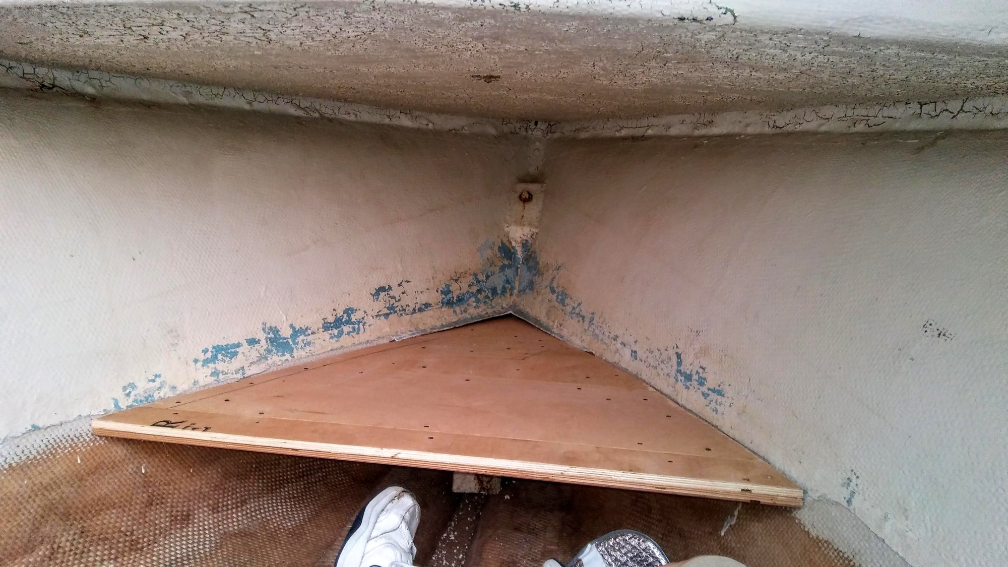

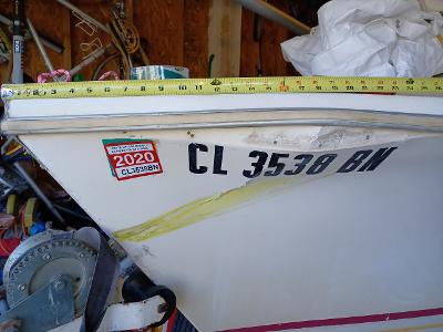

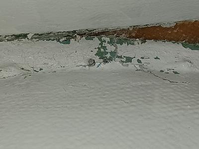

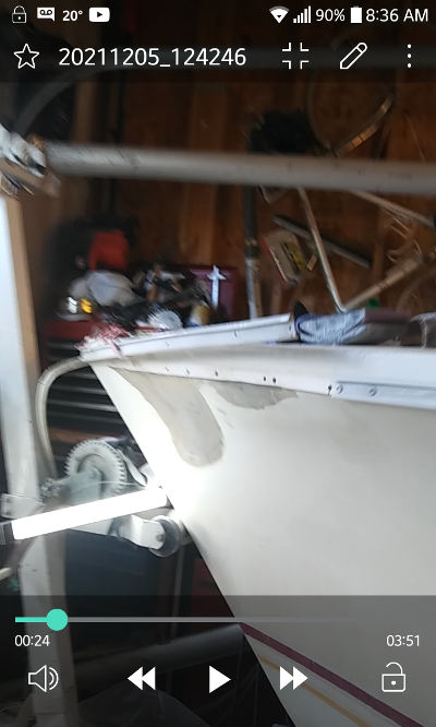

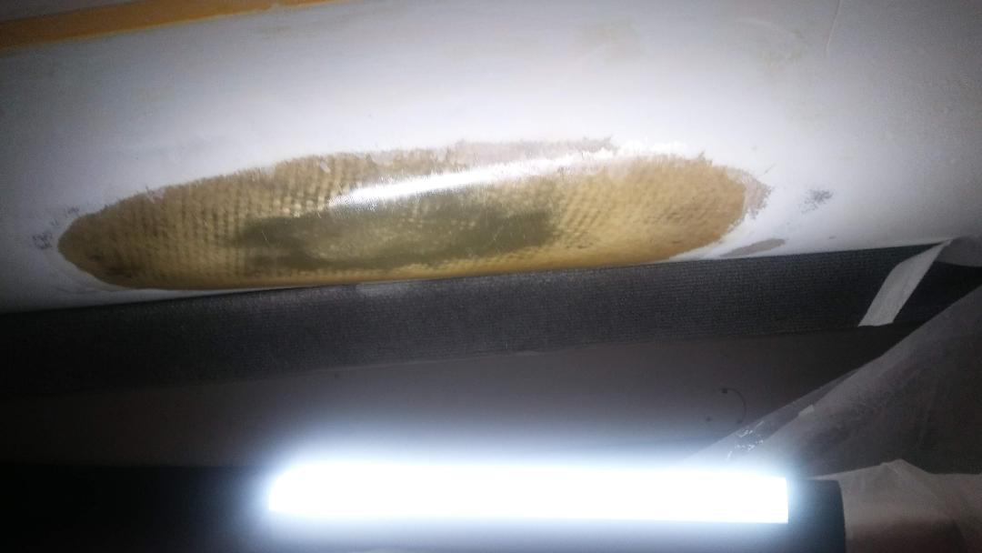

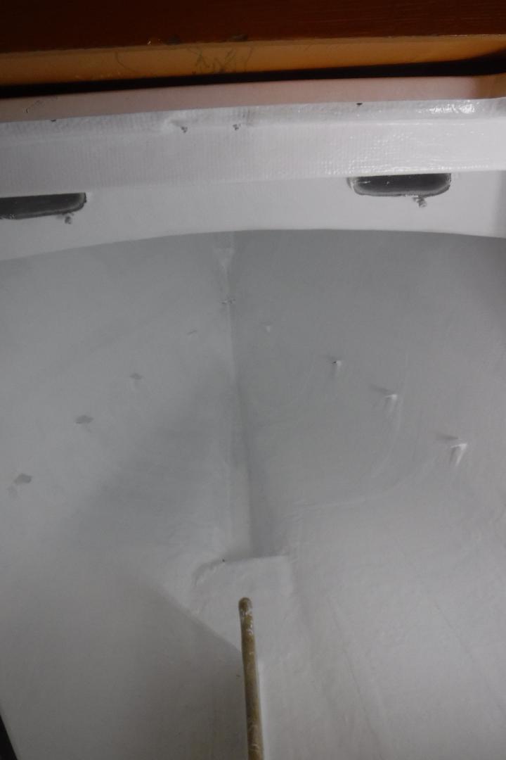

I bought my lofland for 500.00 3 yrs ago and had to redo the cabin. The boat was stored nose down and filled with water rotted out the bed only. Looked like carpet was glued all over. Ran through a harbor freight grinder to the cabin to remove much of it. Next acetone to get the the fine stuff left over. Hull on my boat seemed very thin before grinding. I added 1 layer of chop strand.
Then got hit by a jet ski in cherry creek dam aurora Co 2018. The one layer of cop strand acted like a thin liner. It pulled away from the hull but kept the water out. Back to the 2ND grinder and a respirator mask. I repaired hole and added 3 layers of chop-strand inside after re grinding down the inside of the hull. I used a laser line and placed tabs along hull at the bed level Made a frame with cedar down center and Y cross supports to the bulkhead. I used the left over gel coat to repaint the inside of the cabin. I found that with just a little sanding of the gelcoat you can repair the fiberglass over it. You can not do that with paint.

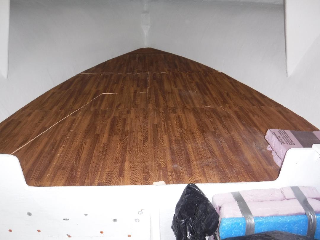

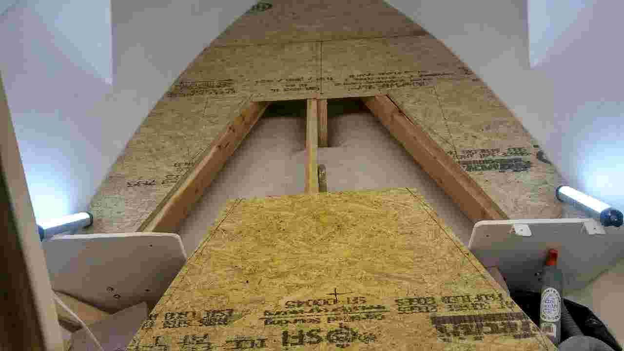

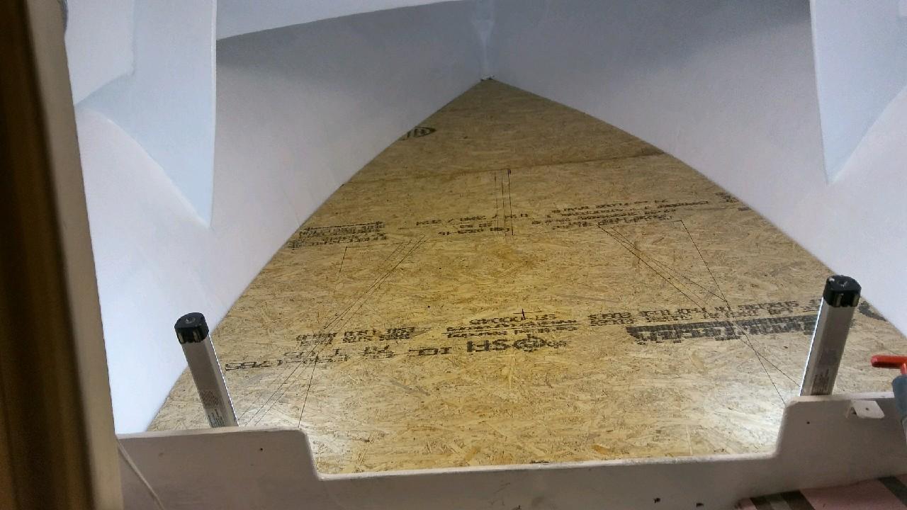

Next I found ADVANTEC PERFORMS.COM Flooring tongue and grove . This is stiffer and more water proof then marine plywood. I put a sample piece in hot boiling water and let it cool for 8 hrs. It swelled 1/16 in but kept all of it's strength.
FYI- the lofland 17 only needs one sheet of wood to do the cabin. This is tongue and grove. It took days to think out the best way to do this. I made card board template held togtther with wing nut blots pushed through to help with adjustments . The front 3 feet was a triangle and and side parts like a H-bottom then removed a v center for lift out storage. The v center on the bulkhead was cut out at a angle so that it can not fall through .To hold down the 3 front parts only 3 screws are needed. all the tongue and grove matchup. The cuts at the hull were cut out at an angle to match the hull. I added foam play mats to cabin in the same shape as the wood so you can lift out the V, and Velcro lights.
Flotation in this boat was due to the front cabin being a air tight bed and two side foam floats behind the seats. I had to add flotation because my bed now is not air tight. Also added sand in the front bilge for stability. I made a new fiberglass top for the cabin. It came out almost perfect. Did the boat come with a fiberglass top? I also made a deck top deck cover from fiberglass. Haven't shined that up yet, you can stand on the thing. The only thing now is to make is a fiberglass door with air vents.
If anyone needs a better description or photos contact me.

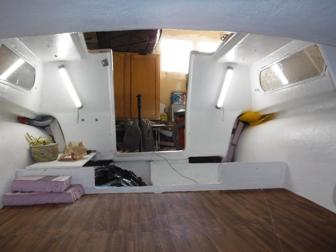

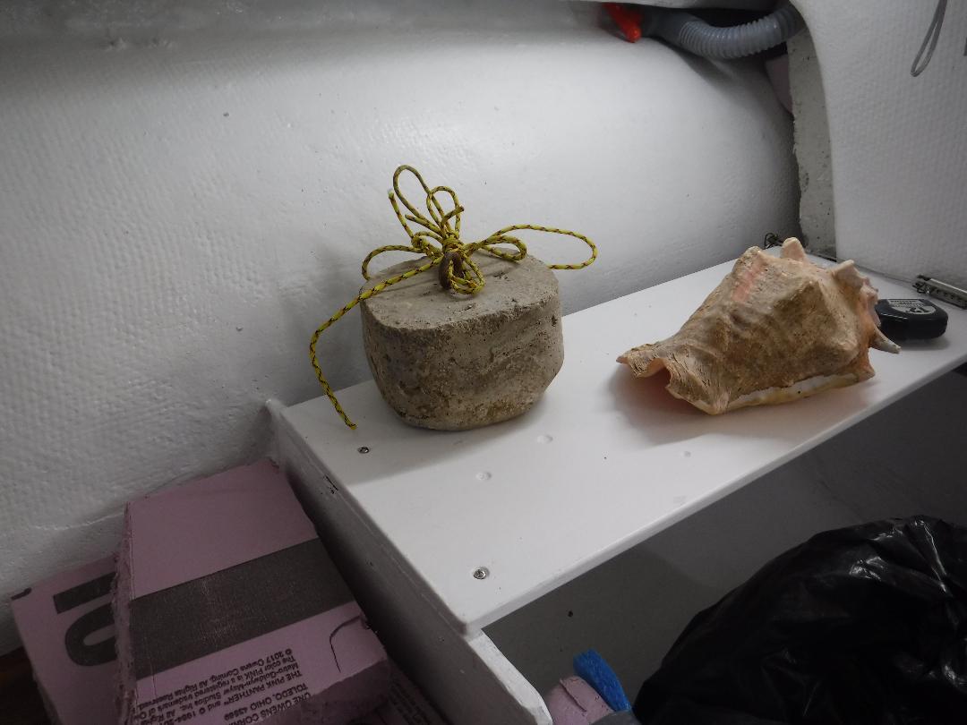

Now for a few photos inside cabin before, my anchor, my horn form a vacation in St Lucia, inside cabin after.

Feb 20, 2020
24
Lofland Picnic 17' Lake Lanier, GA
Hi Lofland 17 club.
Nice job on the rebuild. Looks great.

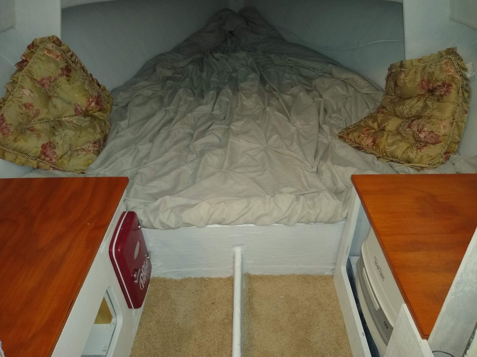

I went a bit more complicated on my cabin rebuild, with a hideaway stove and head.
Still not quite finished yet; as you can see the toilet.
I'm also going to be incorporating some raised cabinetry along the hull walls for things like canned foods, toilet paper, etc, etc.
And a 7" TV/Radio in the middle where the cabin slopes down, and adding a shelf to span the rest of the width.
Jul 4, 2020
3
Lofland 17 picnic lofland aurora
Wow! I like your seats and the fridge. I need to work on mine. My toilet is a 5gl bucket with a foam seat and 13 galbags to toss out. Never had to use it but but can if needed. Did you cut down the bulkhead ? Its kinda a pain to have it a different height then the bed. My hatch is about 36in by 38 in I have not found a good way to attach my home made fiberglass hatch.
I Want to be able to lift it up and k eep it open.
