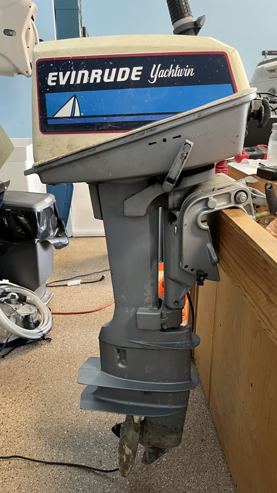

Here are some pics of my Evinrude that came with my boat. Dated the model number to 1985. :D I haven't tried to start it up yet, but hoping to this weekend.

I would first see if that old evinrude is in good shape. If it was well maintained it may be perfectly ok and start easily. Except the benefit of the long shaft, and the high thrust prop on the SailPro.

that evinrude is strong like bull. well made, parts are available. keep up with the service and it should treat you well for many years to come.
i have an 85' 15 horse that is great. everyone in the family uses it all the time from kids to gramps. that era motor was well made and dependable.

I don't have specific knowledge of the Mercury 5hp other that it's a single cylinder motor. You can probably expect it to vibrate a lot and be noisy and irritating. You might do a search on YouTube for videos of it running or see if this particular motor suffers from it's single cylinder design.
The motor that came with your boat has two cylinders..."yachTWIN". Much smoother motor. I'd keep that thing running with a carb rebuild, change the lower drive oil, fresh plugs, and while I was at it, it's cheap and easy to put a new fuel pump in it. Then, I'd never let it near fuel with ethanol in it, and I'd always run stabilizer in the fuel, so it's sure to get stored in the winter with stabilizer in it.
Oh, and it might be interesting to know what it's compression is, but if it runs well, that could wait.

Wow, okay, thanks everyone for giving me hope on the Evinrude. I had no idea.
I love the idea of keeping it in service, just don't really have anyone around here to help with it if I get in above my neck. I should have a chance to fire it up within the week and will report back. Either way, I will find videos on how to do those repairs. The guy I bought it from said that it fired right up when he used it once last summer, and that he stored it upright, so I'll give it a shot.

My brother-in-law came over with motor muffs and this baby started up almost right away! It looks like this has been pretty well cared for, new spark plugs, new air filter (I think). I noticed some gear oil leaking, so I suspect it needs a new gasket. I'm gonna order the manual for this puppy and do some of the basic maintenance, but she sounded really good!
its not gear oil that's unburnt 2 stroke oil in the exhaust shaft. There is no gasket around the lower unit. I would run dome OMC engine turn through it and clean a lot of that old junk out. It works well but your motor will puke all manner of nastiness so make sure its not on anything you want to keep nice when you run it or run it in a bucket or trash can. As far as maintenance put a new impeller in it, change the gear oil in the lower unit, replace the gaskets on the lower unit screws, change the plugs and run the engine tuner stuff through it. That motor will run for many years. I know as I used to work on them at an Evinrude shop. There a good little motor and the only difference between the 9.9HP and the 15HP is the carb so parts are easily available.
One note if your not familiar with outboards. running them on muffs is ok but it will not help you diagnose a weak impeller on the water pump. Best practice is to run them in a trash can so as to not add undue pressure on the water system and be able to identify real world over heating issues. Many a motor came to the shop stating: Motor runs fine on the trailer in the drive way but dies after a few min on the water. Answer impeller shot.
Also if your going to store it for more than a week I prefer to run them out of gas at the ramp after a day on the water. Different opinions on that one but its worked in my small engines for years.
Edit: Are you sure the water pickup is where your muffs are? I know its been a few years for me now but i thought the water pickup was in the plate above the prop on those? Make sure you see a strong stream when you run it at anything over idle (idle it may only drip depending on the motor).
