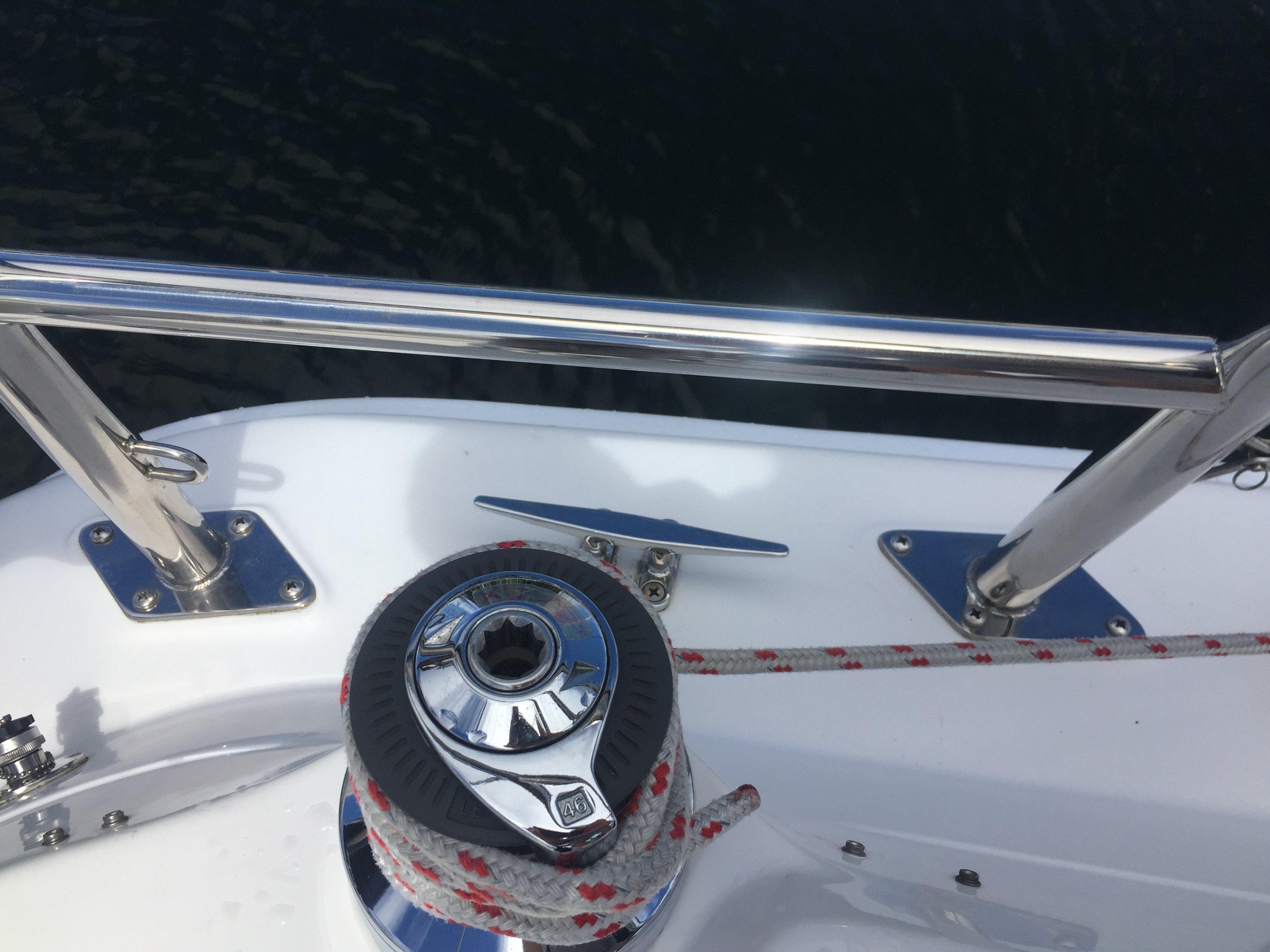

Hi All,
I am thinking about getting an asymmetrical chute - actually one of the Doyle 'Utility Power Sails'.
It is pretty obvious with the attachment at the bow, and the mast has a string where the halyard would go and am empty clutch - but I am a bit unsure on the sheet leads.
The arch has these loops on each side that seem
sturdy and would lead fairly.
See attached pic.
Seems like possibly they were made exactly for this but I am curious how the setup is for those of you that have a spinnaker have the sheets led and if it was setup professionally or if you did it yourself.

My gennaker sheets are led back to a block that I clip onto these loops. The sheets run outside of everything. I did this myself but I did get confirmation that the loos on the back of the arch were for the gennaker sheets. My boat is a little smaller but the principal is the same.

Yes, I think you are right for the attachment - some googling showed that others are using those loops off the arch. Seems that is exactly what they are there for.

MFD do not buy Doyle UPS. Buy a real, socked, Asym chute. As far as the block mount is concerned that is the correct location. I tack mine to the furthest hole on the anchor roller assembly but am working on making a better mounting point just forward of the anchor it's self. I'll post that when it happens.

NO WAY I would trust those little braised-on loops on the pulpit to handle the loads of a spinnaker on a 40 foot boat. No way. Way too small, and non-articulating.
That's the builder cheaping out, and not putting proper Winchard D-rings on the deck. With a BIG ratcheting block. That's the proper setup from the builder.
A better setup that does not involve drilling the deck would be to use a block attached to the cleat with a dyneema soft shackle. Like this.
A better setup that does not in love drilling the deck would be to use a block attached to the cleat with a dyneema soft shackle. Like this.

I'm not sure what you guys think your looking at but that is 2" traveler arch tubing and those weled rings are roughly 1/4 in of stainless. It's all welded not braised. Last time I checked my cleats don't articulate either. They were welded there just to take spinnaker blocks. They work like a dream. I fly my 1192 square foot asym from sheets led back to Harken blocks attached to those rings, NO PROBLEMS.

Jackdaw has the close idea, but there is so little distance from either the cleat or that small loop. I suggest using Jackdaw's block and Dyneema line, put the line around that vertical pushpit piece, above that loop, and use that loop to keep the block up in the air. You could also unbolt the base off the deck and put a large SS round ring to attach to, then rebolt. Lash the ring to the vertcal pole, above the little loop.

That winch looks VERY close, can the handle even turn? Maybe it's an optical illusion in that picture.
Clearly in any install you need a fair and clear run from wherever the block is to the winch.
Is that little loop strong enough? Pulled on straight under moderate load; well hell maybe. But I know the load our spinnaker comes under, any boat can load one up. When stuff breaks it breaks as the worst time.

It's a lack of depth perception in the picture. I use 10" winch handles with no clearance problems on that winch. It's very strong actually and by the time you add a shackle and the block it's at a perfect angle to the winch bottom so as to wrap properly. I'm more leary about the anchor roller as the tack point. That's a 46 winch, not huge but not small either if that helps with size.
