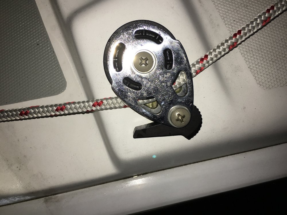

We have an asym for our 41DS, the sail is mounted on a Selden GX 15 top down furler connected to a Selden bowsprit protruding through a donut mounted on the anchor roller and clipped to the fore deck which makes for an easily managed sail. We are also in the camp with the use of the ring fusion welded to the arch. The only issue with the set up, the same winch is used for both the jib and the spinnaker, so unfurling the spinnaker while the jib is still set is a bit of a trick, but it can be done. Anything over 10-12 kts of wind and you will be dousing the sail at least this has been my experience.
Sorry for the dirty boat, we just pulled in from a salty 60nm trek. I changed the original turning blocks out for locking blocks. Cinch off the jib and set the spin, then the load will be off the jib and you can take it in by hand or turn it to the cabin top winch.
