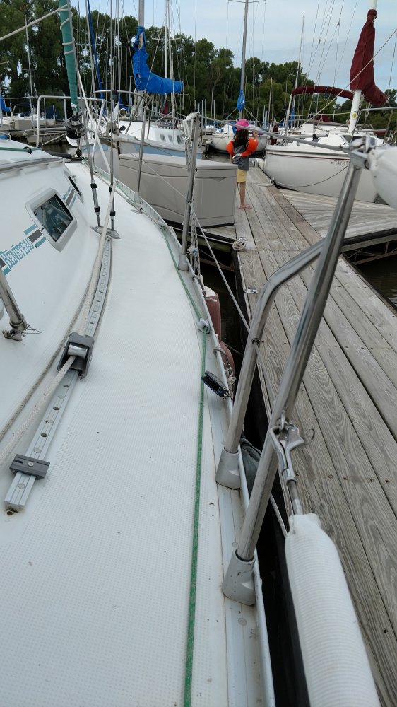

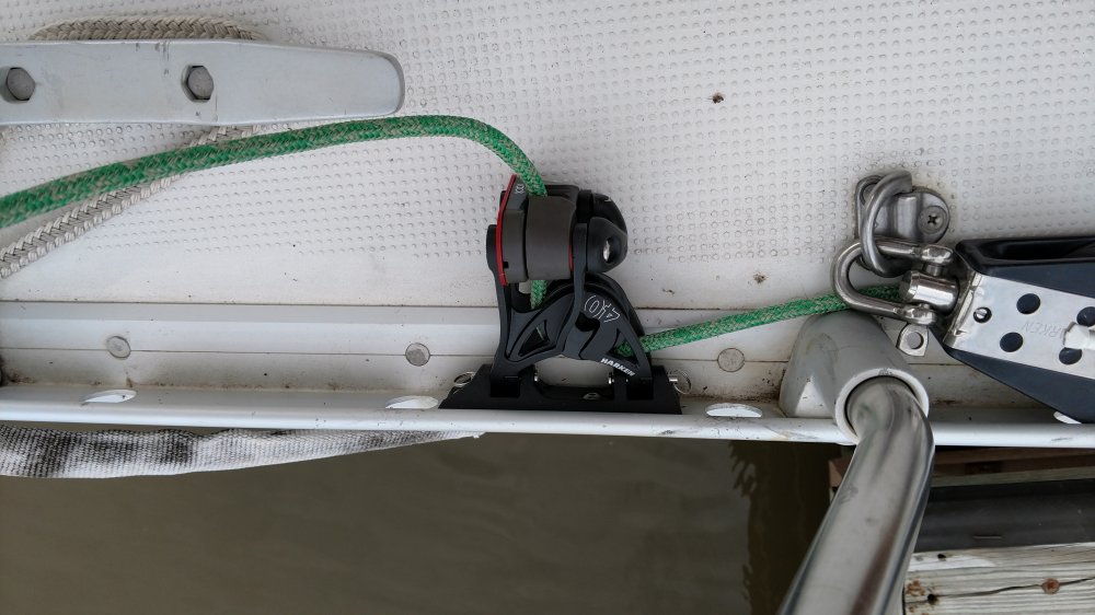

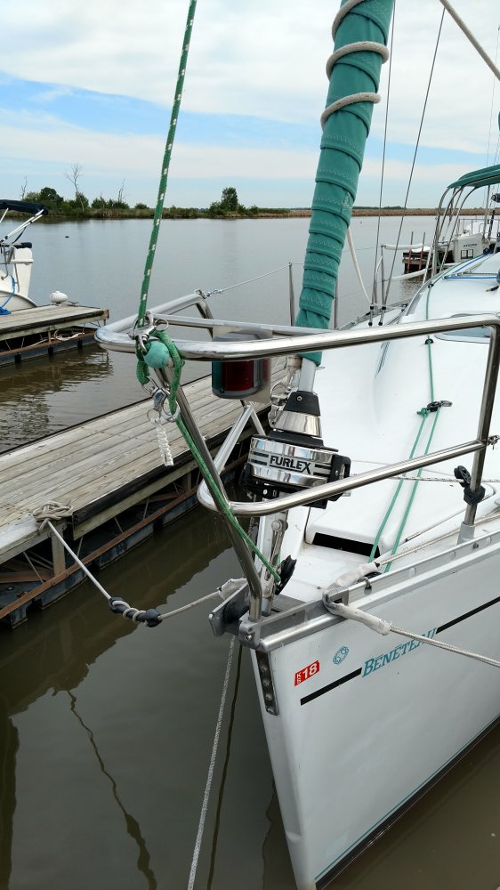

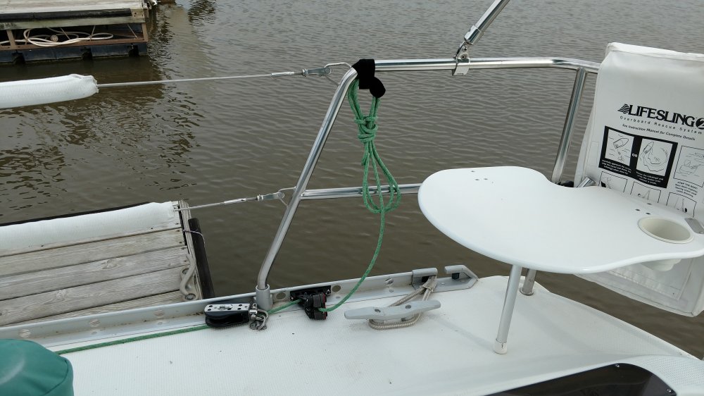

How do you attach the Tack line? Do you somehow route it back to the cockpit to the starboard winch and if so how. I have the higher deck salon and don't want it to rub on my gelcoat . Or do you cleat it off on deck limiting adjustments?

Here is how my tack line and spin turning blocks are rigged on my First 310.

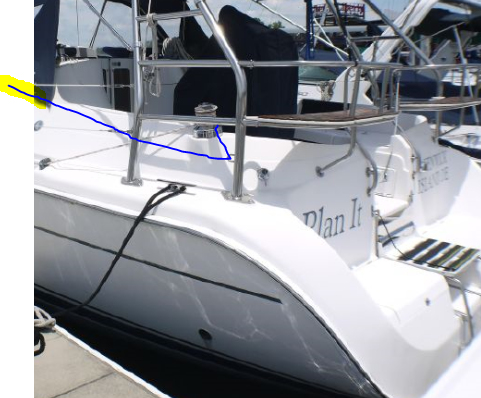

Hi All,
I am thinking about getting an asymmetrical chute - actually one of the Doyle 'Utility Power Sails'.
It is pretty obvious with the attachment at the bow, and the mast has a string where the halyard would go and am empty clutch - but I am a bit unsure on the sheet leads.
The arch has these loops on each side that seem sturdy and would lead fairly.
See attached pic.
Seems like possibly they were made exactly for this but I am curious how the setup is for those of you that have a spinnaker have the sheets led and if it was setup professionally or if you did it yourself
First, there appears to be enough horizontal clearance to the aft winch. There might be some issue with the position VERICALLY for a good lead to the winch with a snatch or other removable block. You need to check that. Remember it's not only when the line is tensioned, but as you pull on the line as you're initially setting the sail.
Secondly, my bigger concern is how the big sail up front has it sheet lead. On our boats with asymmetric spinnakers we've always found that the really sheeting angle that was optimum was forward of the stern. Maybe your sail is cut a lot differently, but I doubt it. If you have a toe rail which allowed for attachment of blocks (or even spectra straps), then you could rig a "twing". As it is, you'll be attaching the sail in a position I would guess is not really optimum of reaching.
I believe you said you had UPS. That, as others have pointed-out is really more like a genoa (except it's more full, is lighter, and doesn't attach to the forestay). I think that would be sheeted much farther forward. On your 41DS, I'm not sure you'd have it sheeted inboard of the lifelines -- but however, I think the sheeting angle would different than a asymmetric spinnaker.
