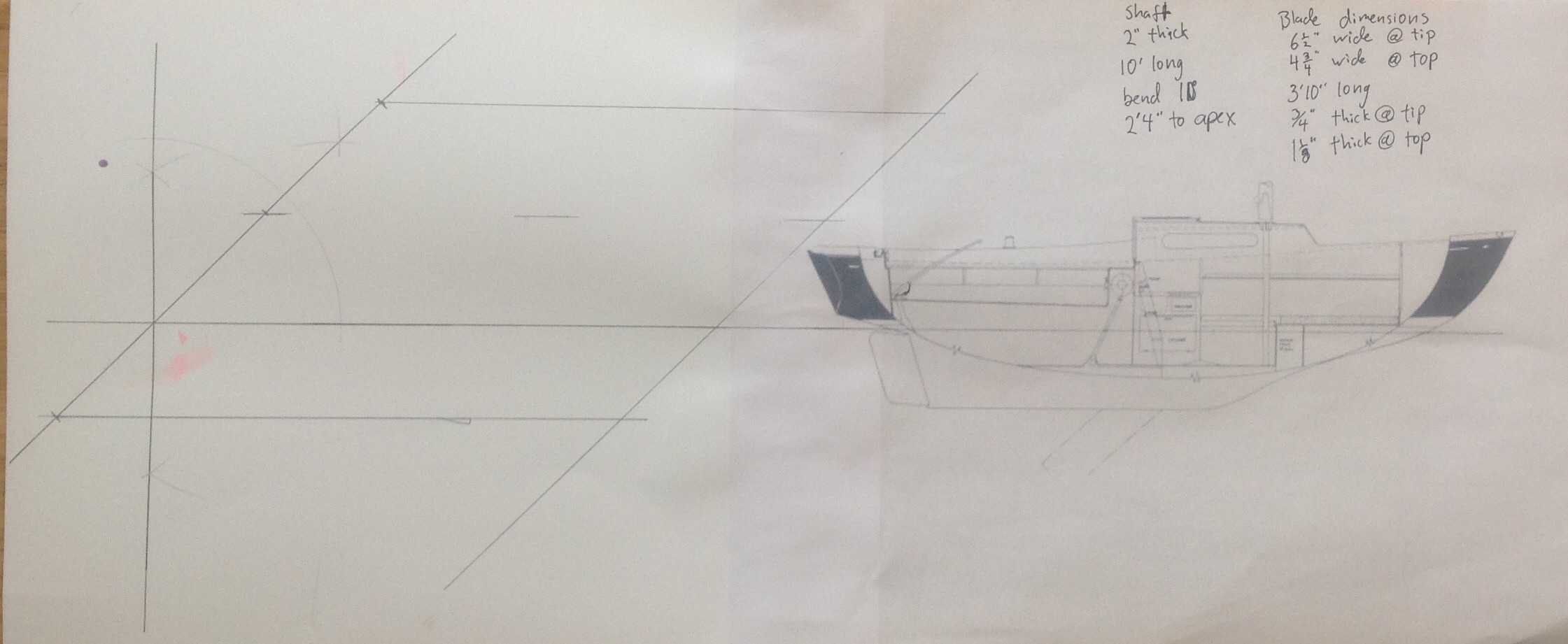

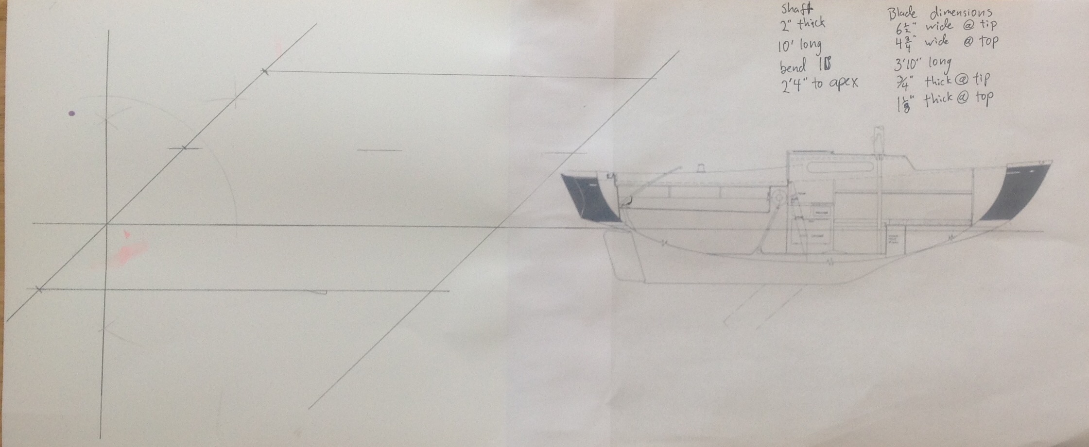

Going to keep this thread going with some thoughts as my Yuloh design emerges. Here is the design work based on the Junk rig assoc. article I linked earlier in this thread:
I simply downloaded and printed profile drawing of my boat off of the sailboatdata site. I figured out the scale from the LOA and jumped off from there. Yielded about a 14 foot Yuloh.

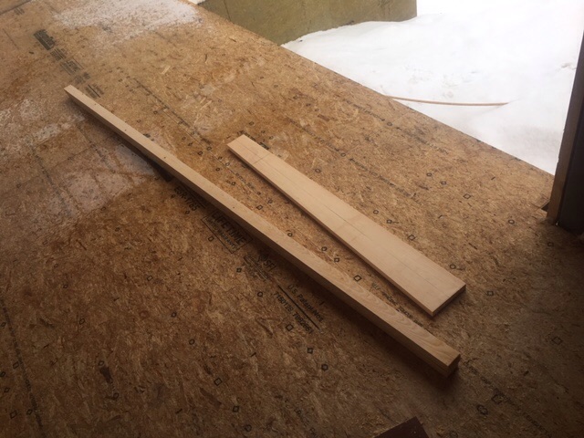

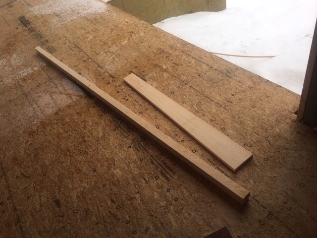

Here are the materials I'm using: A good quality spruce 2X8X10 for the loom (shaft) and a 5/4 X 8 piece of pine for the blade. Could use better woods for durability but I thik these will be strong enough and they are cheap and light.

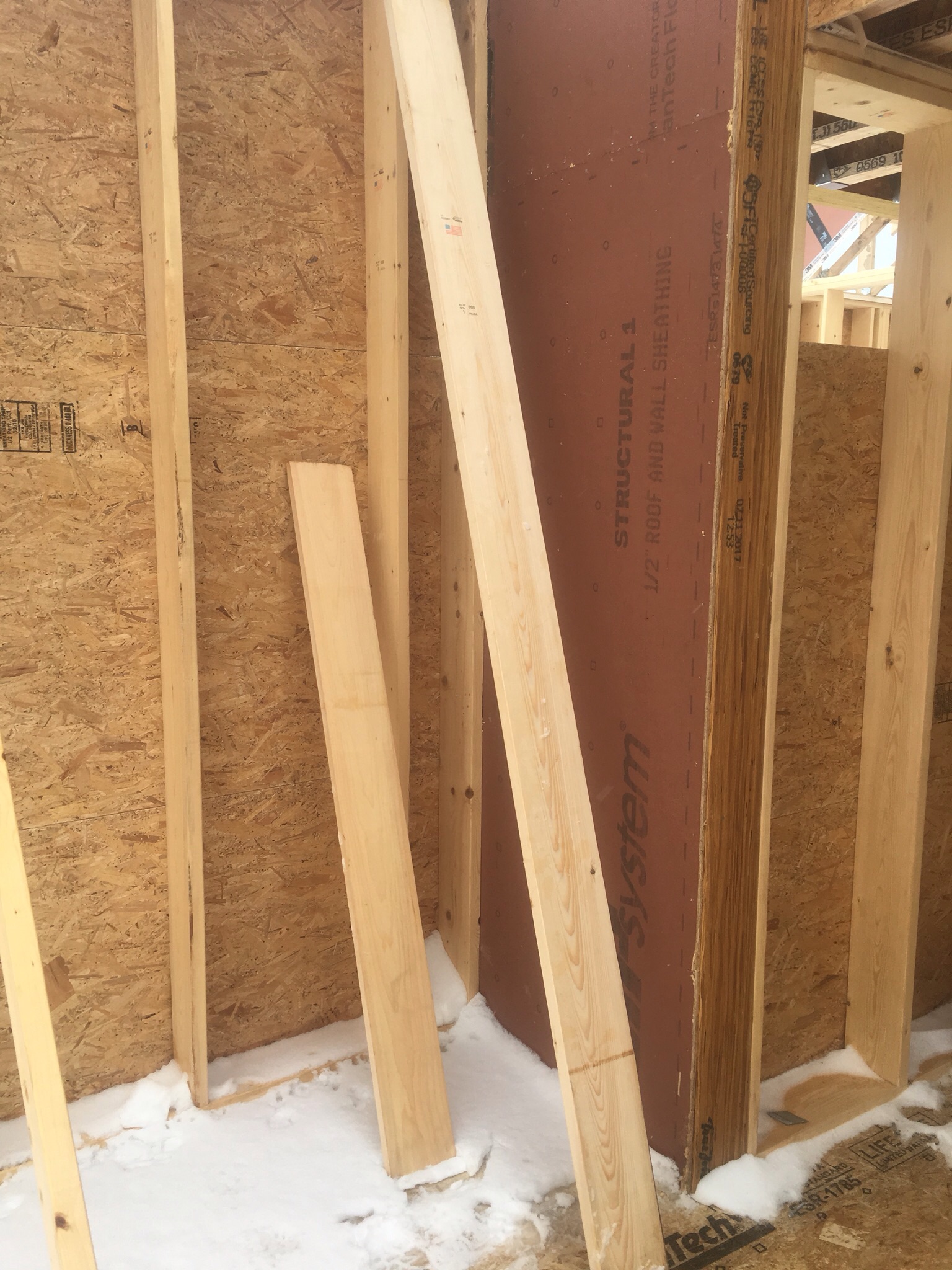

After the first step in the milling. I have the rough profile of the blade and two strips of spruce for the loom. Im going to laminate the loom out of two strips to attempt to add some stiffness to the rather flexible spruce.

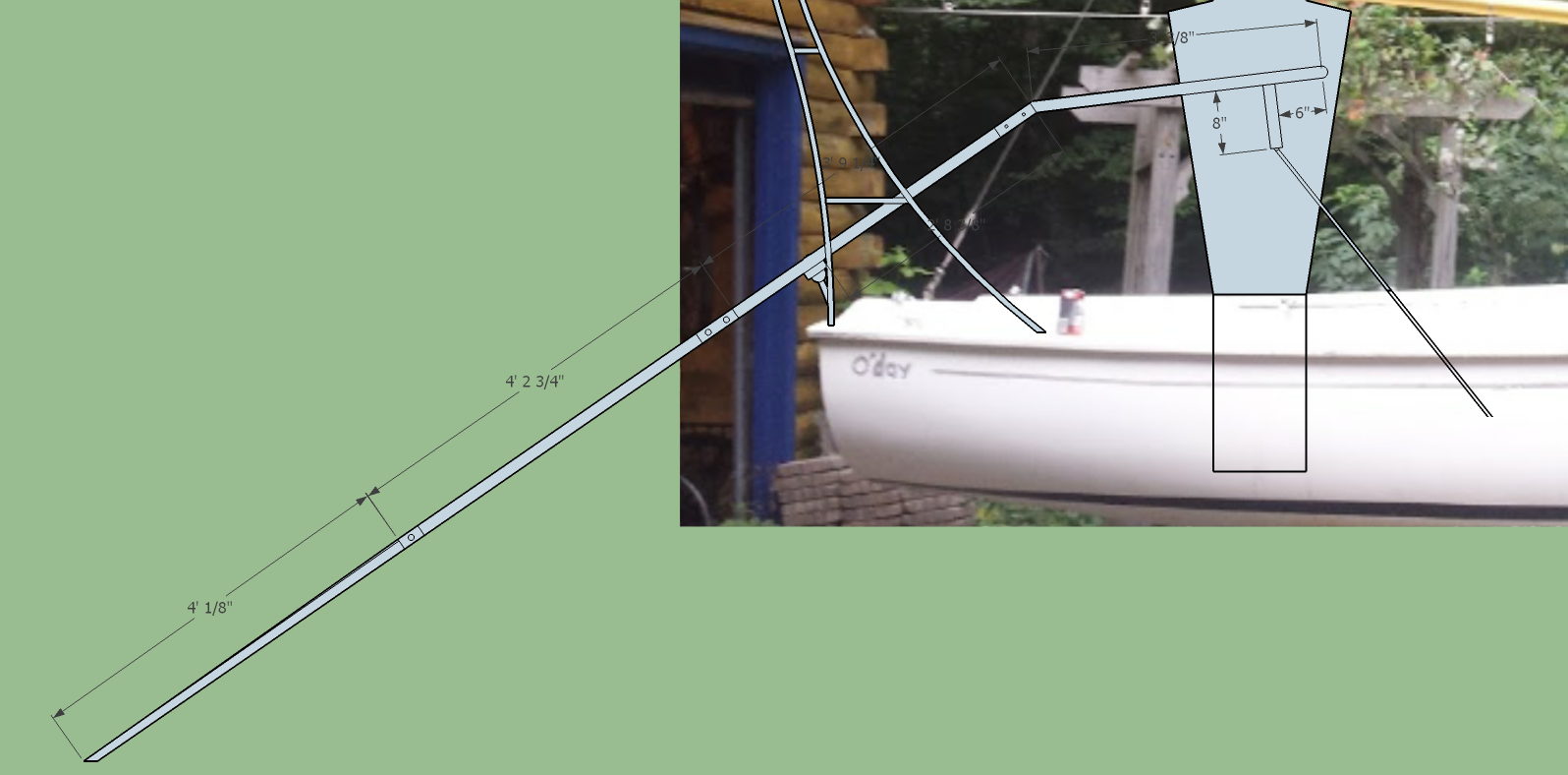

Here is an initial sketchup draft of my yuloh concept for Dragonfly. The pivot ball is attached to my transom solar panel arch (yet to build), maybe 18" inboard. The socket is located about 3' from the bend in the loom. The whole yuloh oar comes apart into about 4' sections, maybe pinned brass pipe in 5-1/2". The blade is around 4'long and I'm thinking 6" - 7" wide. I would make it concave on the top with plenty of camber on the bottom. The loom, I think, will be about 1-1/2" in diameter. All this is just a quick concept drawing laid out on an photo of Dragonfly. She's under snow right now so no measurements are exact.
-Will (Dragonfly)
