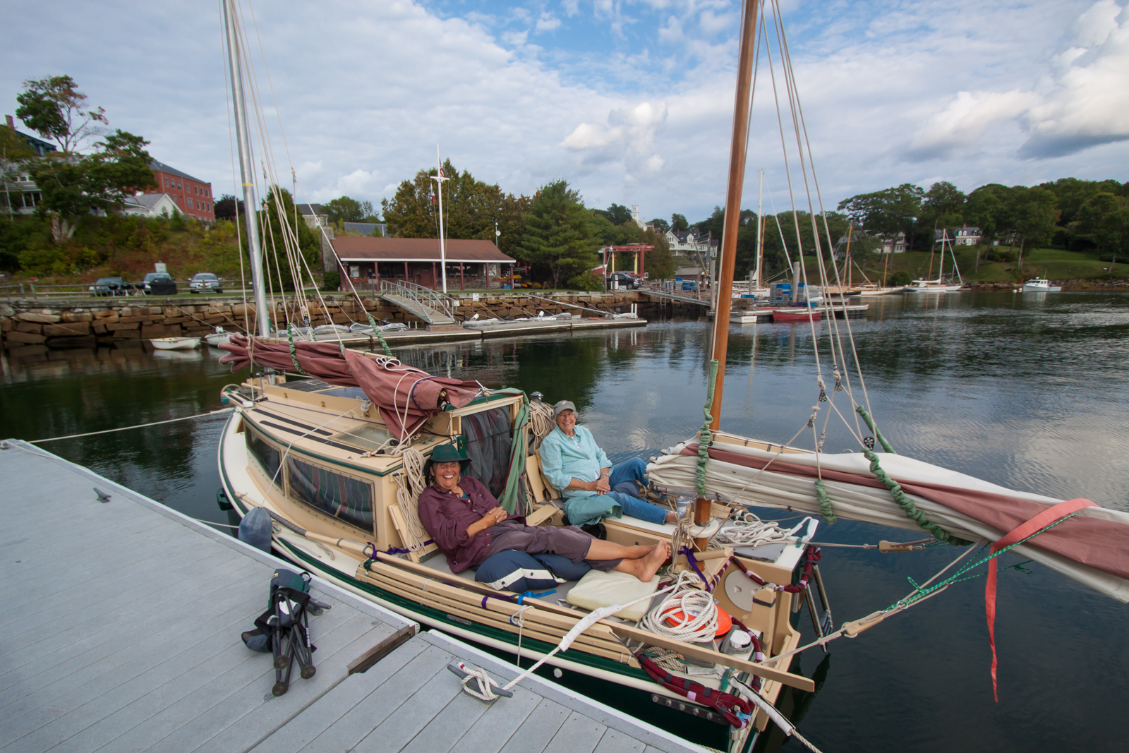

AUKLET came in Rockport Harbor, under sail and yuloh power. I met the owner, Shemaya (port side), at the docks, and had a tour of this Bolger Glass house design. Fantastic boat! Shemaya had it built and customized for her use. AUKLET has an outboard but she's been happier with the yuloh. She also converted to junk rig for ease of reefing and handling.
Here she is having a visit with a relative that came to see her.

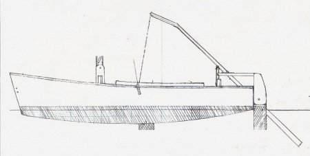

Here's an elevation drawing of a yuloh
The line from tiller end to deck makes it easier to hold the shaft down as the blade digs in and pushes forward against the pivot point.
