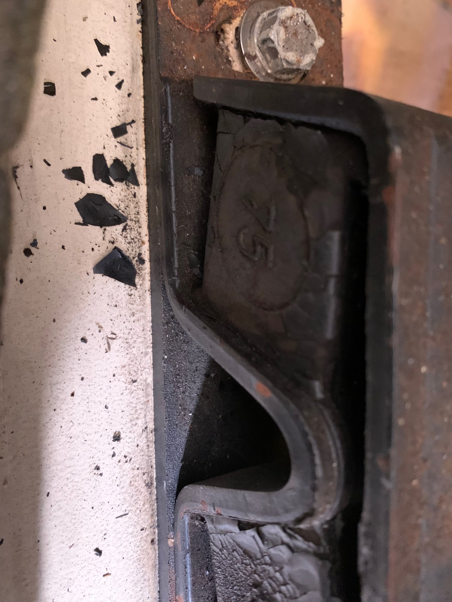

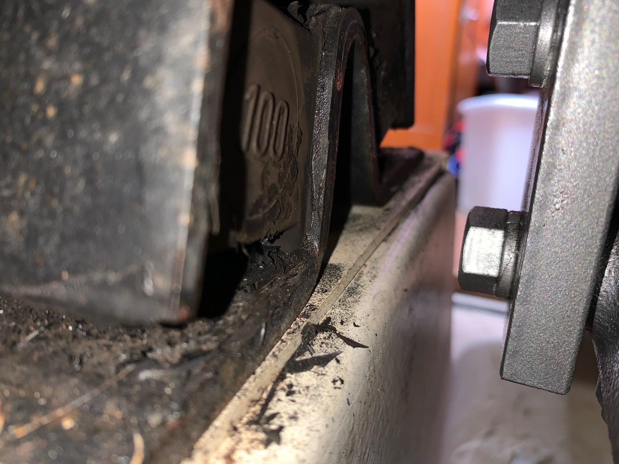

Well, first of all, keep in mind that I've had these same mounts since 2004, so this hasn't been a problem in all that time. The main thing I've always been careful about is not to leave the engine at a slow idle (maybe 700-800? I'm not sure) for long, because it has always had a bad vibration at that speed. I always start in neutral and get it up to 1100-1200 as quickly as possible to warm up, since that's the smoothest near-idle speed.

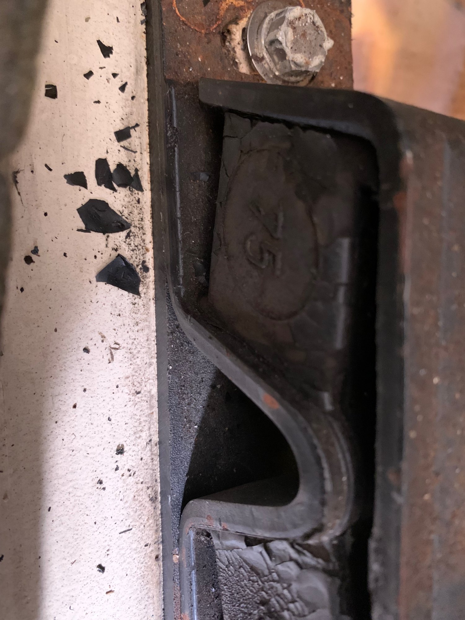

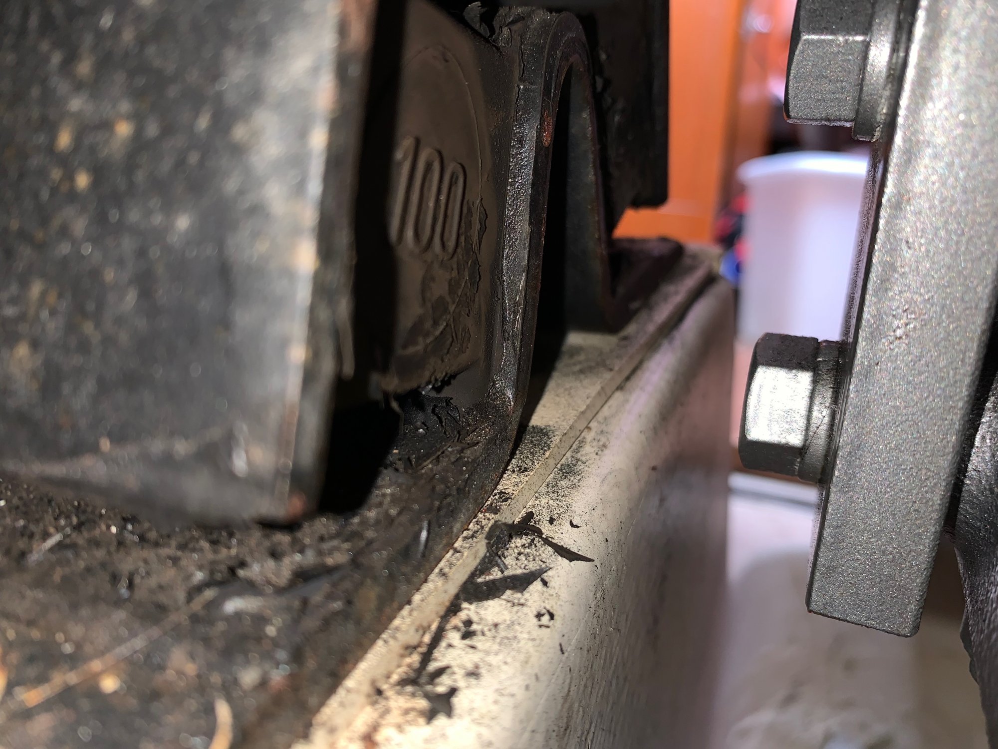

As for what to check for, the numbers (75 or 100) are molded into the rubber. The two 75's were on the outside, so easy to see from the head (starboard) side. The two 100's were stamped facing the engine on the aft cabin (port) side, but I was able to take a picture with my iPhone with the flash turned "on", with a little trial and error. I'm not sure it would have been possible to get my face down there close enough:
The flakes aren't anything bad: apparently someone decided to hit everything (including the rubber) with a coat of black spray paint, which didn't last.
Mine has the same flaking paint. Sure, it looks terrible now, but I'm sure when it was fresh it probably looked "Pretty Dang Spiffy."
Kind of wish they'd just powder coated the steel bits and left the rubber alone. But that's just me.

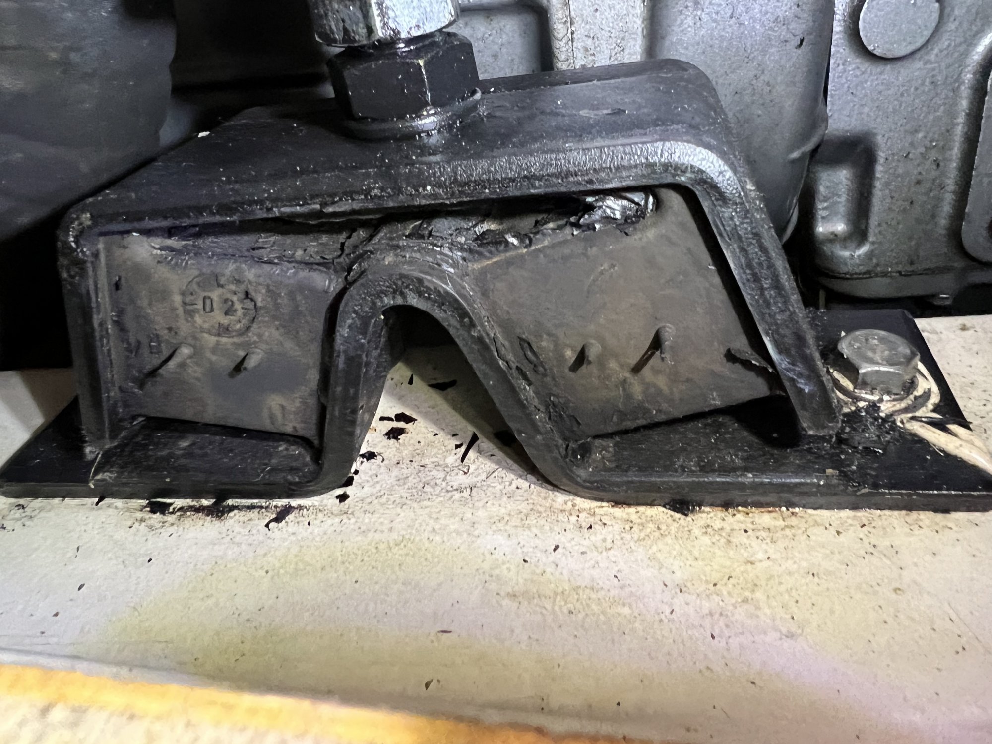

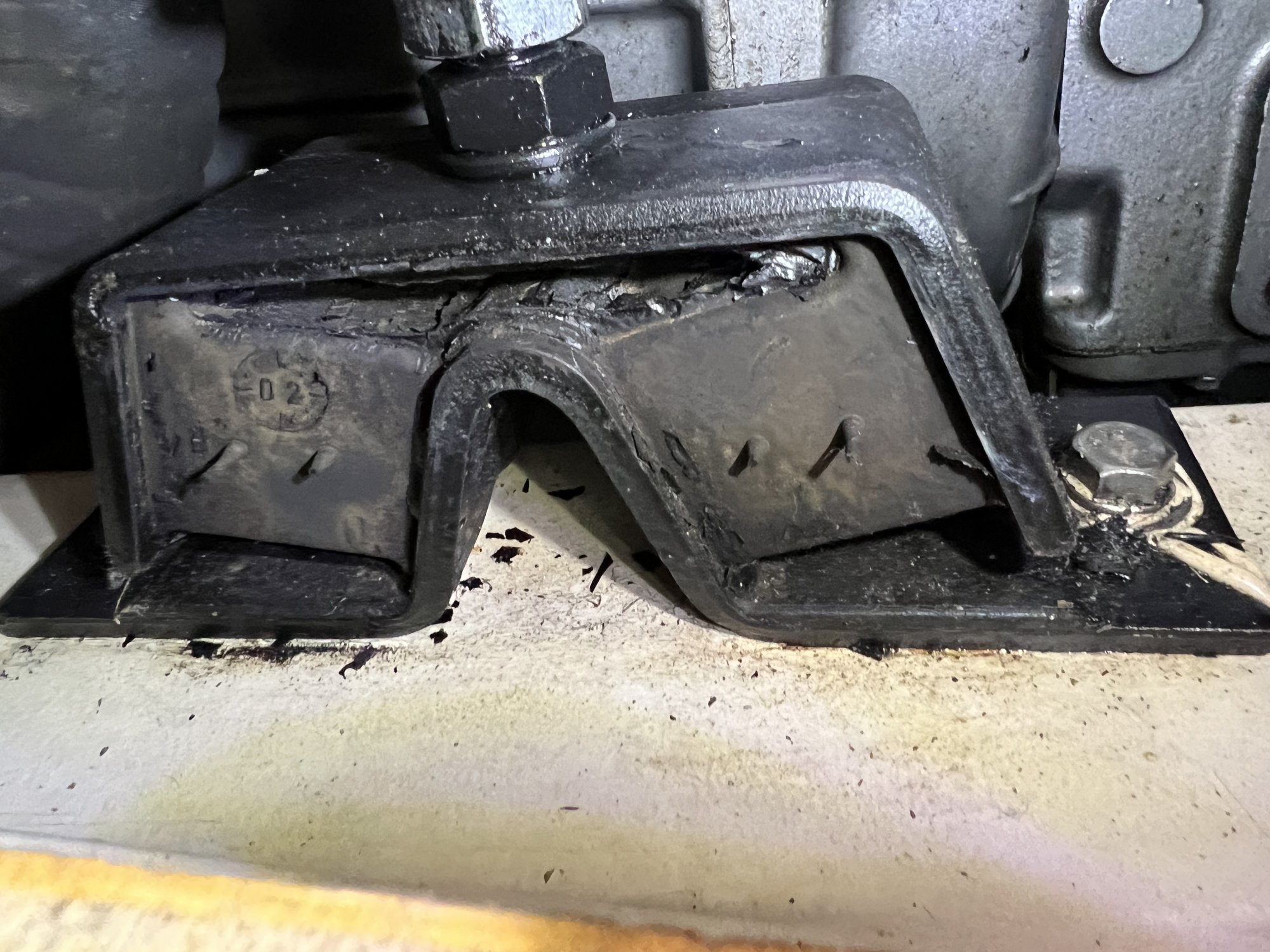

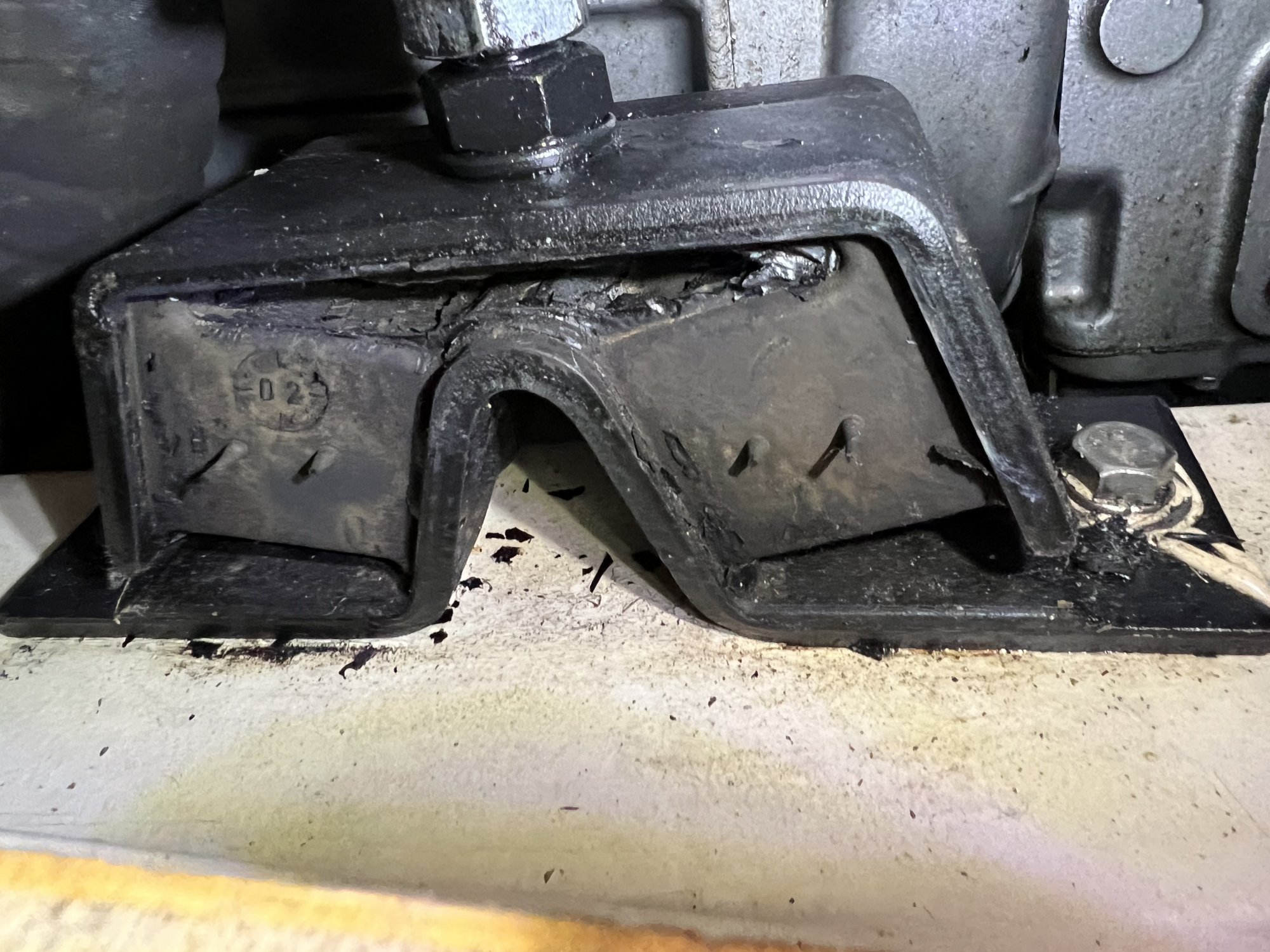

I’m afraid I don’t have much to add here. I was only able to persuade about 2 knots of boat speed with light winds and had to actually start the shaft spinning by hand. I can only report that at 2 knots there was no motion to my engine. I also got a look at my mounts and they seem to be third party mounts and they were all identical.
Jun 25, 2004
646
Hunter 306 Pasadena MD
Sorry: meaning you got 2 knots under sail, and this caused no auto-rotation of the shaft as well as no engine vibration? Well, that's a good thing!
I'm not sure I'd conclude that those mounts are 3rd party. They might well be the same as mine. You've got the same black spray paint on the lower nut there that I had. What year is your boat?
Mar 27, 2021
180
Hunter 306 Lake Pepin
I've got a 2004. The reason I think they might be 3rd party is because they don't have what I assumed were standard markings for "75" or "100." Mine just say "02". But yes, still plenty of flaky paint to go around.
