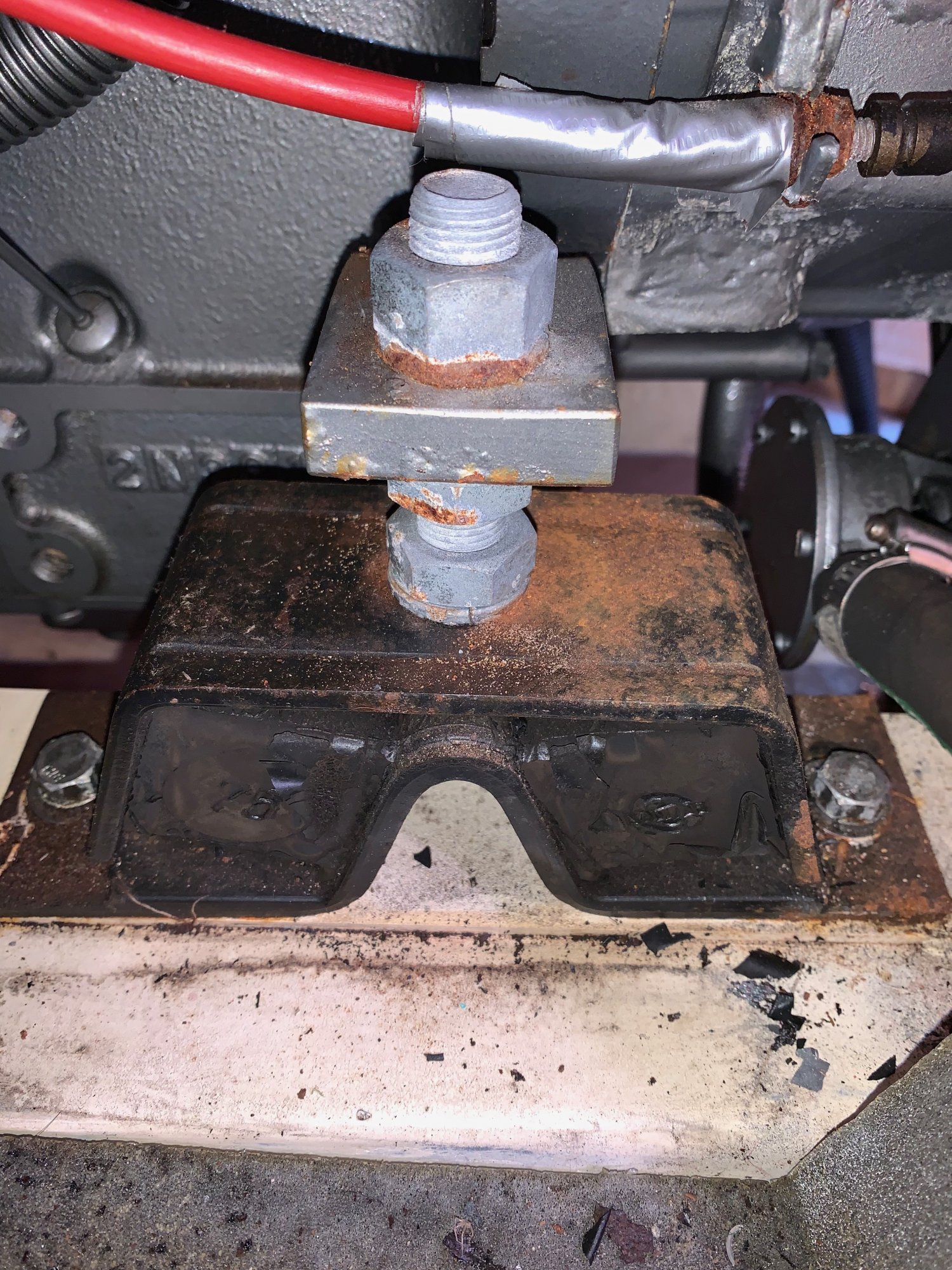

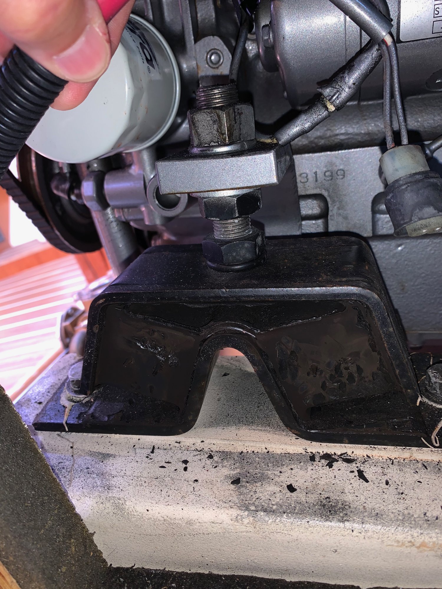

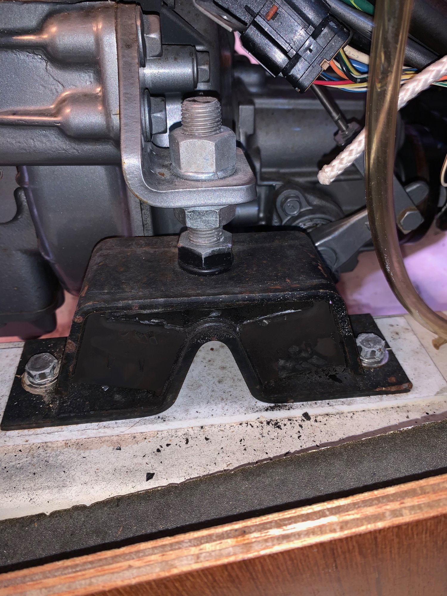

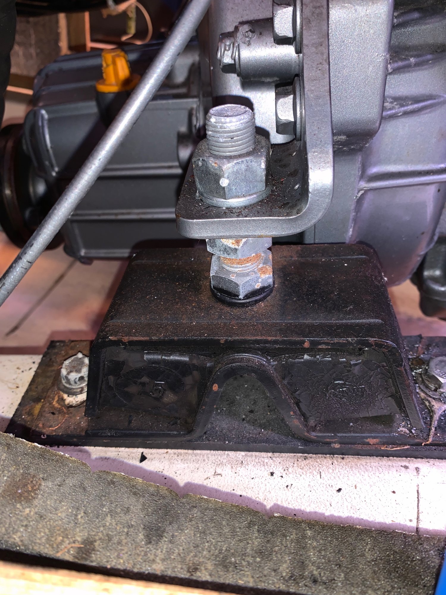

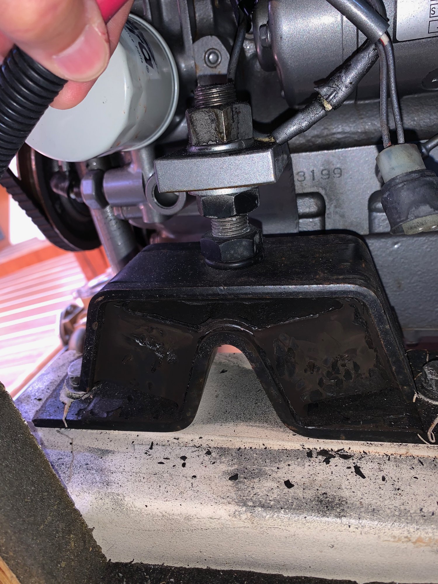

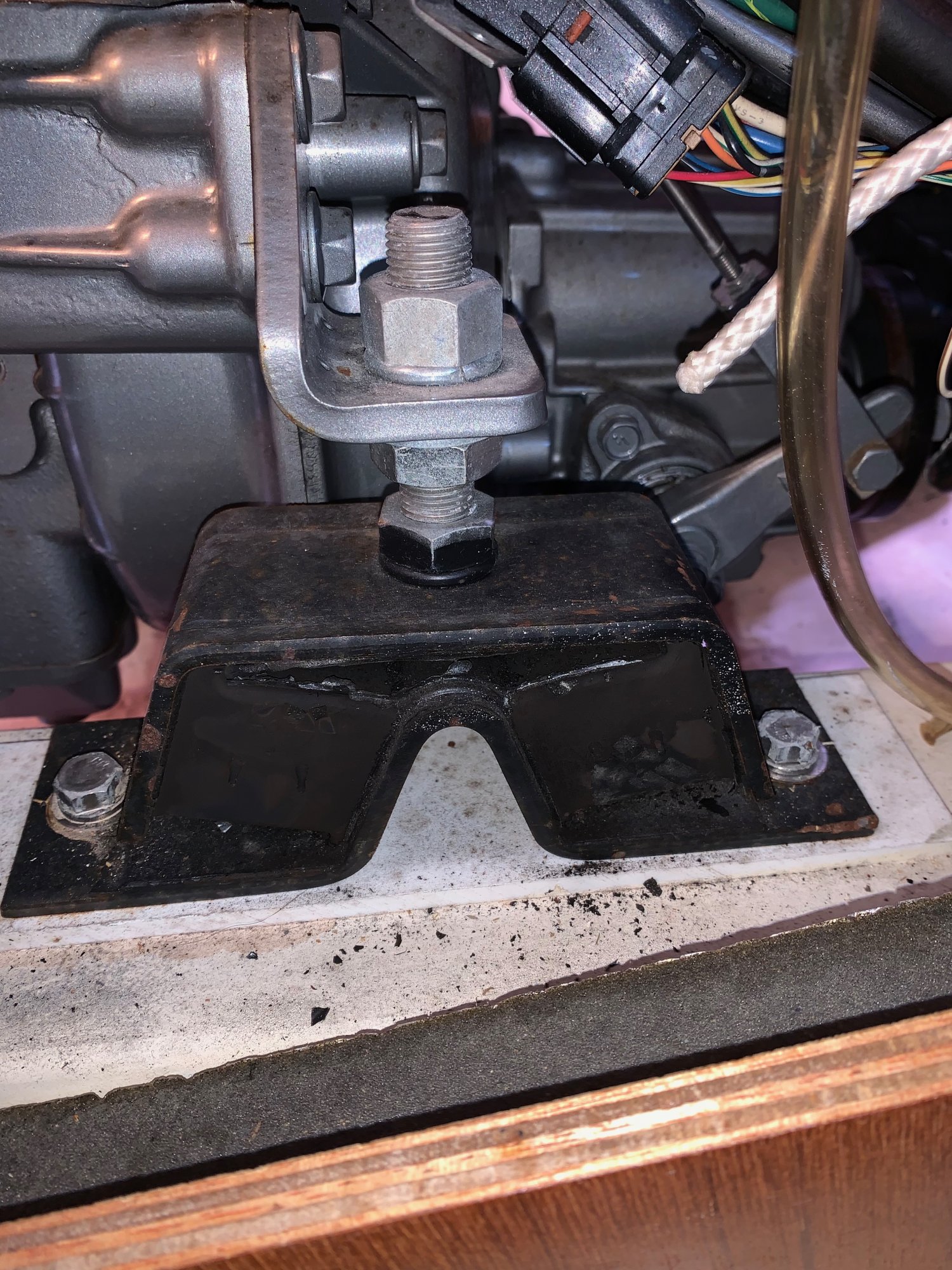

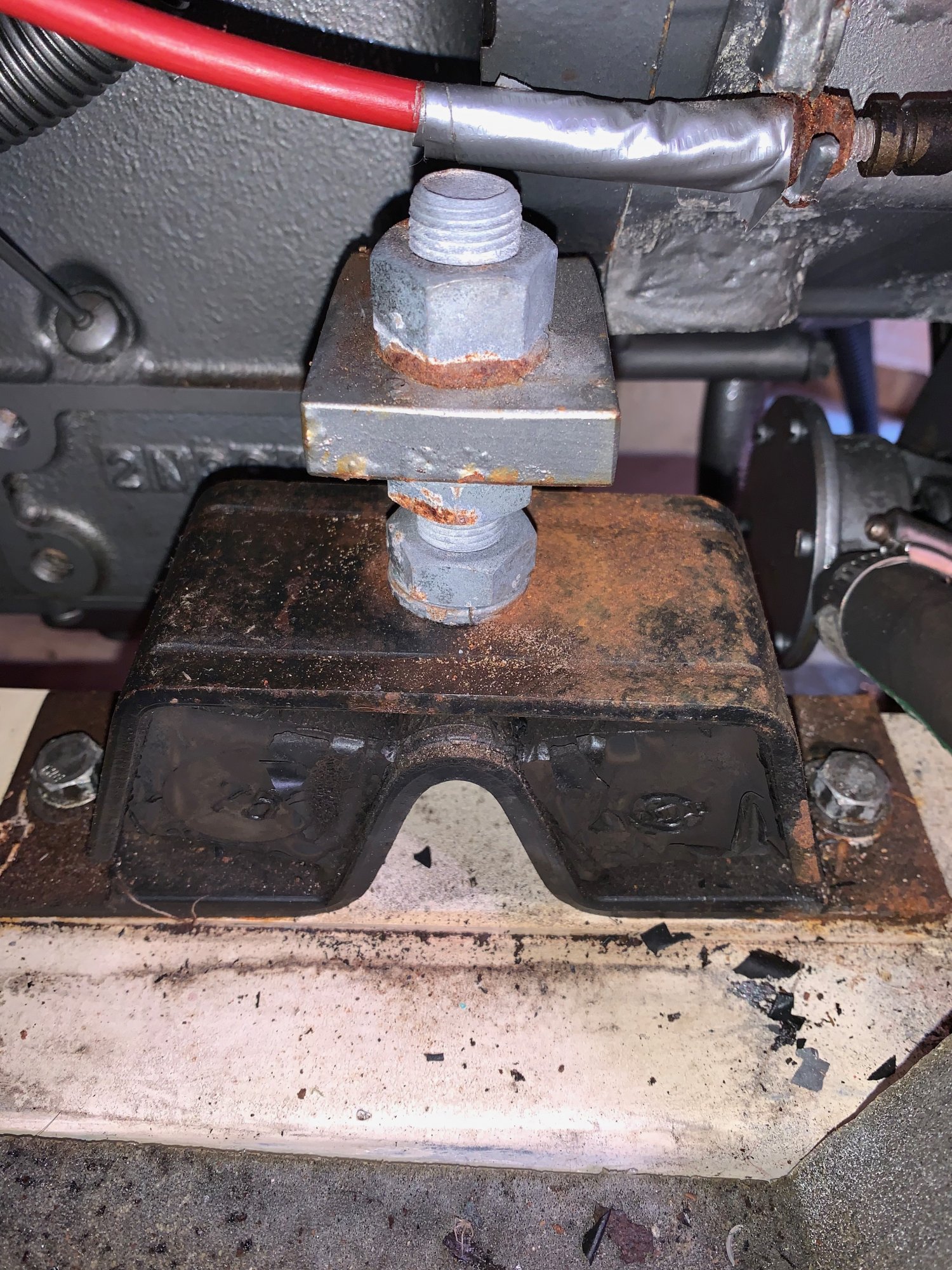

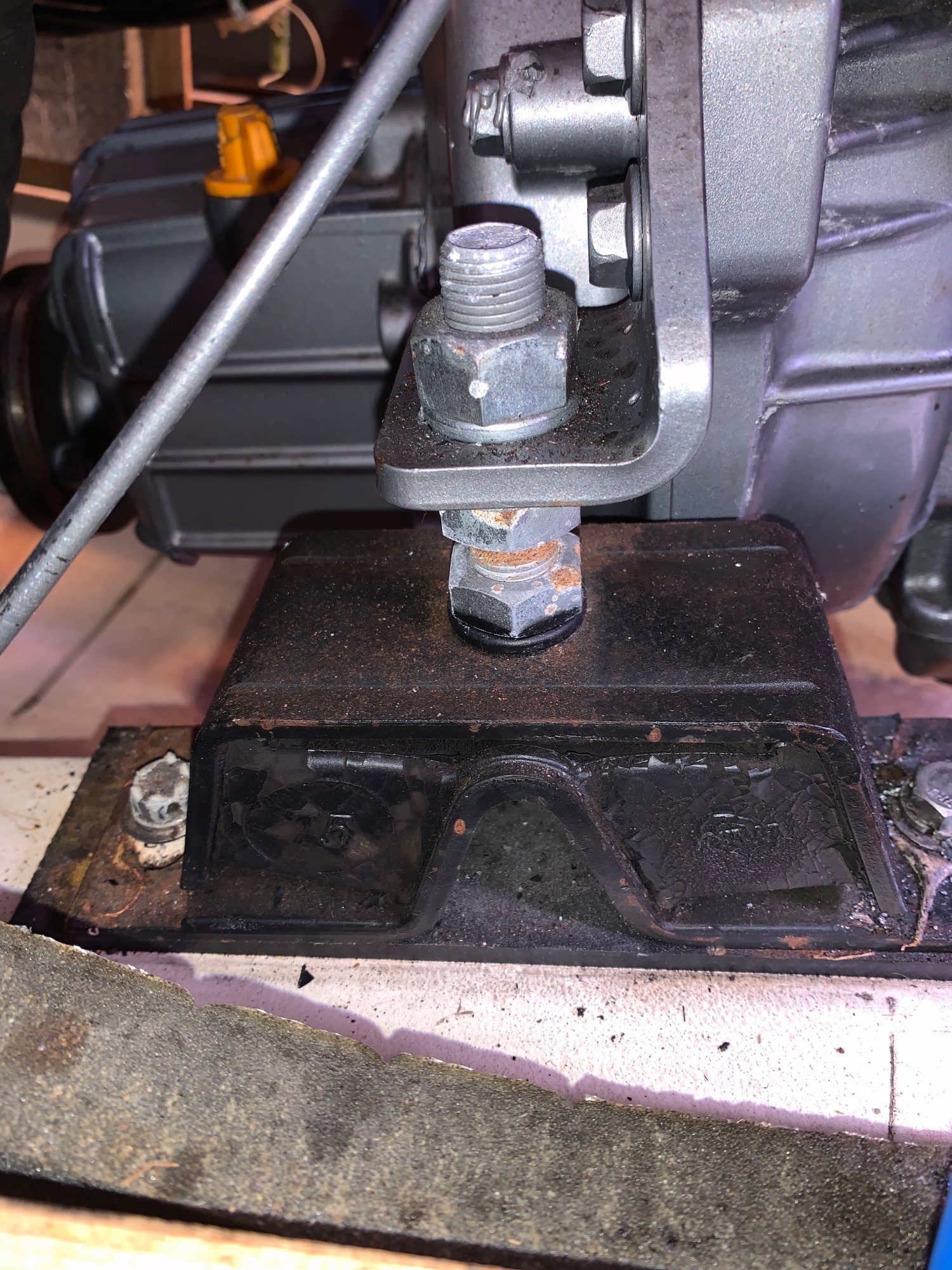

I got back to the boat yesterday, and yes: the Yanmar mounts are size 75 on the starboard side and 100 on the port side. Don't know how I would have figured that out without an iPhone camera. Here are the mounts, port aft, port fwd, stbd. fwd, stbd. aft:
mount_port_fwd.jpeg mount_port_aft.jpeg mount_stbd_fwd.jpeg mount_stbd_aft.jpeg
It's certainly hard to tell from the picture, but they looked fine to the eye. I'm pretty sure the black flakes are just from the fact that someone seems to have spray-painted the mounts black (including the rubber), and it's flaking off. You can see the black paint on some of the nuts. The starboard fwd. mount has a bit of rust, which I think came from a leak in the saltwater cooling above it somewhere, but it's not all that extensive.
So I ran the engine at the usual "low-vibration" idle speed (1200) in neutral. Looked pretty normal. Put it in forward at 1200 in the slip: the vibration seemed significant, but I'm really not sure I've ever observed it at this RPM in gear before (port side, forward):
I took a video of the other side and of the top, but they seem to be too large to upload. But they're similar.
So at 1200 in forward, there was significant vibration on the forward side of the engine, although perhaps not as much as I had remembered. In reverse at 1200, no vibration to speak of. Took the boat out, and again the engine looked smooth at 2800 to 3200 RPM, which is my normal cruising range. So I think my conclusion is that I've just really never looked at it closely enough at 1200 RPM except when the engine is in neutral at the dock (when the vibration is pretty minimal). So the vibration I noticed on the trip was at 1200 in neutral with the prop freewheeling b/c of forward motion from sailing and with the engine off with the prop freewheeling b/c of forward motion from sailing. I had no vibration in reverse, or at normal cruising RPMs. I think I'll keep a watch on it, maybe align the engine (for the first time) at the end of the season, and aim to replace the engine mounts some time in the next year or two. (Assuming I have no further problems.)

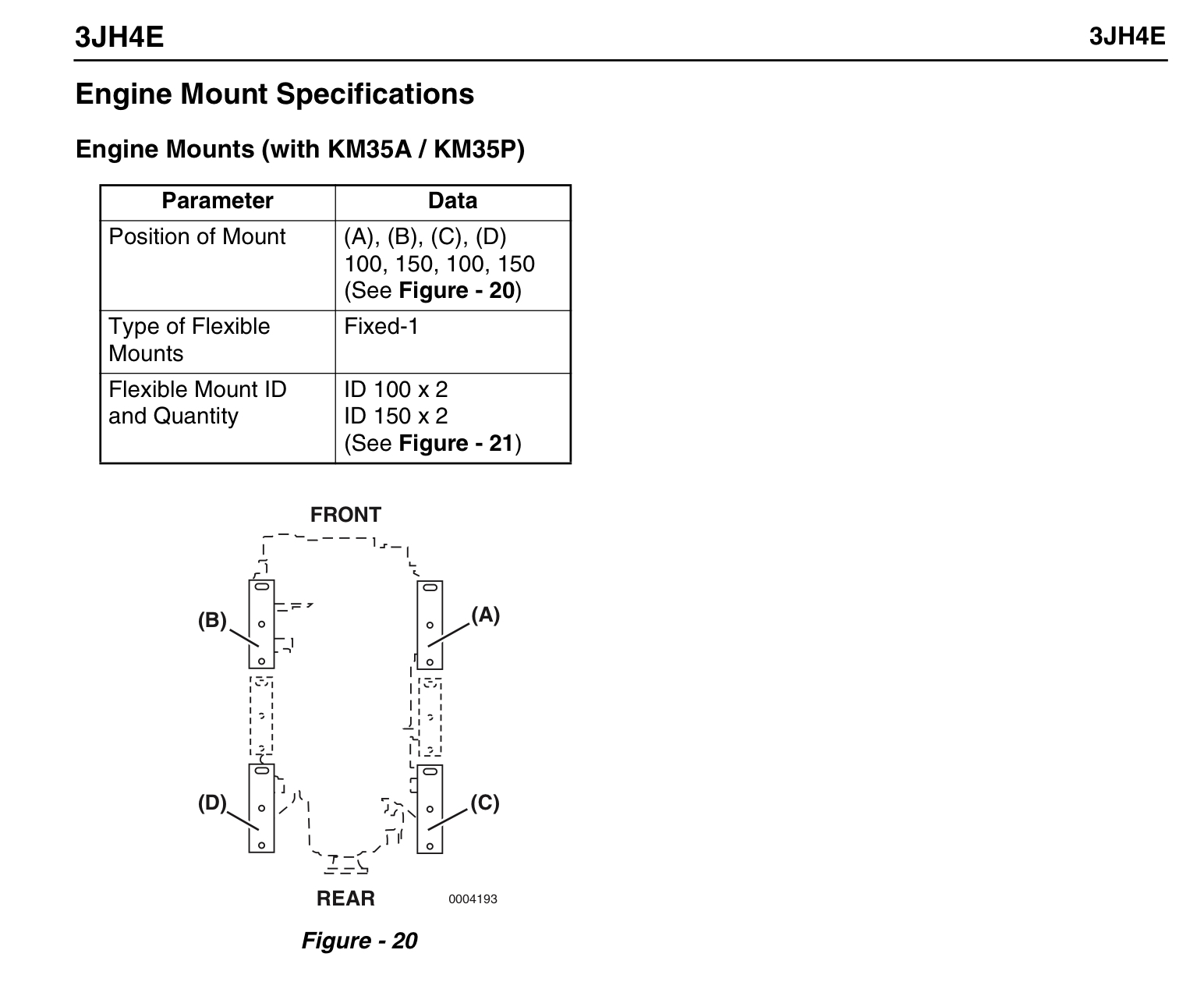

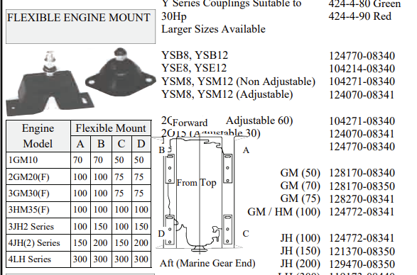

Quick note: The parts book shows the two front mounts to be "100" and the two aft mounts to be "75" . The 100's to support the weight of the engine block and the lesser rated ones to support the lighter transmission.
I believe you, but I've also read elsewhere that the different sizes go on different sides of the engine, which is how mine were installed by Hunter. Sounds like a topic for another couple of pages of debate! :eek:

As far as fore/aft vs. port/starboard differentiation in motor mounts: all I can say is that Hunter did mine with the 100's on the port side and the 75's on starboard. Since I've never really had a problem (the recent "problem" is looking more and more like it's either me just noticing something I never noticed before, and/or perhaps I should try to realign the motor), if and when I do replace them, I'd stick with the way they were installed by Hunter.
