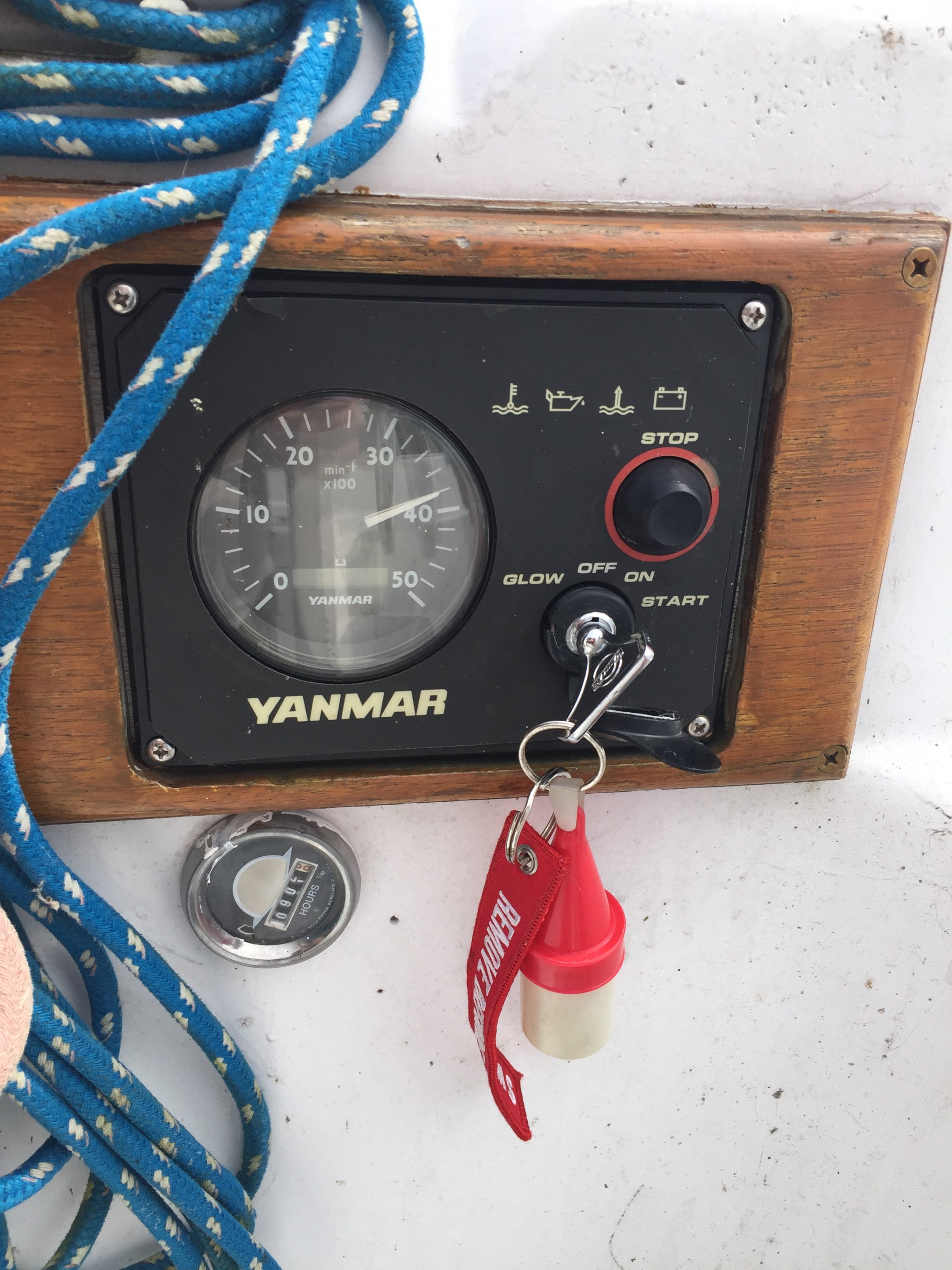

I am the new owner of a 1980 Hunter Cherubini 30 ft with a fairly new Yanmar engine. Unfortunately the engine control panel is not as new and being and engineer, I'd like to know a little bit more about my engine while it is running. Has anyone here had experience with swapping out an old panel for a new model? I'm also considering adding additional electronics to the boat and wondered if there is a way to link my engine monitoring to a newer display for Wind speed, direction, depth, speed through water, GPS etc.. I'm considering Raymarine or Lowrance but interested in hear the experience of seasoned boat owners.

On your pic...
Were you running @ almost 4000 RPM? What model Yanmar did you install?

The previous owner installed a 2YM15. It runs smooth and pushes the boat well. I can't waterski but it doesn't feel like it's ever struggling.

Not Yanmar but I installed a Noland Engineering RS11 and now have water temp, oil pressure, rpm, voltage, fuel level all on my chart plotter or mfd. I left the original water temp/ idiot light OP in place as backup.
MJ, I have the 3YM 20 in my '77 h30. The engine should run at 3600 rpms while under load. You don't want to do this but for a minute or so after warmup. Normal cruising rpm is about 80% of WOT or approx. 3000 rpm. Don't idle for very long and before shutdown run the rpms to max a couple of times to blow out any carbon deposits. Did the boat come with the engine manual? You're going to love sailing this boat. Good luck with it.
MJ, I was going thru that thread again and the panel you have is the original panel for the YM models. The upgrade is $$$. Better to install after market gauges.

Yes it is. LeslieTroyer suggested a unit from Noland Engineering RS11 that would convert the engine sensor signals to CANBUS which can be displayed on GPS / Chartplotters with NMEA 2000 capability. It's under $400 so that is more in my range, but how much will I really be using this on a SAILBOAT?

Sep 20, 2006
2,953
Do you have room to replace the wooden panel with a larger one and add oil, temp and fuel maybe? Not sure you need much else? I see you have separate hourmeter. The VDO tach's are notorious for the LCD display to stop working. The instrument still has the hours, just not showing. There's many that have tried various fixes, from cleaning contacts to replace the lcd strip, all with varying success. Search this forum and Google for VDO or Yanmar hour.
