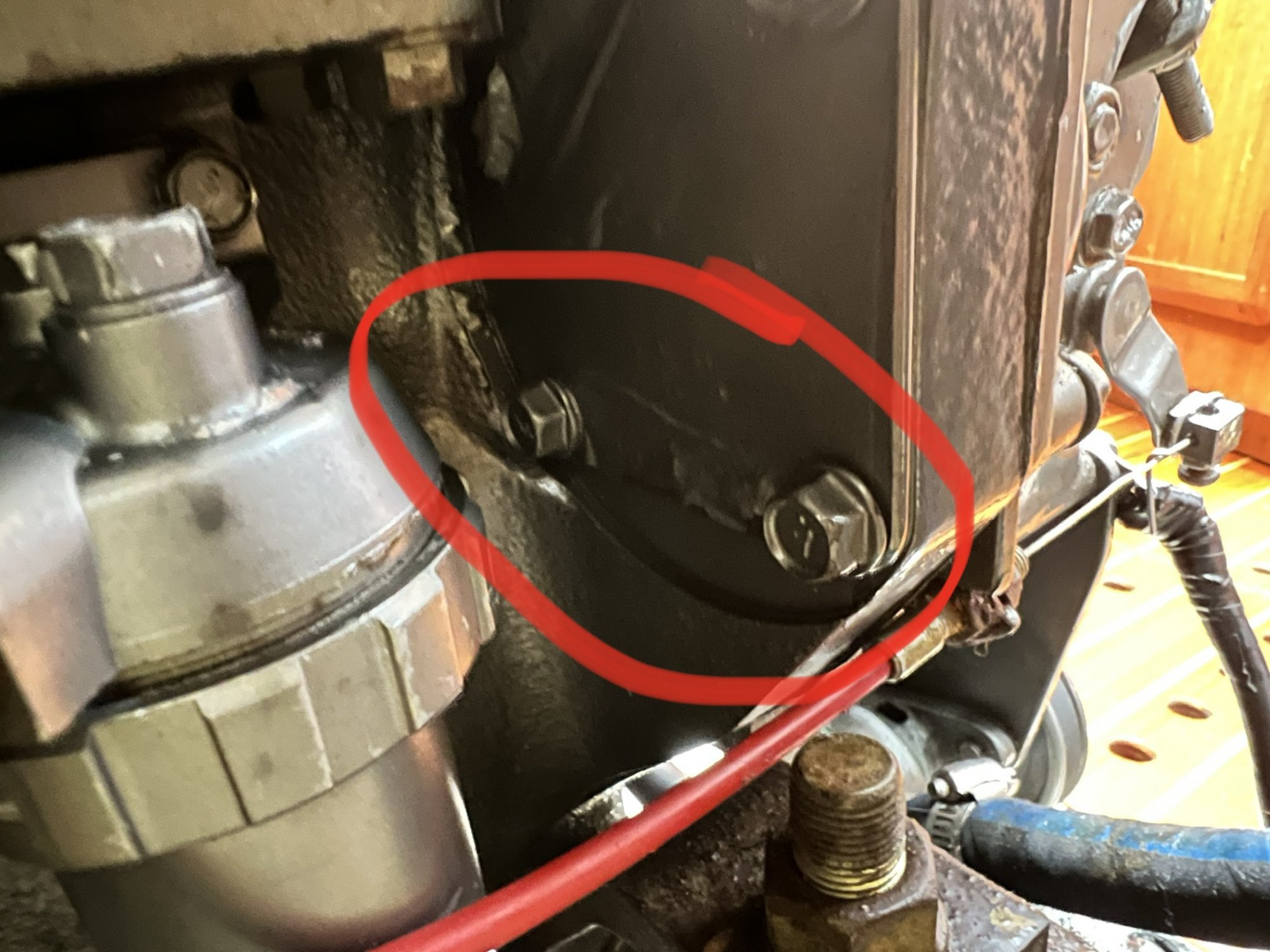

Attached is what I referred to. It appears not to be part of the fuel system, so I’m ruling it out as a source. There seems to be some leakage from the filter itself, though it is on tighter than before I changed it. When I removed the secondary filter, there was a thicker gauge o-ring packing than what was provided with the new filter, which seems odd. I assume a thicker o ring may have been used to better seal the filter housing.
Is there any reason NOT to run the engine at 3200 for 10 hours to try reset the rings? Fuel and gear oil did not leak prior to running at open throttle, and I’m wondering if it may have somehow caused the leaks? I thought the fuel filter may have been clogged and changed it for that reason (last filter change of both primary and secondary was 300 hours prior), but the leak persists.

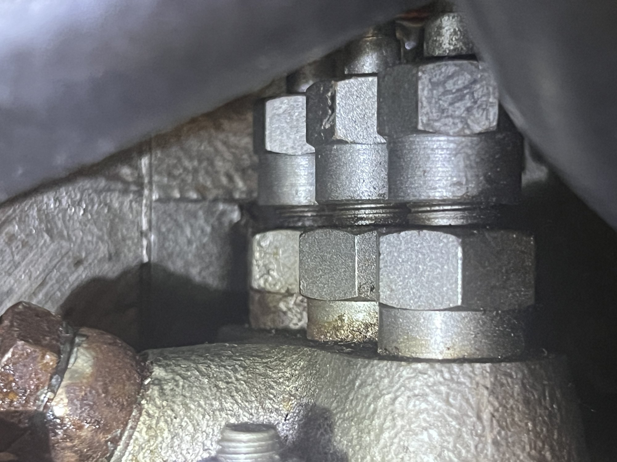

I’ve found what seems to be a slight amount of diesel on the outside of #1 and possibly #2 output on the injector pump. All the other connection points are clean. Could I just tighten these nuts?
The leak started after I ran the engine hot for two 30 minute sessions (3200rpm), before I changed the secondary filter.

Reviving this thread regarding fuel in the engine compartment. After changing the primary filter and cleaning up the engine as well as I could, there appears to be no more fuel leaking as of the past 15 hours of use. No signs of drops anywhere. It remains puzzling, as there were no leaks prior to running the engine at 3200 in an attempt to “re-seat” the piston rings and eliminate smoke in the exhaust. I’m not sure at this point if I should make another attempt to re-seat them by running at high rpms for 10 hours, or if that might cause the leaky fuel issue again.
I did notice when bleeding the injector lines that I could not seem to get fuel to come out of one of the lines (I believe it was #3, but I would have to confirm). The other 2 bled fine, and the engine ran fine when started up. I checked the compression valves on each cylinder, and each one affected the engine, indicating they were all getting fuel. I thought nothing further of it at the time.
Could it be that that line was clogged somehow, which was causing leaking downstream of the injector pump? If so, it seems that may have been the cause of the leak.
