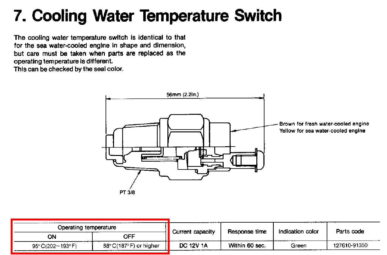

The spec for the coolant overheat switch is that it turns on at 217 - 228 F and off at 205 F ("or Higher" ) A good switch would probably not work if immersed in boiling water.. you could use a heat gun or a carefully applied flame.. then check the tip temp with an IR thermometer.
EDIT: previous numbers are from the shop manual, from the parts book the spec is 203 F and 190 F Somewhere around there then... I dunno
Likes: skunther
Your second set of figures are a little closer to my 2002 shop manual.

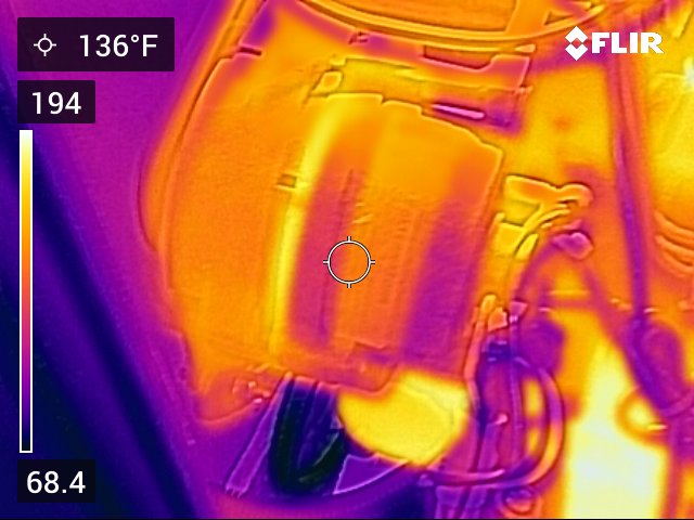

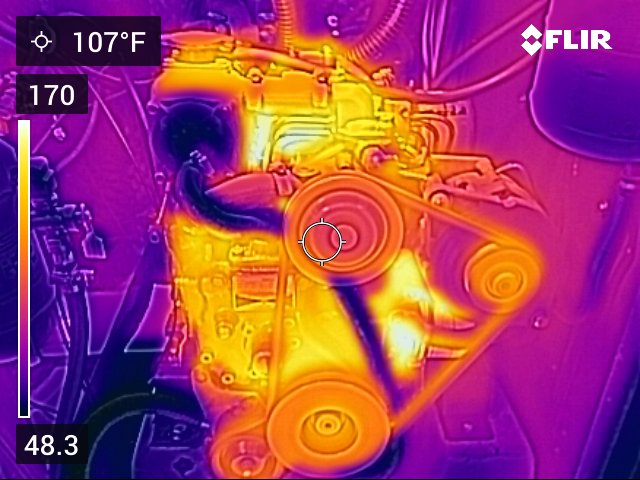

Does anyone know where I should shoot an IR temp gun on the engine to check actual operating temp?
Jan 4, 2006
7,862

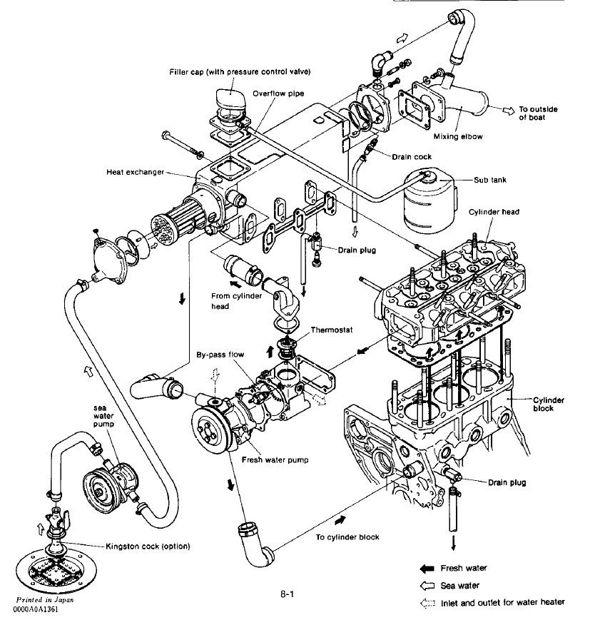

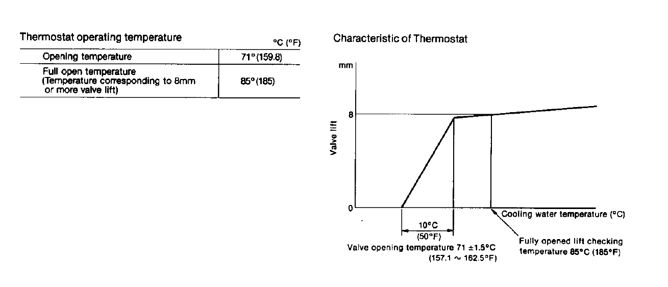

Once the engine is up to temp. you want to shoot the top of the thermostat housing as this is receiving water which has absorbed heat from the block as shown:
This is the hottest cooling water in the system. Look for 160 to 185 deg. F depending on the engine load:
Likes: skunther

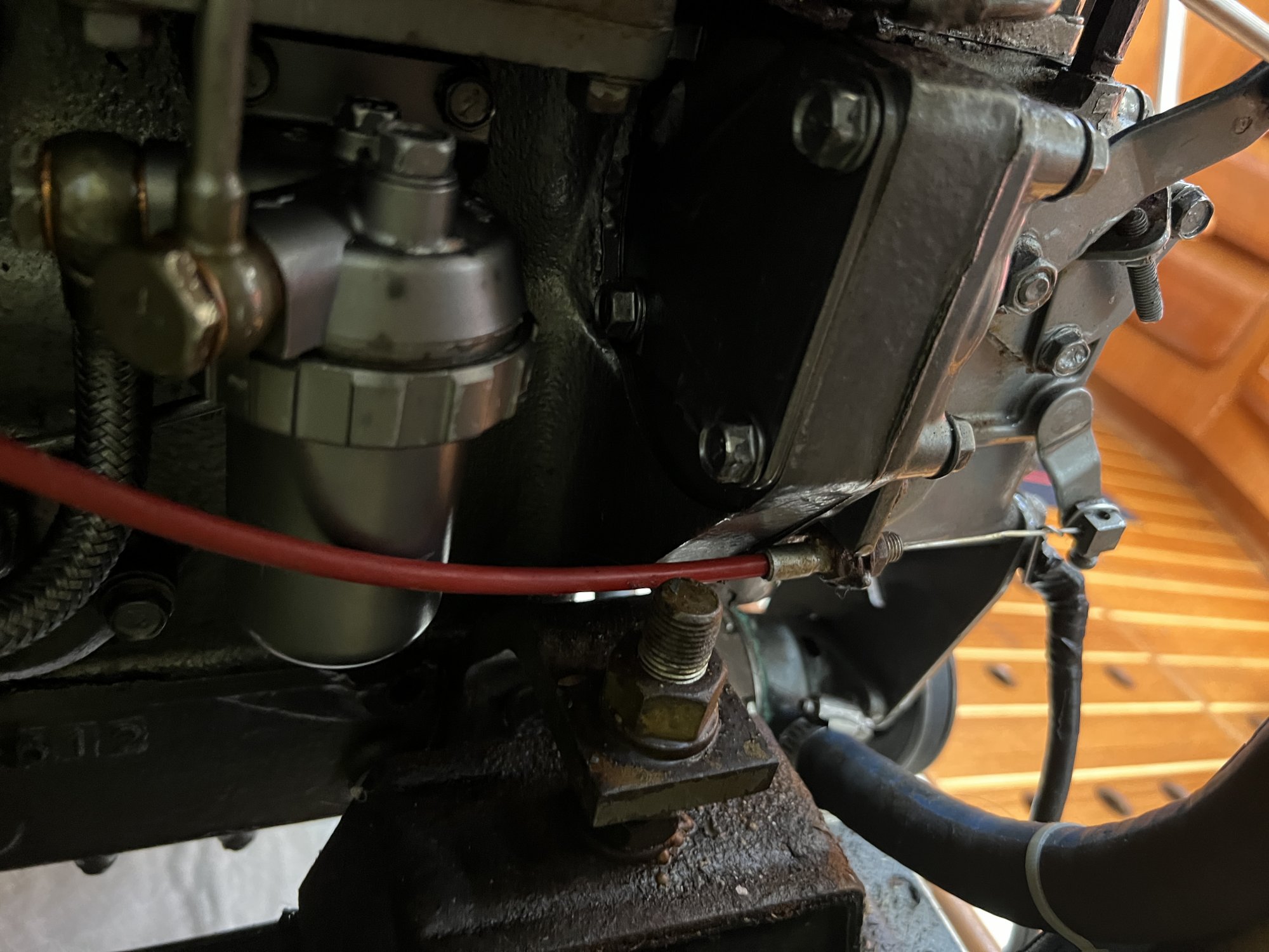

UPDATE:

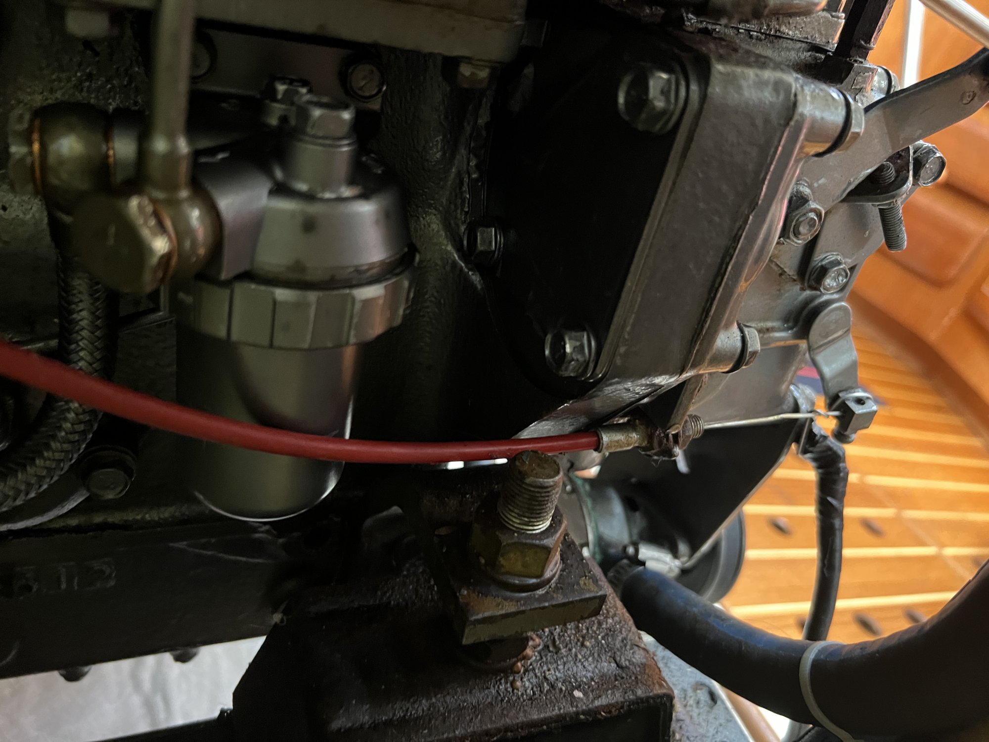

With intention of doing the 10 hour WOT piston ring “re-set”, I’ve done two sessions of 30 minutes each of 3200 rpm under load, and am now noticing some diesel leaking from the forward starboard engine mount (it seems to be coming from a plate between (but not inline with) the secondary filter and IP (see attached pic).
I’m also now noticing some gear fluid leaking from what seems to be the joint between the transmission and engine block, though I have been unable so far to definitively identify the source.
Any thoughts on this? It’s resulting in a new unburnt diesel smell in the cabin every time we motor, which isn’t great for the wife and kids…
Jan 7, 2011
6,014
Oday 322 East Chicago, IN
Well, we know it is NOT leaking FROM the engine mount. But what is leaking is hard to tell from the photo.
You might try putting some bits of toilet paper around the banjo fittings, and any where else you suspect it could be leaking, and see what gets wet. You may have to run the engine to get it to leak.
Greg.
Jan 4, 2006
7,862
Any way you can insert an arrow to show where the leak is from ? I can't make anything form the photo and I know you "have to be there" when dealing with fuel leaks as they are near impossible to see.
