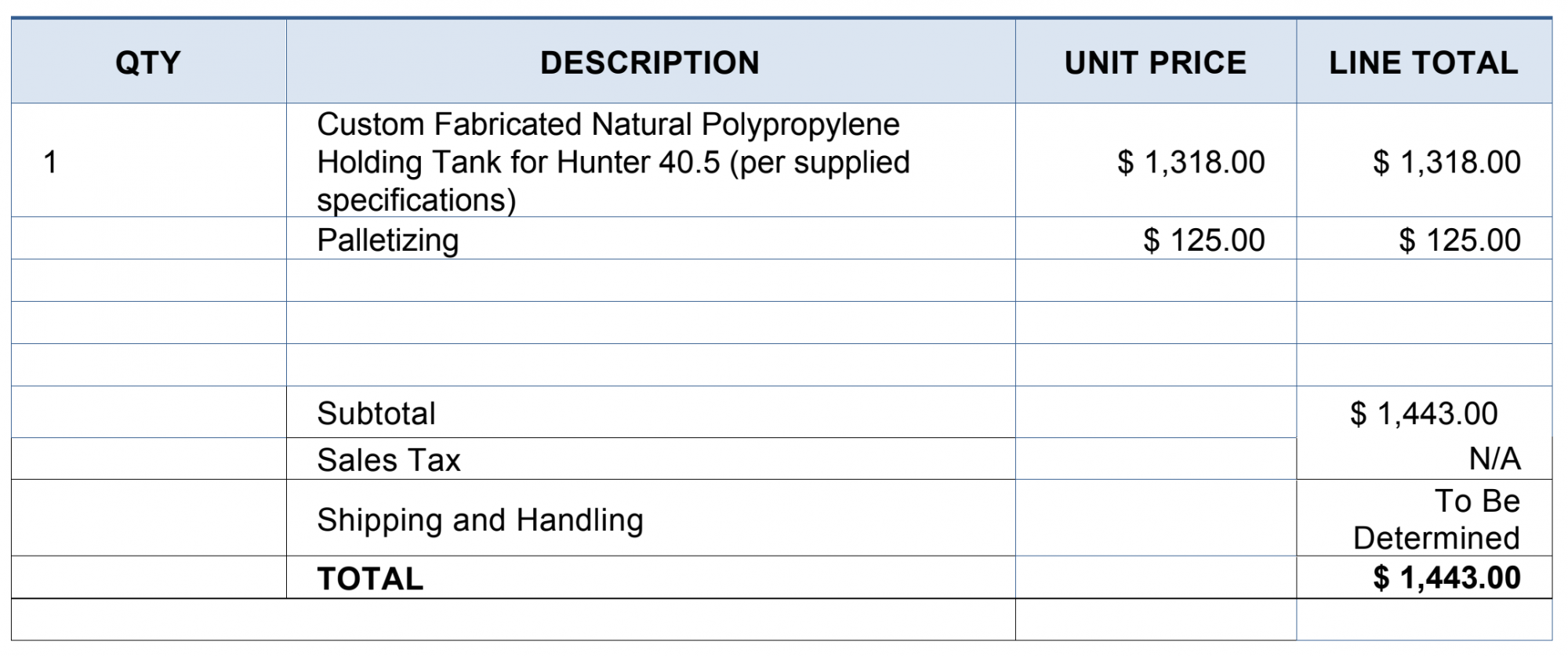

It wasn't a $300 decision.
The Hunter forum all recommended this manufacturer, MMM:
Plus CA sales tax plus $500 shipping > $2k.
This tank is already quite small so smaller and a less optimal shape was not worth any effort from my point of view. I looked through maybe a hundred or so designs and nothing looked remotely workable. No Legend 40.5 owners use stock tanks.
As for the other guys, it's bit weird - people think I just make shit up and then they respond with personal insults? Must be the election season... :what: I guess for some people, group think and ego (let alone incomplete analysis) is more important than success. My counterpoints weren't answered other than by insult. Ok.

From a related thread by a different 40.5 owner:
Same incorrect information as before. Does anyone read the thread? There is no "drop in" replacement tank from Ronco. Triple M does make a custom tank but as per my post can't seem to follow directions or their own specifications. They absolutely hate making them! They are not inexpensive! If you want a price call for a quote as they rapidly change. It is relatively easy to pull a new waste line for the forward head. It works fine despite the long line. If you want to put in a human kitty litter box in the forward head remember that it has to be vented (cutting a hole in the deck) and needs a power supply for the fan.
If ya'll can find a $300 tank for us then hundreds of people would have been in the past and would be in the future very grateful - so please let the forum know! I can tell you the reason no one has gone with a stock tank is for the same reason as myself. They are pumping out constantly and intuitively or explicitly know that a smaller tank is not viable. It's not a question of if something could 'fit' - it's a question of how much reduction of functionality (holding capacity) would be acceptable.
