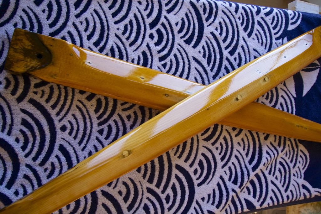

Here's a pair of 50 some year old spruce spreaders. Battle scarred, old screw holes plugged but still sound. No need to re-invent the wheel, just check what they did on old boats. More than a century of experience is available.

Yes it is. Ironically, varnish which requires a bit more maintenance, is a better preservative in that you can see problems long before rot forms.
These old spreaders simply have a notch cut in the ends. A band of thin bronze lines the ends as well as the notch where the wire passes through.

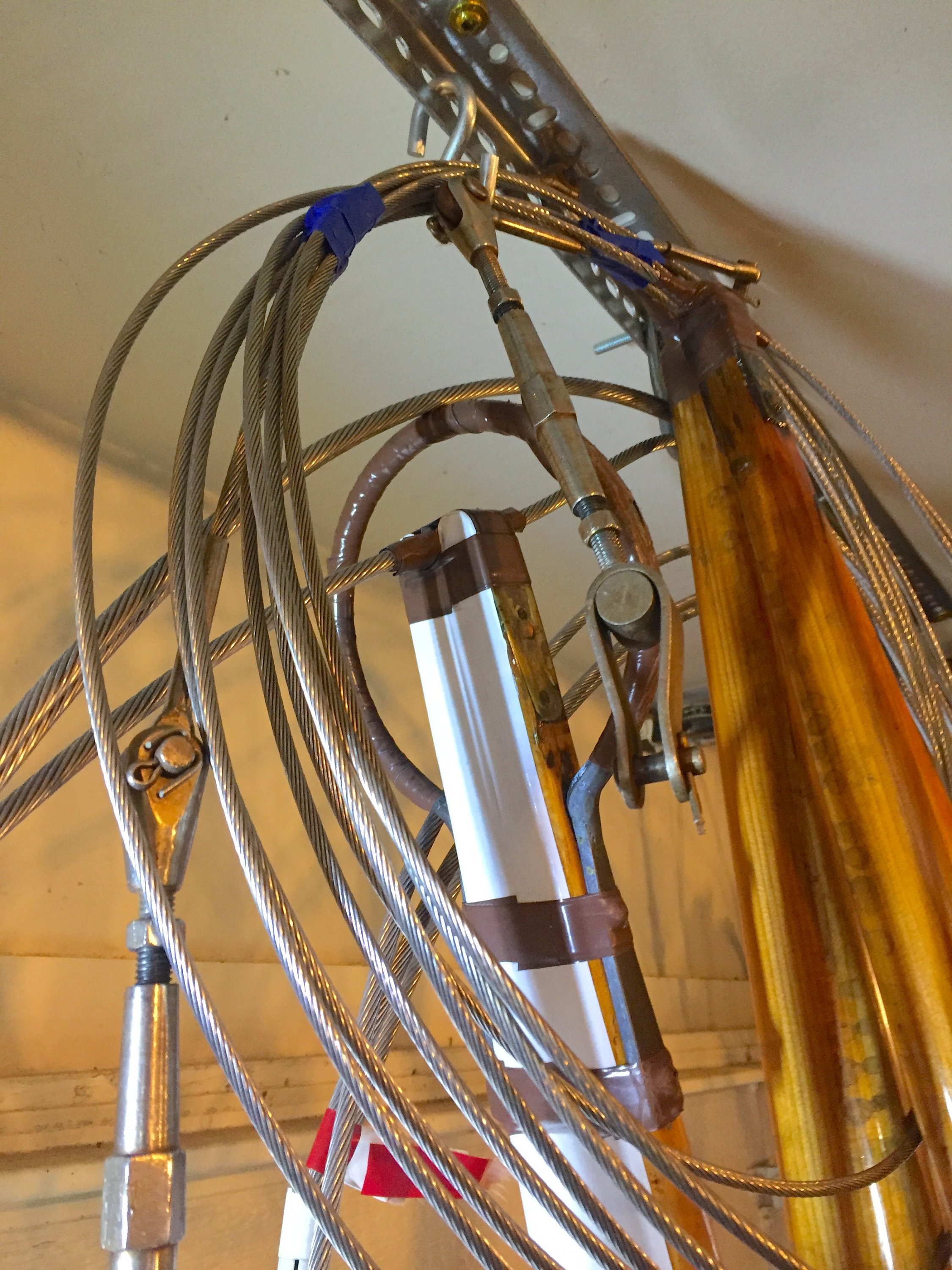

Easy to do Jon, with them hanging in my shop!
A phone pic but I think you can see the full span bronze rivet that goes from strap to strap. This prevents splitting. A few small screws are visible on the straps. The rigging wire(invisible under tape) captures the wire and runs through a hole in the wooden spreader. You can see the mizzen spreaders (just behind), were built the same.
A curious part on my spreaders are the bronze hoops you see in place of leather boots. The hoops are also through bolted, once to further prevent splitting. I've never seen them on another boat nor has the owner of the wooden boat shop in my harbor. I keep the hoops taped to lessen chafe on the genoa during tacking.
The brown rigging tape, while visible on the white (only seagulls see that), nearly disappears from below.
