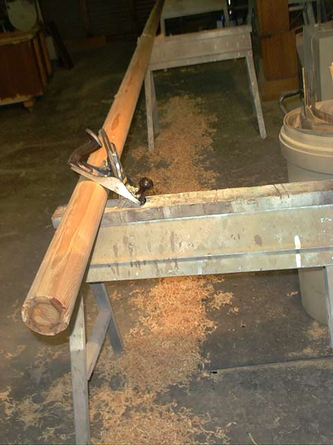

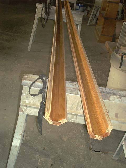

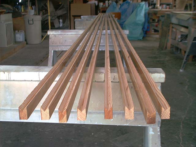

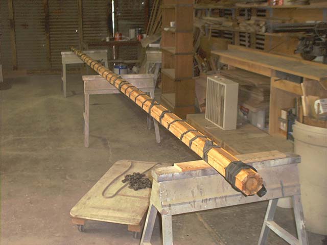

A few shots of that mast under construction. All done on table saw, except for rounding which was a hand plane.
first shows all stave cut, second shows halves, apart for internal blocking. Third shows all clamped together- bicycle inner tubes spiral wrapped. Las shows being rounded
