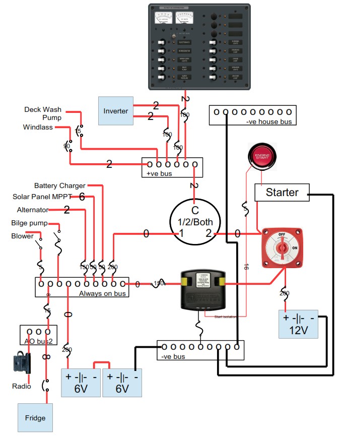

I set up an always on bus bar for things like the bilge pump, fridge etc. I wired the solar panel controller and battery charger here so I can shut off the main battery switch and still allow charging from all sources. I then use an ACR to combine the chargers with the starter battery (bank 2). I have the 1/2/Both switch set up so I can combine the banks if needed, for instance if the starter battery is dead. I normally operate with the switch set to 1.

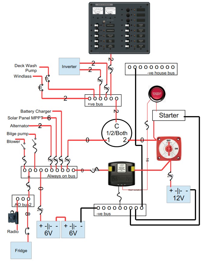

Hey Darcy, what are those numbers on your diagram? Wire size?
Yes, the numbers in line with the wires are gauge size. I followed this diagram when wiring the boat and it was handy to have everything in one place.

I am wondering what is the purpose of the other switch between the ½/both switch and the ACR?
I like this diagram, just wondering about that switch, is it the ignition switch?
The 1/2/Both switch is to allow starting the motor from the house bank. In theory I could run the house circuits off the starting battery if I disconnect the house bank as well. I only used a 1/2/Both switch because it was already there. I would probably go with separate on/off switches if I was starting from scratch.
The other switch (on/off) is to turn off the starter battery or to isolate it in the case of starting off the house battery when the starter battery is dead. I turn it off when leaving the boat as a theft prevention, the switch is inside a locker so not easy to find.
I just realized now, it is not a good theft prevention, anyone could just switch the readily visible 1/2/Both switch to both and the motor could start :confused:

@DArcy wondering why you can only power your radio from the house bank. If that bank fails, it doesn't appear you can power the radio from the engine battery.
The radio in the diagram is actually the memory for the automotive stereo. The VHF is powered through the DC distribution panel just like most other DC loads. As mentioned above, I can run the house DC off the starter battery if I need to by switching to Both.
