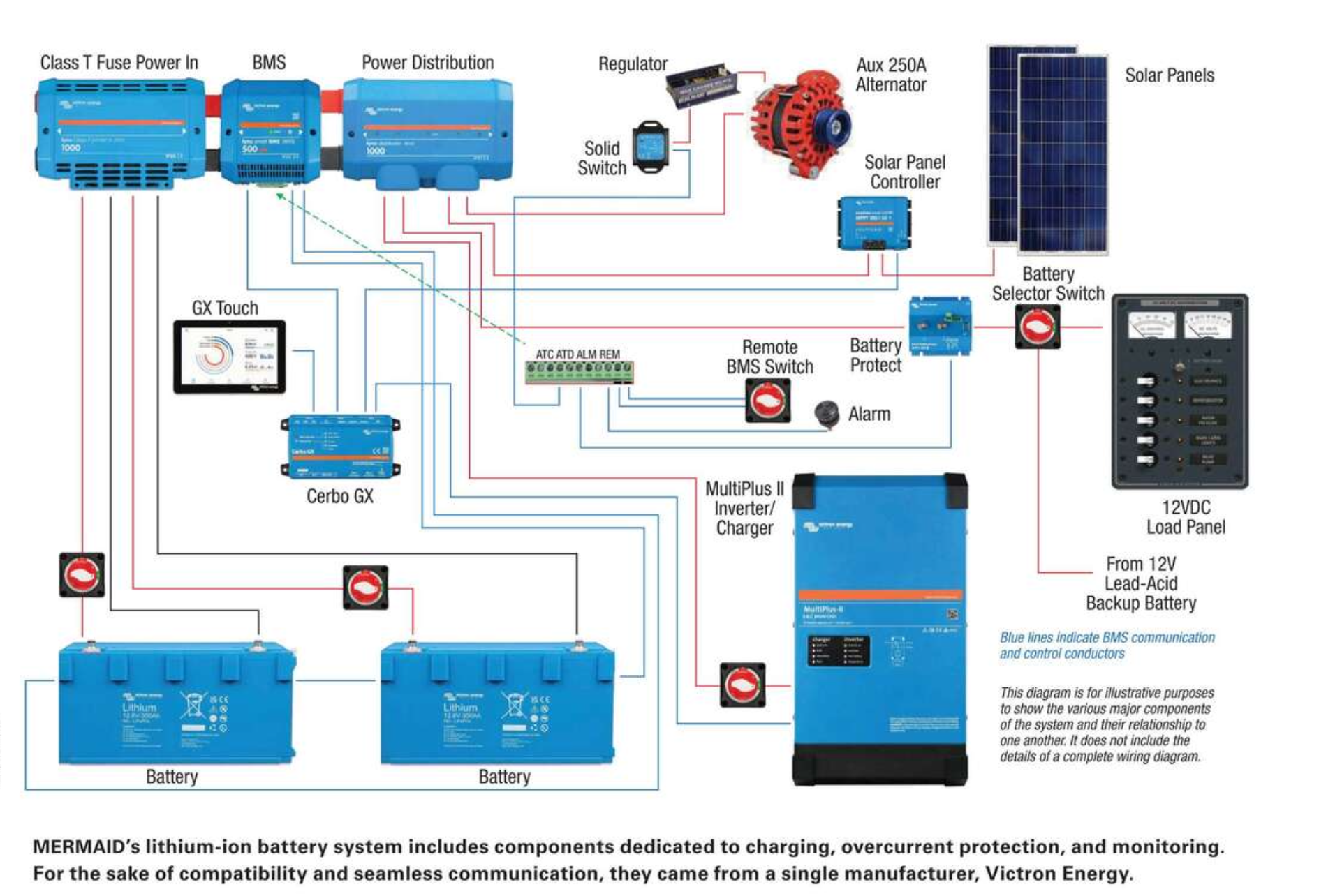

For those who like to peruse wiring schematics - I'm not one who does - Wooden Boat Magazine's current issue has what must be the Mother of All schematics. It is in an article about the electric refit of a classic wooden sailboat. To say the author went to town would be an understatement. But that's not criticism really. I'm just struct by the complexity of the project. I'd post a pic but I think that might be a violation of some sort.
@shemandr to paraphrase a common expression, "Complexity is in the eye of the beholder." I know the author of that article pretty well, we've been working together on a project for the past couple of years, this was one of his simpler jobs and simpler schematics.
It takes some time to learn to read schematics and some guidance on how to do it. One aspect of the schematic in the WB article is the inclusion of the communication cables. These are in blue, ignoring them and only looking at the red lines the schematic becomes much easier to understand. Next pick a function, say charging, look for the charging sources, in this case the Victron Multiplus, alternator, and solar panels. follow the red lines to see where they go. In this case they all go to the "Power Distribution" box (Victron's fancy name for a DC+ bus) and the DC panel is connected there too. As you trace each line you can begin to see the relationship between each of the parts.
I've also attached another schematic Don drew. This is considerably more complex covering 5 pages.
The article in Wooden Boat is a great introductory article for anyone considering a LFP installation. The article goes through each part of the system and explains what it does and why it is important. Wooden Boat Magazine does sell individual digital copies of its magazine. This article is worth the $7.50 if you are interested in the subject. It is in the Sept/Oct 2026 issue.

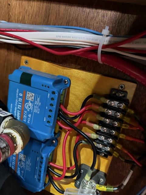

About ready to do the installation and looking at the installation instructions for the Victron 75/15 MPPT solar controller I am at a loss as where put it.
You can't put it where it can get wet plus here is an excerpt from the installation warnings:
• Read this manual carefully. It contains important instructions that need to be followed during installation, operation and maintenance:
• Install the product in a heatproof environment. Ensure therefore that there are no chemicals, plastic parts, curtains or other textiles, etc. in the immediate vicinity of the equipment.
• The product is not allowed to be mounted in a user accessible area.
• Ensure that there is always sufficient free space around the product for ventilation.
I am especially puzzled by the bullet "The product is not allowed wo be mounted in a user accessible area"
So where the heck can you put it? I'd like to mount it under the nav table but that is "user accessible" Really, except for lockers and cabinets where ventilation is limited where is a place that is "not user accessible" on a boat? So if you have one of these, where is your mounted? Pictures would be appreciated.

My guess (as just a random guy, not a Victron dealer or certified installer or anything like that) is that they mean don’t put it in a place where it could be tampered with by passengers. Probably a bigger issue on commercial vessels than a recreational sailboat. Pretty much everything on a 40’ pleasure sailboat is equally accessible. (Until you need to service it, then everything is equally inaccessible. ;) )
I think if you mounted it under the nav table you would have to devise a method to protect the terminals from incidental contact.
As far as location, the 75/15 is really small. Do you have room near your existing shore charger or inverter?

I think legal writes the first third of most manuals. They have to cover a wide range of uses. It's not surprising that there are some unrealistic recommendations for a particular installation. But miss one and don't expect warranty back up.
Shakespeare was spot on.
24,832
I would not overthink this. The MPPTs are pretty much an install, program, and forget item. They have a useful Bluetooth connection that allows you to check on the performance and adjust the functions without touching the hardware.
They make a cover for the terminals but it is almost as much as the solar controller

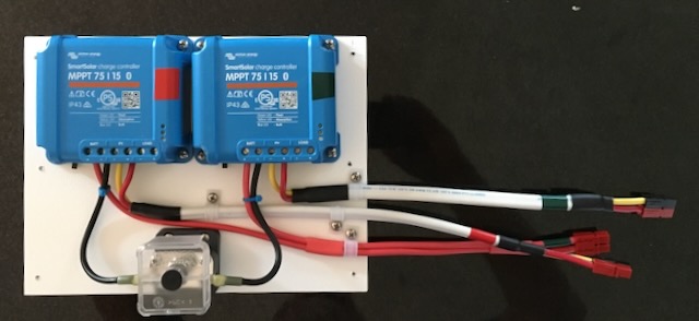

This is about the time to find a friend with a 3D printer.
I had the back fashioned for my power switches.

Yea, I am overthinking it. I'll install it under the nav table where it is only about 5 feet from the new Li battery and install a wire cover from Victron to protect the wires from inadvertent contact. I'll have about a 20 foot wire run (one way) from the solar panel to the Victron 75/15 controller
24,832
I used wire pin terminals
I’m going to add a wire clamp to fix the wires in place on the board.

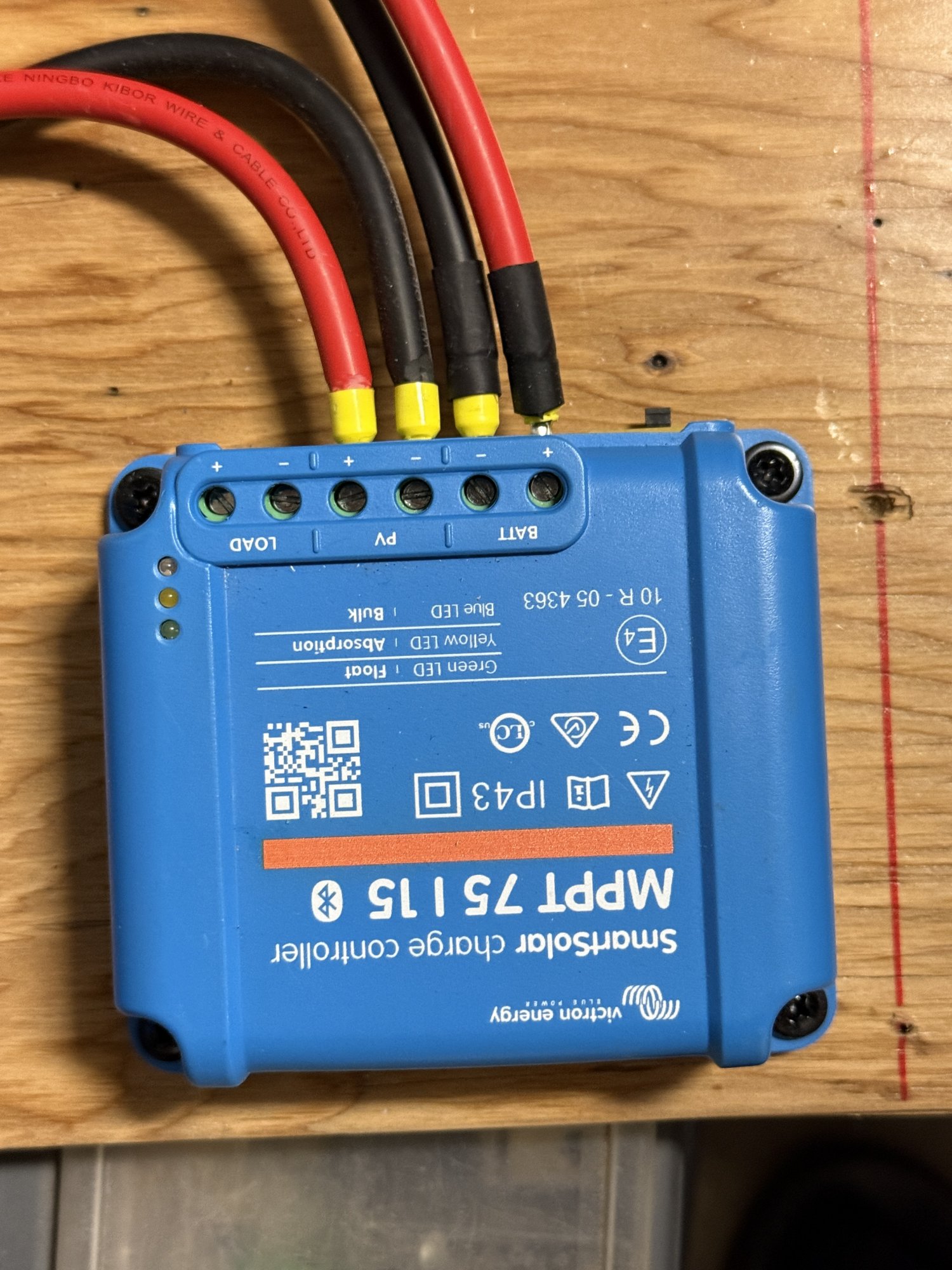

The mounting directions also say to “mount vertically(with terminals facing down) on a non-flammable substrate”. Not many non-flammable substrate locations on a fiberglass boat.
14,211
Mounting with the terminals facing down prevents water from entering the terminals.
using ferrules makes the job a bit easier but are not necessary if the instructions are followed exactly.
The controllers on my boat are mounted on a piece of starboard. Over sizing the controller will reduce the heat generated by the mitigating a fire hazard. The noncombustible caveat is probably generic for all Victron controllers regardless of size. MaineSail has a new video out on controllers and over heating. It is listed in his forum.
