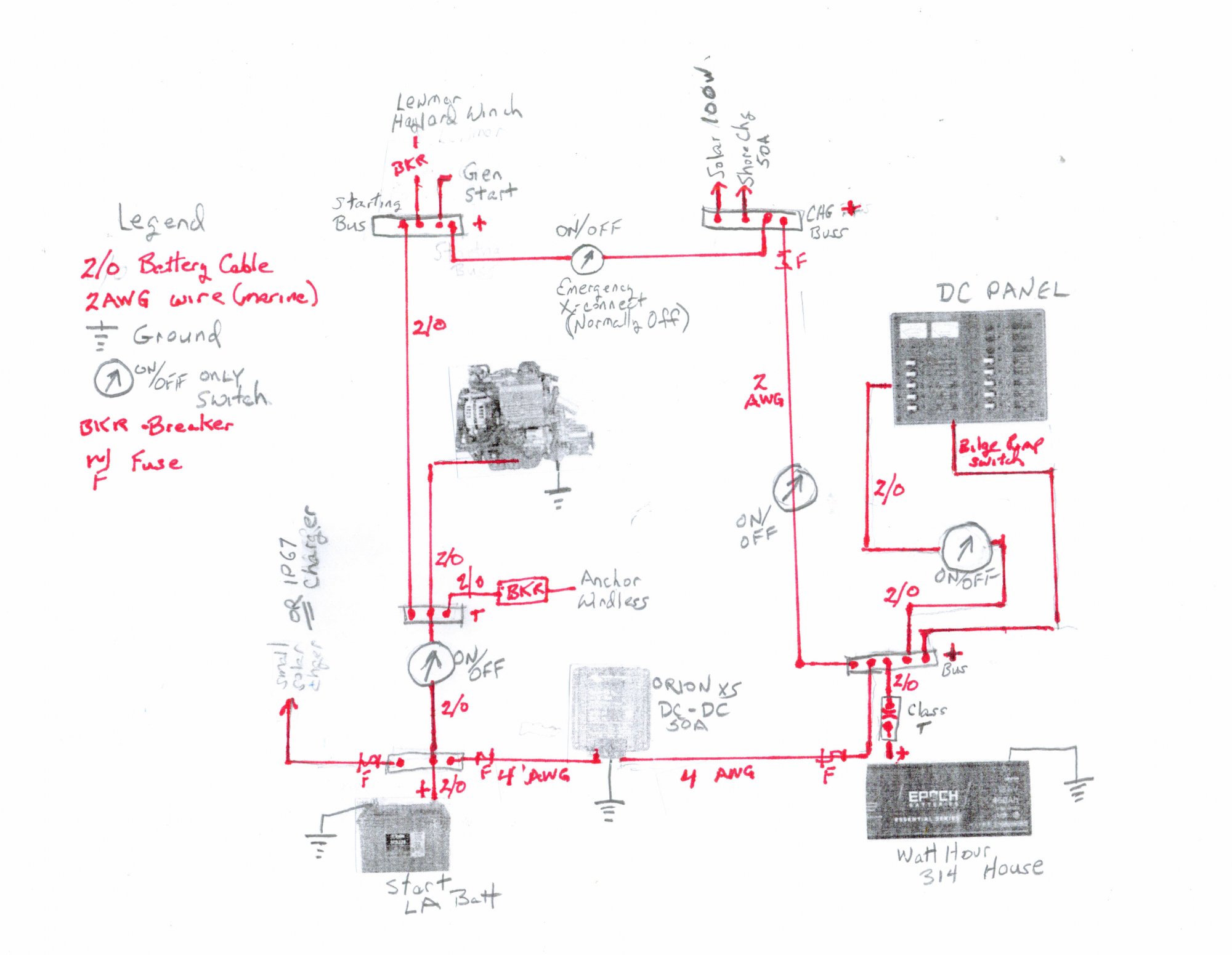

Here is my wiring diagram for installation of a 314 AH WattCycle Mini Bluetooth Lithium Ion battery keeping the stock Hitachi Alternator. I realize this is suboptimal but I think at the moment that is what I'm planning on doing. Lets not get into a debate on going to a externally regulated alternator right now. I am only asking the experienced forum members to give me their feedback. This is based on MainSail simple diagram with a Victron XS DC to DC charger. All switches are simple BlueSea ON/Off (not 1-2-Both) switches. There is also an Emergency X-Connect to start the Generator in the case of a Start Battery failure or to power the DC Panel in the case of a House Battery failure. The Grounds are shown simplified - all go to the common ground buss.

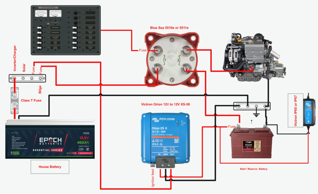

I'm showing MainSail's diagram first followed by wiring diagram. They layout on my drawing draws from Rod's diagram and the locations on my specific boat and wanting to keep the loads with the potential for large inrush currents normally run from the start battery. Have at it with comments. I'm open to suggestions.

The one thing that strikes me is that the fuse between the charge bus and positive bus should probably be on the positive bus side of the wire, not the charge bus side. The battery is the source of unlimited current there, so you need to protect the wire from it, not from the current-limited chargers.

There is a Blue Sea Class T Fuse (300A) within a 7 inches of the WattCycle 314 AH House Battery (same as on Rod's diagram)
I think I need a fuse on the line from the Start battery that feeds the Start Buss? There is none shown on Rod's diagram.
All comments are welcome.
May 17, 2004
6,235
The 300A class T can protect the 2/0 cables, but the AWG 2 cables have a maximum ampacity of 210 amps (assuming 105 degree rated insulation in a non-engine space). The 300 amp fuse wouldn’t adequately protect that.
Rod’s diagram does show fuses on some of the cables off the bus, and he doesn’t specify cable sizes.
Fuses are optional on start circuits, to avoid nuisance trips with high starter inrush currents.

Smokie, I see the specifications for the positive wires. I do not see a specification for the ground wire.
If the positive conductor to the load is 2/0, the negative (return) should also be 2/0. They carry the same current. Matching size keeps ampacity, heating, and voltage drop the same on both sides of the circuit.
As @Davidasailor26 suggests (and I concur), when the wire size changes (is smaller), a fuse is used.
The lack of a fuse on the cable between the battery and the starter motor on an engine is an exception in the ABYC safety standard.
Oct 26, 2010
2,229
Hunter 40.5 Beaufort, SC
I just showed simplified ground circuit. All Ground Wires are matched to the size of the hot wires for size. The 2/0 positive wires have similar (not exact though) length 2/0 ground wires or ground wires equal to the positive wire

There is no need to have a separate charging and DC+ bus. All charging and loads can be on the same bus. Each wire coming off the bus should be fused to protect the wire leading to the load or charge source. Doing this will eliminate one switch.
I would move the Lewmar winch and the windlass to the house bank. This keeps all the DC loads in one place. The Epoch 314ah battery has a continuous discharge rating of 250a and a peak discharge rating of 750a (5 seconds) which is more than enough to support the windlass and the winch, unless both are being used at the same time. One caveat, watch the amp ratings for the bus bars to be sure they can support the max load.
The Yacht Rigger has a cool Class T fuse holder that mounts on top of the battery. Saves space and makes installation easier.
Take a look at BEP Pro installer series of switches and bus bars. These are all surface mounted and use link bars to connect switches and bus bars. Simplifies installation.

I actually don't have the Epoch but rather a WattCycle 314AH Mini as recommended by @Maine Sail. My wiring scheme is set up to avoid potentially large "in-rush" current which, as described by Rod as potential problems for the BMS system of Lithium battery banks. This places the loads with the potential for "in rush" current onto the Start Battery. In particular the "in-rush" is not the same as "continuous" or even the "peak discharge current." The in-rush current last only for less than a second but can play heck on the BMS system. Here is the link to his discussion. Hopefully @Maine Sail will comment not only on the proposed diagram, but the topic of in-rush current. Maybe I'm overly concerned with this.
