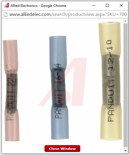

Heat shrink butt splices, using the correct crimp tool for the terminal....

Yep, I second the motion for Crimpable, Heat Seal Butt Splices...couldn't be easier and offer protection (if heated and shrunk properly) even under water, like in the bilge.

I like the BSP adhesive heatshrink connectors. I bought a kit which includes the different connectors in 3 sizes, crimper, and torch. Good advice on leaving a loop!

Heat shrink IS the belt and suspenders. Properly crimped, a butt connector will not fail, even under water for years. The concern is stray current; make certain the connection is not in the water (the bilge should be dry, but that is another topic).
