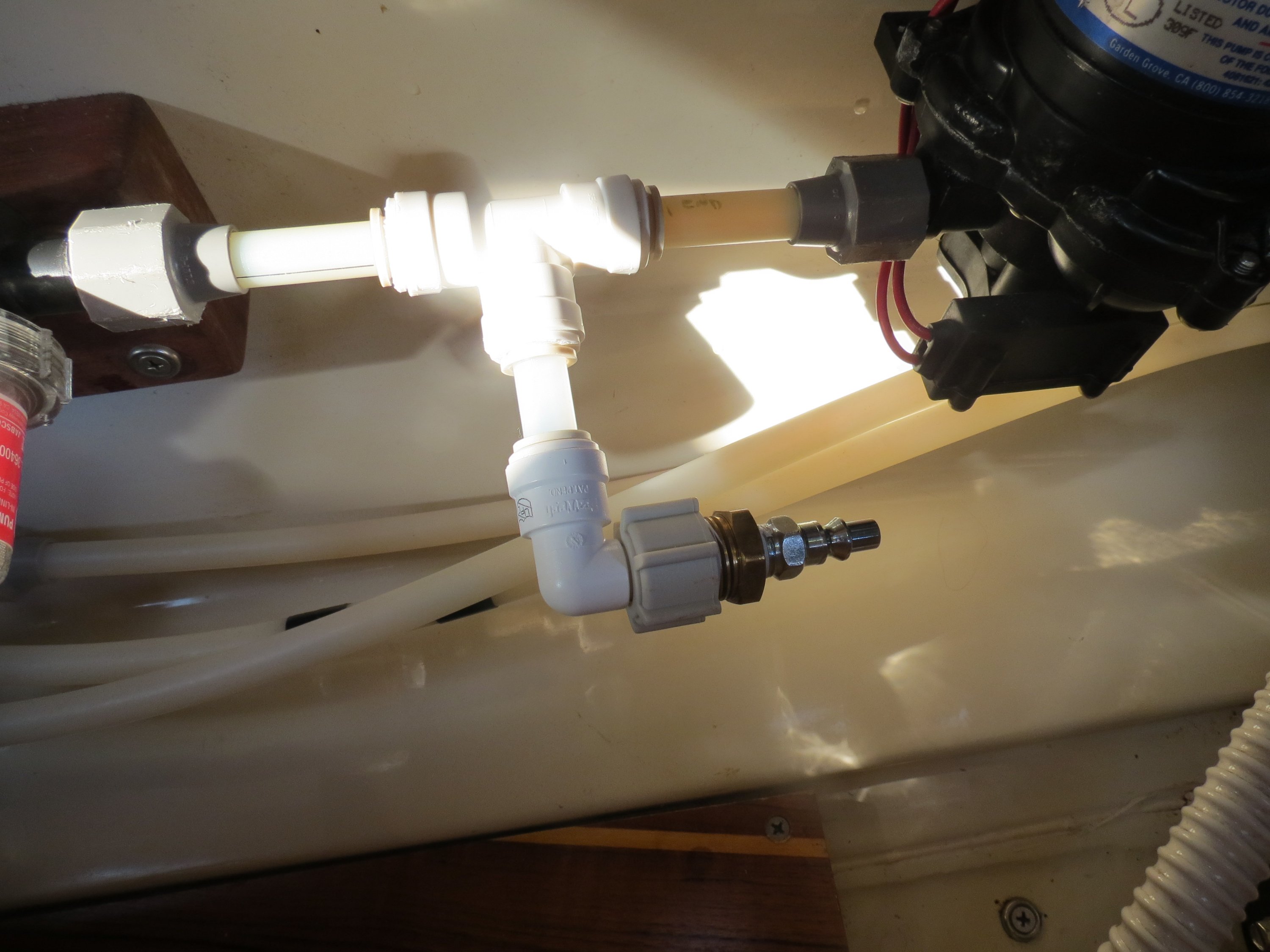

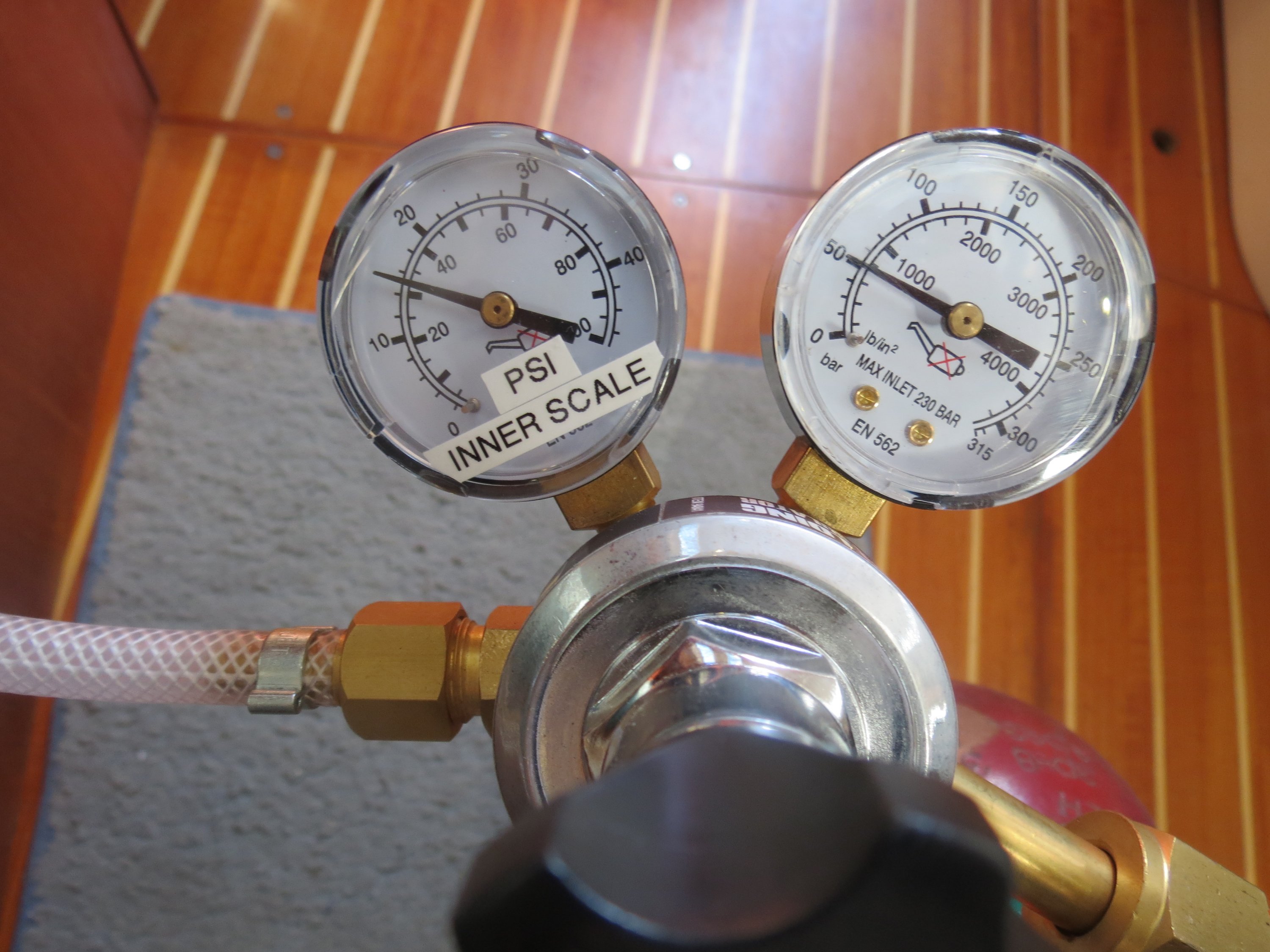

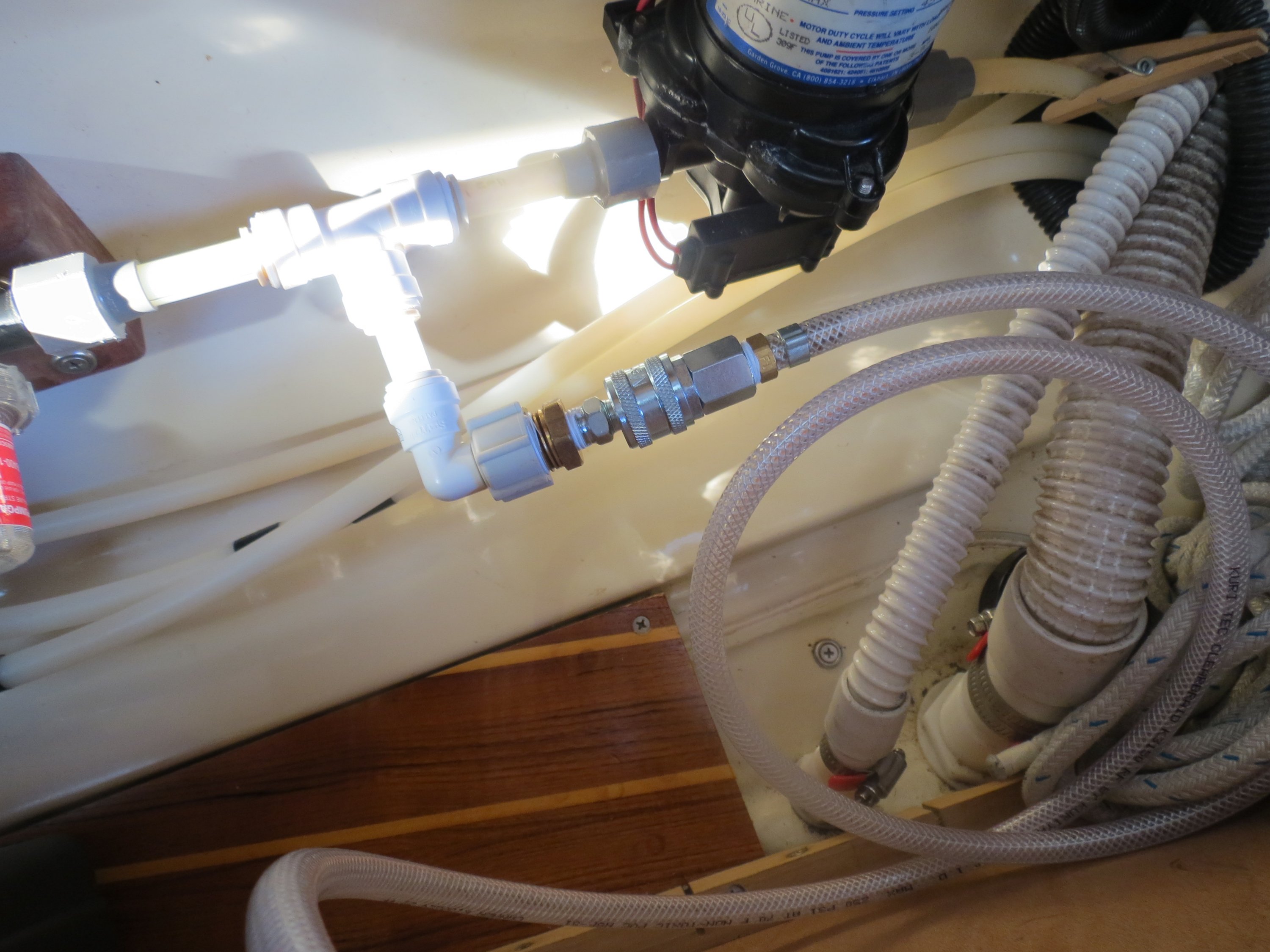

I don't worry about the residual water. I also don't bypass the tank but I use a bottle of CO2 to purge the water out of the tanks and lines. Before last year I just used my dinghy pump to blow the lines clear but a friend who in in the fire equipment business set me up with a 5# CO2 bottle and using that it is much easier.
What I do is this: I drain all of my water tanks by running the faucets until there is no water spurting out. I then attach a hose to the drain on the hot water tank, open the P/T valve, and use a drill powered pump to pump all of the hot water out of the tank and into the bilge. I add some liquid soap to the bilge and then scrub that out and pump with the bilge pump. A couple more rinses with fresh water and my bilge is clean. Then I close the hot water tank drain and P/T valve.
I now connect the CO2 bottle to an access port that I added before the fresh water pump. With all of the faucets closed, I open each valve on the water manifold and blow any water in the line back into the water tank. I have four tanks that I clear the lines. I am not concerned with any small amount of water in the bottom of each water tank. Then with all of the manifold valves to the water tanks closed I pressurize the system and blow CO2 through the pump and purge each water line to every faucet- both hot and cold lines. I then run the drill pump to remove any small amount of water that was pushed into the hot water heater.
That's it. Done. When I used to use the dinghy pump I would do the same thing except I would disconnect the lines to and from the fresh water pump so I could blow back into the water tanks, through the pump separately, and through all of the distribution water lines. Blowing air through the water pump adds a great deal of restriction, so that is why I disconnected it. Now with my CO2 system I just pressurize the system to 30psi and walk around to each of the faucets.
