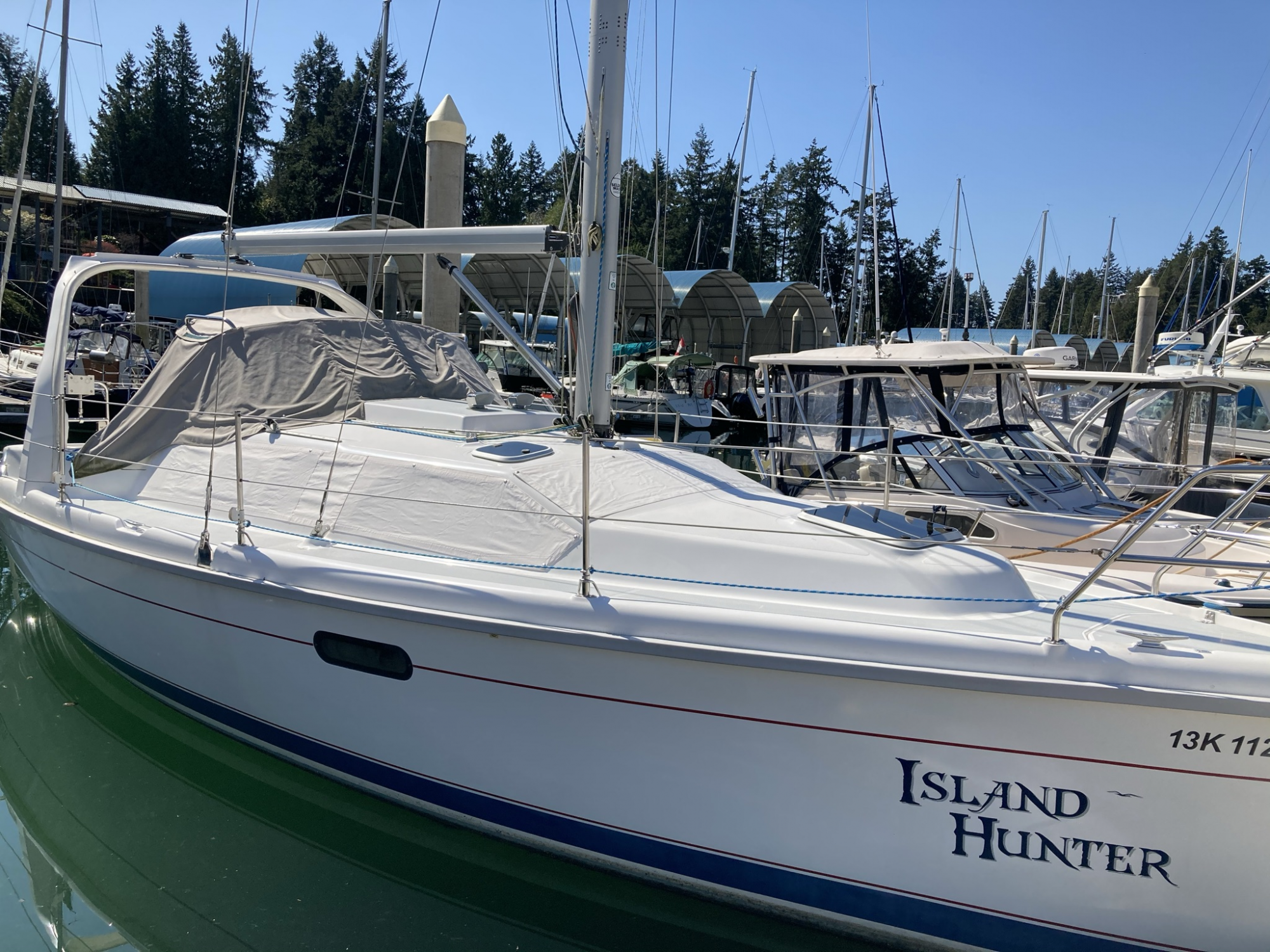

The one thing I don't have in my grab bag of photos is a picture of the white panels I made for the boat a few years back. Made of Sunbrella. Attaches to the exterior cabin with SS snaps and only takes a few seconds to install or remove each time.
I leave them on the windows over the summer when at the dock to keep UV out and when it's really hot at anchor and no breeze, I'll put them back on. Still fairly bright inside.
Finally got around to taking a few pictures of the white window panels. Whole thing wasn't much over $50.00.
