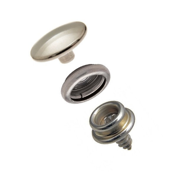

The one thing I don't have in my grab bag of photos is a picture of the white panels I made for the boat a few years back. Made of Sunbrella. Attaches to the exterior cabin with SS snaps and only takes a few seconds to install or remove each time.
I leave them on the windows over the summer when at the dock to keep UV out and when it's really hot at anchor and no breeze, I'll put them back on. Still fairly bright inside.

Will post next time I am out to the boat. Requires a grade four, reform school education to sew and install. Without a doubt, the quickest, easiest and cheapest Sunbrella job I've done on the boat to date.

Whew, I might make it then! Hahahaha. Might be close...
How are you attaching to the boat?
