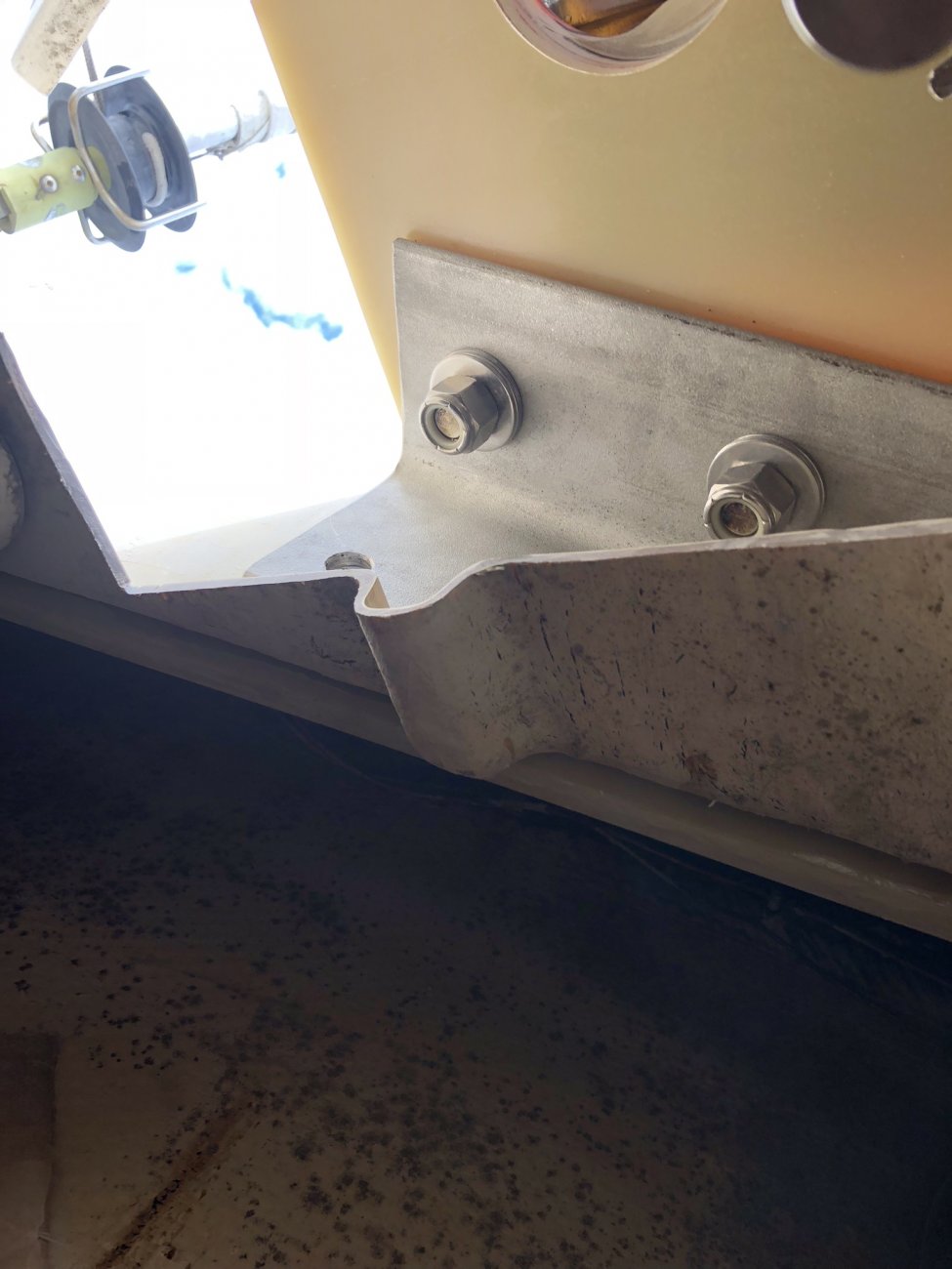

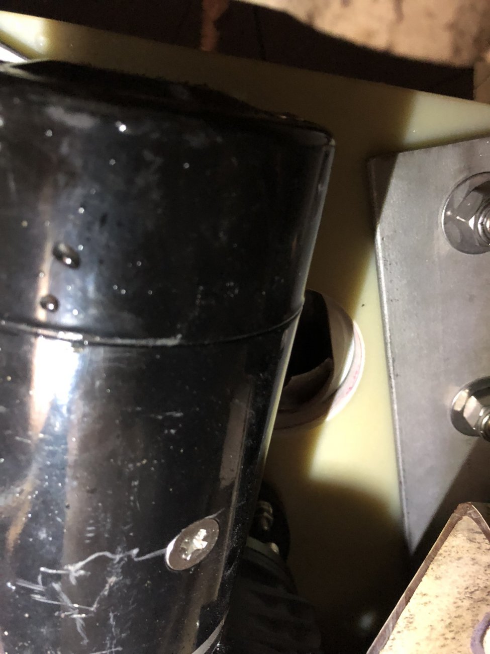

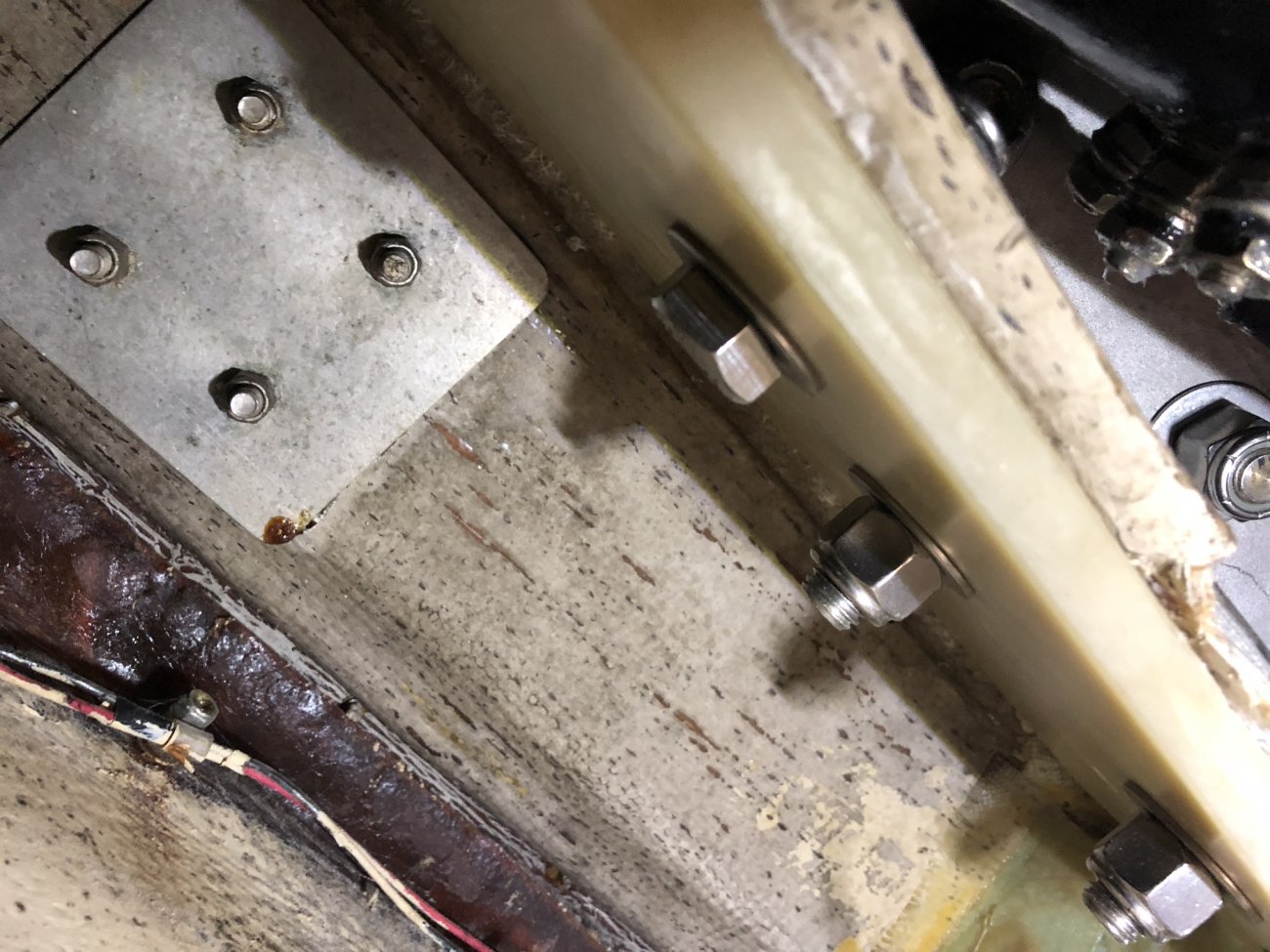

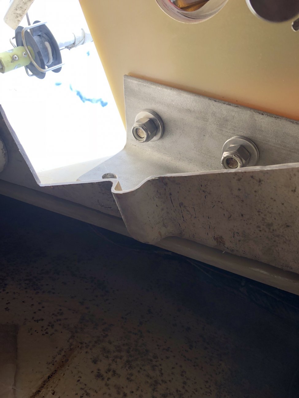

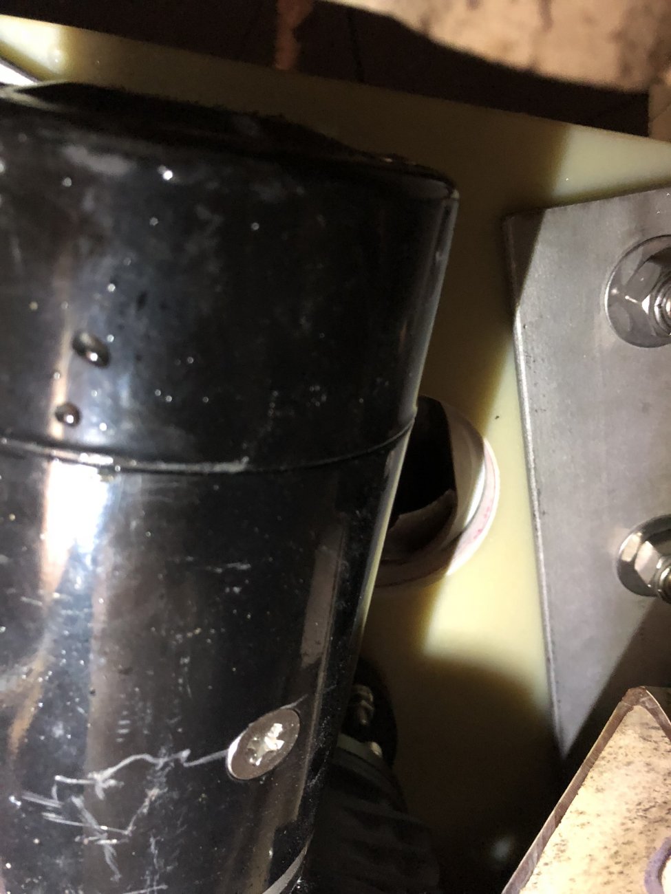

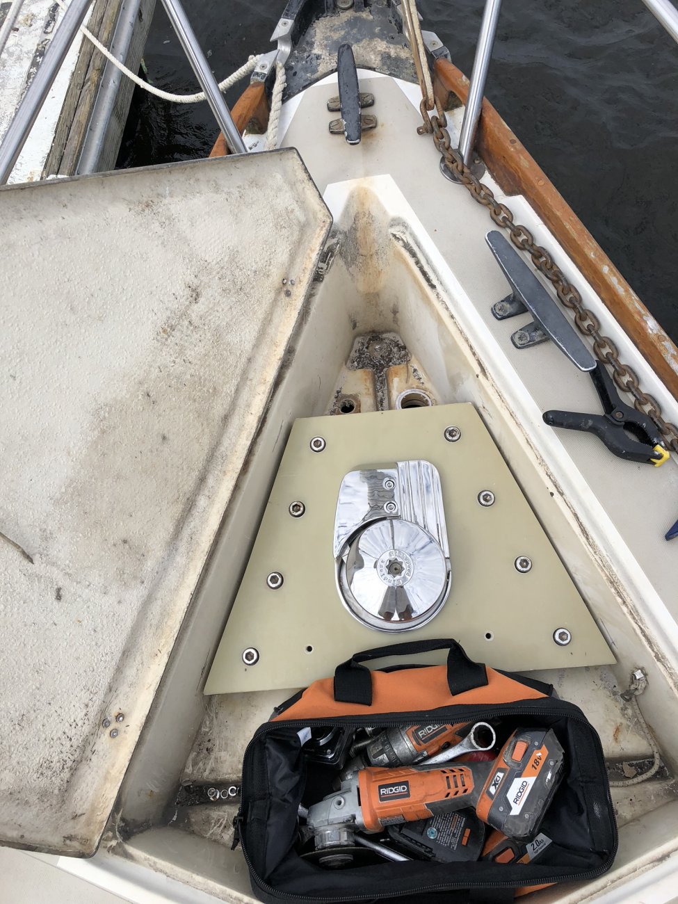

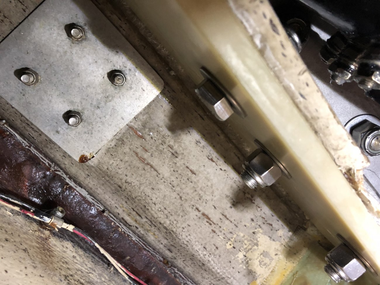

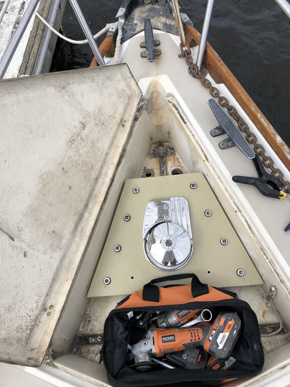

Well I've completed the Windlass installation. It was a very long rode to get to this point. I'll post the main points and if anyone has any questions, I can fill in the details.
1) purchased C1512 Vertical Windlass from Five Oceans; $750 after the 30% discount + additional 15% for on-line purchase; with free shipping. More power than is needed but fit my existing chain and the price was right.
2) after tossing the ideas around with members of my Yacht Club (RYC), I decided to mount the windlass under the hatch in the anchor locker. In order to close the cover, it was necessary to cut a portion of the bottom out of the anchor locker. For support, we mounted a piece of 1" G10 to 1/4 " SS angle. The backing plate for the SS angle is 1/2 G10 on the outside of the side walls of the anchor locker. The system is bolted on both sides of the SS angle. The 1/2" G10 is epoxied to the outside walls.
3) the windlass required three 2.0 awg from the motor to the solenoid. The solenoid is mounted in the hanging locker across from the head along with the circuit breaker. This run is about 15'. The positive and negative wire is 2/0 awg and is about 25' long. There is an up and down switch in the cockpit and foot switches in the anchor locker. Three 16 awg wire was called for for this run. I used (3)14 awg instead.
4) I was very fortunate to have input from many talented members at Riverton Yacht Club, especially Ryan Lippincott who is the Grandson of Howard Lippincott. Ryan is a very talented mechanic in his own right. I hired him to build and install the frame for the windlass. He did a great job.
5) The install was successful. I have used it three times now and once during an urgent situation when my belt broke close to the shipping channel on the Delaware River. Although it has added some pretty significant weight to the boat, the convenience is well worth it. Even though I caught the 50% sale at West Marine for some of the wire, the wire cost almost as much as the Windlass. Here are a few pics.
