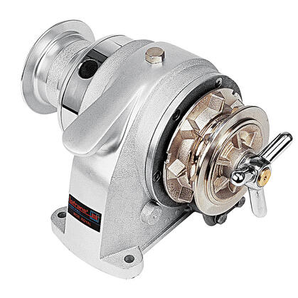

I’m currently in the process of installing a Lofrens Royal manual windlass on my O’day 34. Same boat different transom.
It’s manual due to space constants and ease of installation. I’ll try and send pics tomorrow.

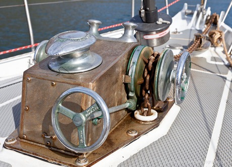

Here is their idea of a windlass on their boat.
More than you need on your Oday35.

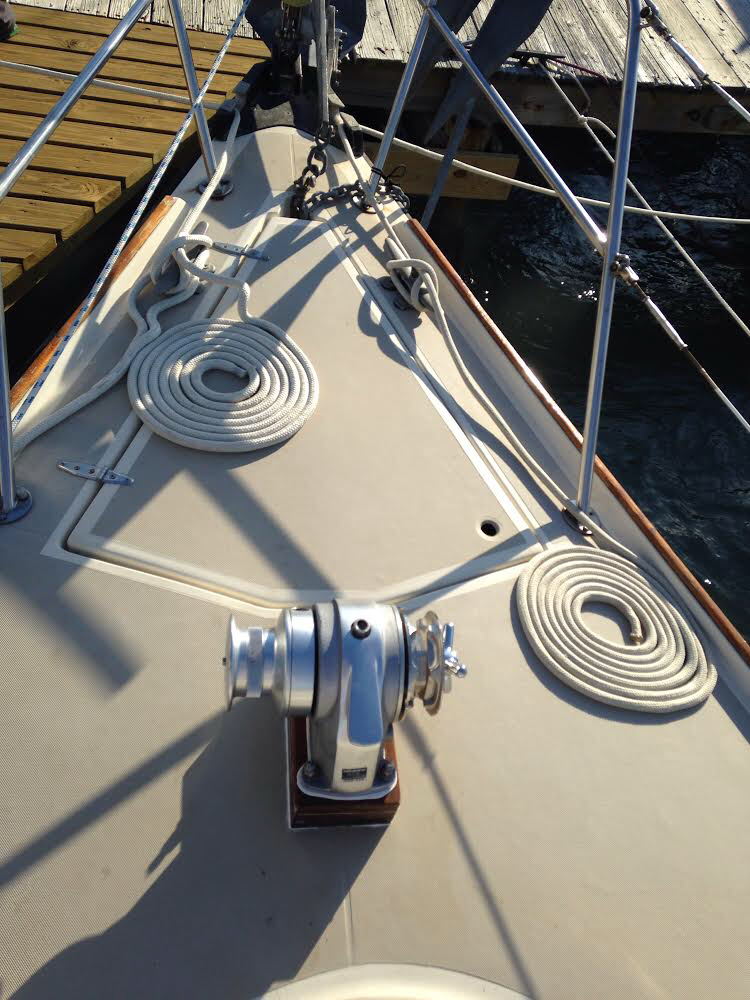

Installed the manual windless with backing plate of 1” ipe wood today.
The O’day 34/35 doesn’t have a typical chain locker that is needed for proper chain fall from a windlass. Or space for an electric windlass. (See pics). So I built up an ipe (supposedly one of the hardest woods) base 3” high to allow some chain fall from the windlass. I’ll retrieve my 100’ of 5/16” chain and 150’ of 3/4” nylon rode by hand until the chain is vertical with the weight of the 22kg Delta anchor and the bottom material on it then I’ll use the windlass. This is done with the chain locker open so the chain can be flaked as it’s retrieved. I’m going to cut a small cutout in the rear of the chain locker to allow the chain and anchor to be deployed in an emergency situation using the windlass with its built in brake. With all of this weight already on the bow I decided the boat didn’t need the excess weight of an electric windlass.
I’ve also purchased a chain stopper and chain snubber. The stopper will be installed forward of the chain locker.

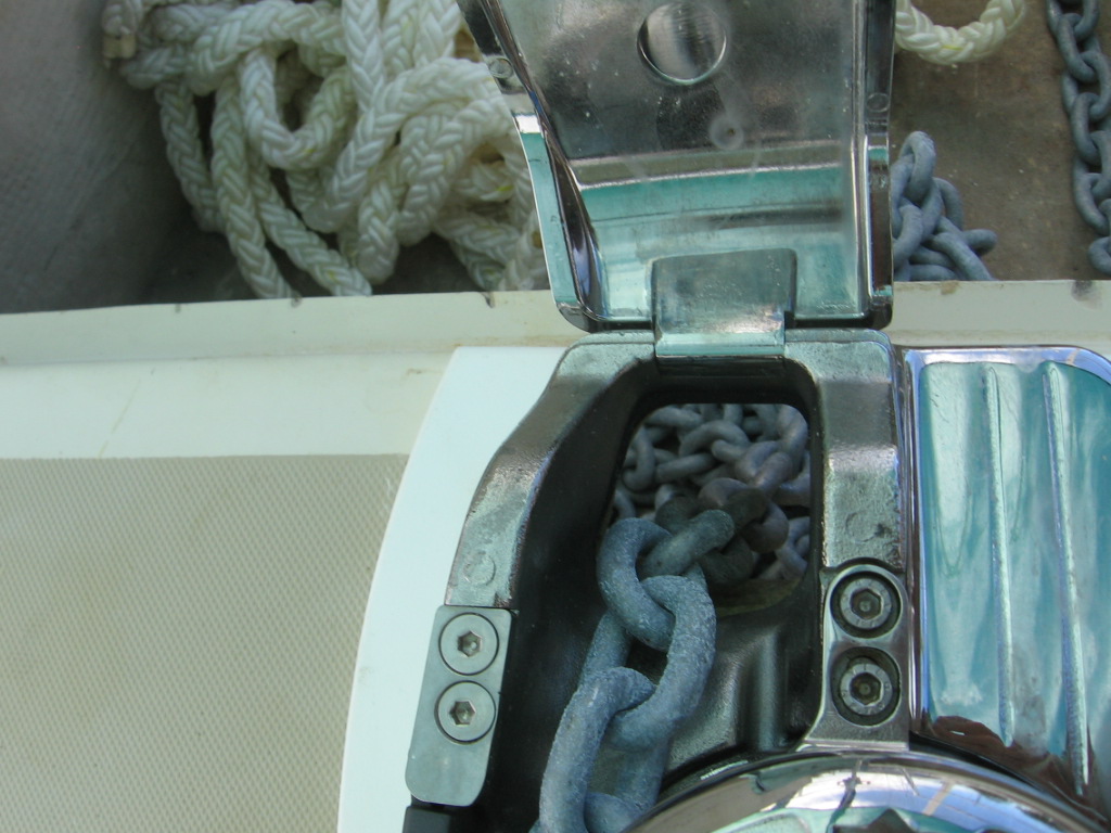

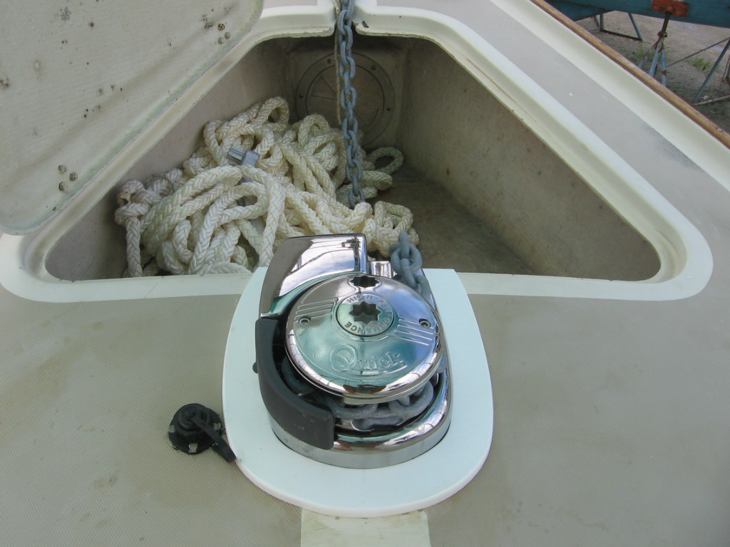

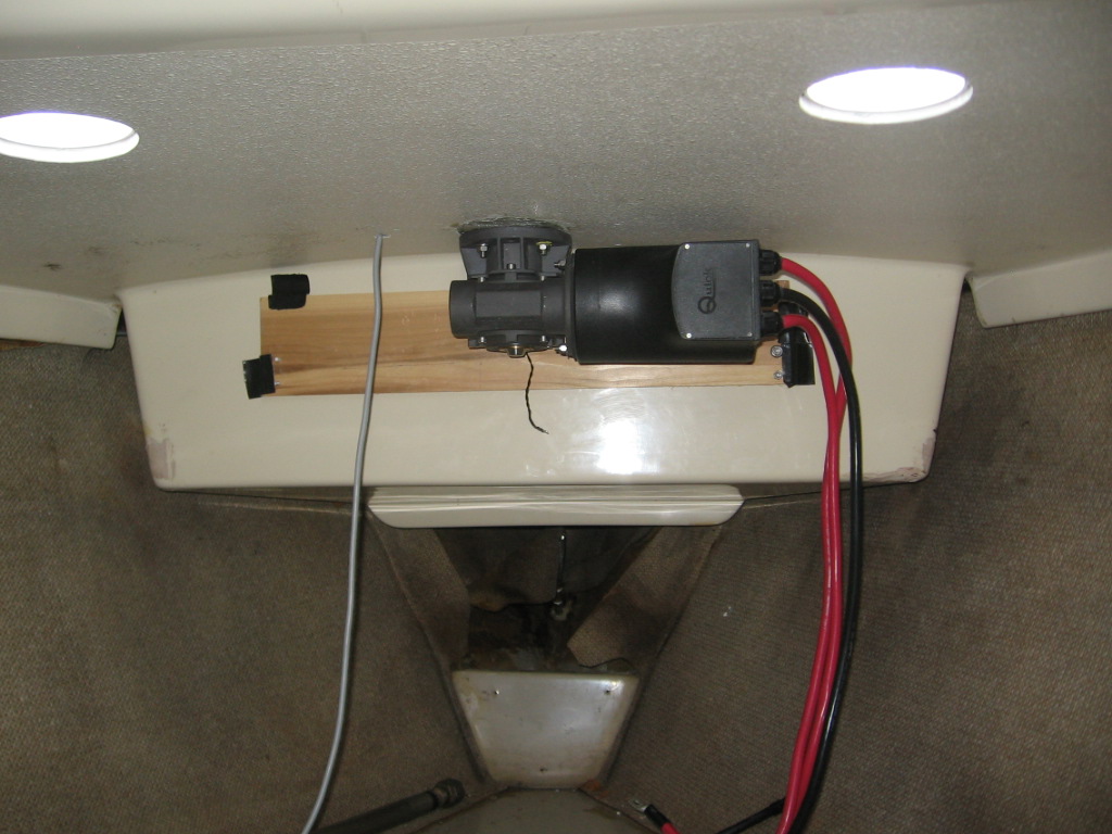

I installed a Quick electric vertical windlass on what was my O'day 37. Worked well with 40' of 5/16 chain and about 100' of 8 ply nylon rope on a 40# Mantus anchor. I did have to kick the pile of chain forward a couple of times. Here are some pics.
Likes: njlarry

Thanks for posting this. Is there a cutout in the aft edge of the locker lid?
Yes. I cut the hole through the deck so that it came out flush with the vertical wall of the locker. The anchor drop aperture was used as template for cutting the hole. It was not necessary to cut into the fiberglass lip that the hatch fits into.
I would always leave the hatch open when lowering and retrieving the anchor so I could keep an eye on the rode and prevent the chain from scratching the top of the hatch. Once the anchor was aboard on the roller davit, I would back down on the windlass, lift the slackened chain to the side, and close the hatch, then tighten the rode.

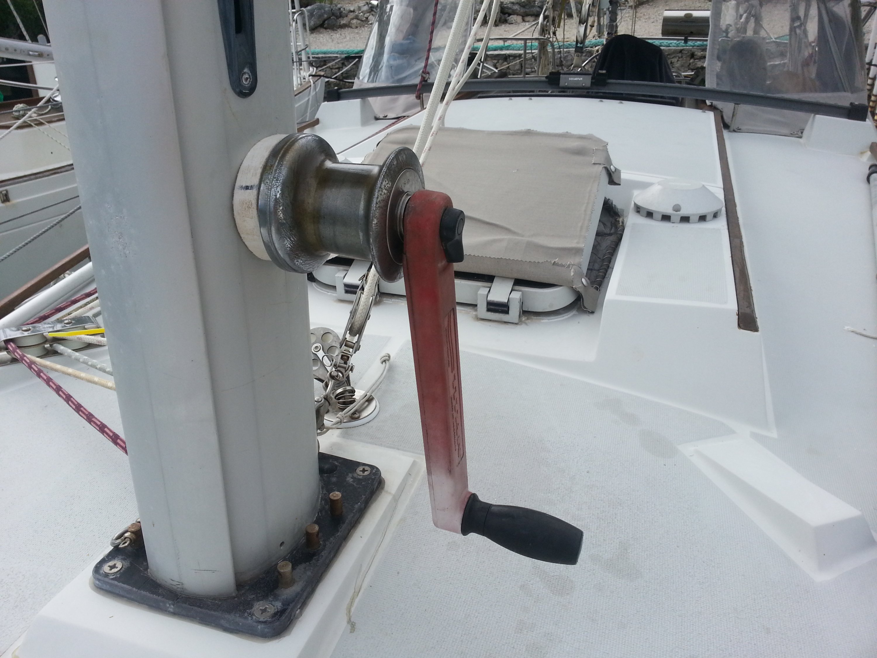

Anchor Hauler (the cheap easy version) O'Day 322
Keep in mind I'm in crystal clear water that's usually less than 15ft deep. I've had three boats with electric windlass and never used them. One of my friends here on an Island Packet lost his wife at Great Stirrup Cay when she hit the down button on the windlass and somehow, got chain wrapped around her leg. She went under the pulpit and that was it.
When I got this boat she had over 200ft of chain in the bow plus three anchors. All that weight stored 4ft above the waterline sure made her slam coming off a wave. It's also great for the hobby-horse effect. For a windlass to "sort of" work it needs to drop the chain straight down. That's impossible with a small deck level storage area.
I reduced to 35ft of chain and 100ft of 5/8 rode. I normally use a 35lb Delta. I copied an idea off a Norsea 27 I once owned (GREAT boat). I mounted a winch low on the mast, it makes short work of bringing in the rode and the chain I haul by hand.
