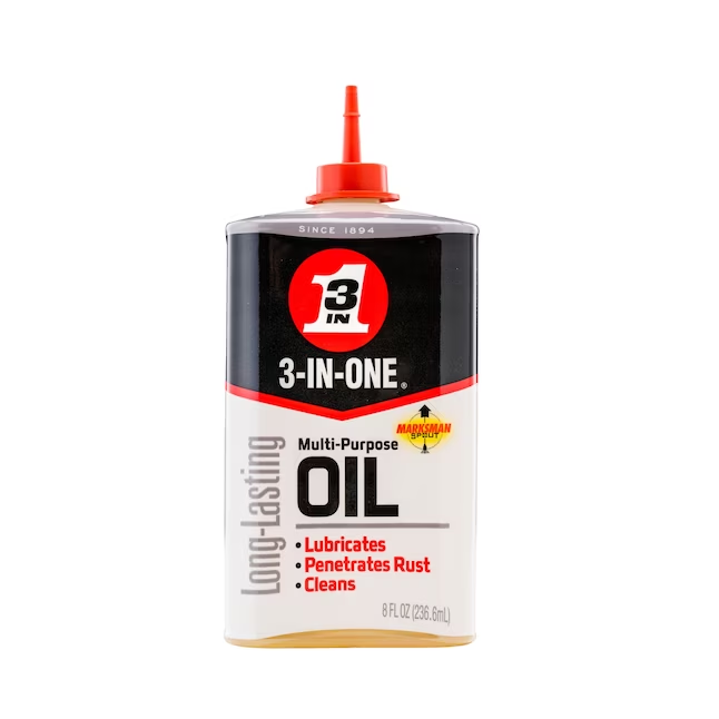

I use this...
that I affectionately call sewing machine oil… because my grandmother used it on her sewing machine. I have never had any problems with my winches, but I have also never done a direct comparison with other products so… YMMV
