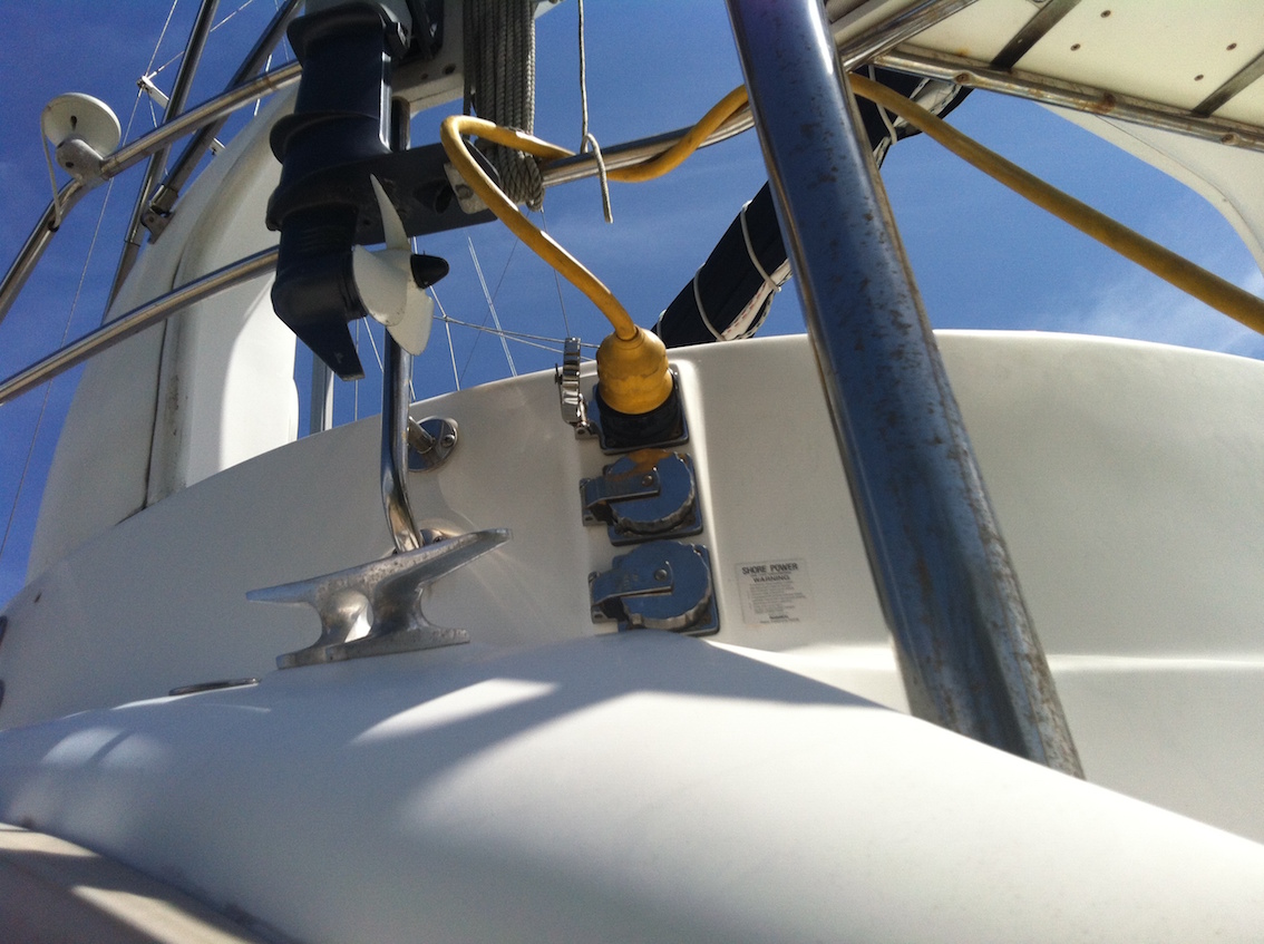

Hi,
I'm thinking of converting to the Smart Plug system too. I only worry, whether my old "sockets" are of the same size, screw positions etc., as the new ones for the Smart Plug. Is this a standard socket and thus a hassle free and simple bolt-on solution, or will I have the chance to run in to cutting drilling and fiddling new cut outs?
My boat is a 1999 Hunter 410 and here is the pic of the actual sockets:

Hi,
As I recall (dangerous) think everything fit ok without drilling new holes, etc.

Sep 29, 2008
1,981
Catalina 310 #185 Quantico
Update: Was simple to replace the socket as all the holes lined up and were the same size (it was designed that way). Equally simple was the plug replacement; only hard thing is sliding the cord through the strain relief (use lots of wet soap).
