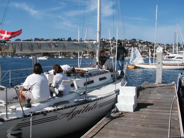

Joe, the picture you provide shows a sail flaked far neater than I achieve even after 15-20 minutes of the two of us wrestling with it at the dock. But I think I'm too lazy to learn to do it that well.

How to flake your mainsail...
But perhaps I've taken too much of your time for such a flakey subject. Thanks to all.
Geoff
Geoff... I understand your frustration so.... get the sail down anyway you can until you get to the dock where you can flake it properly...
The key is to alternate the panels as the sail comes down.. I do this by standing at the mast.. difficult otherwise.
Once the sail is down... stand in the cockpit and even out the folds by pulling the leech sections backward. You should be able to get 3 or 4 folds evenly straddling the boom before going back forward and cleaning up the rest of the sail... Finally, secure the sail with 5 or 6 sail ties using a slipped square knot or a simple bow tie. Now you're good to go with the cover.
BTW the sail in the picture is no my boat, it's a friends and was posted to show an example of laminated, bolt roped sail flaked on the boom ready to deploy. My boat has a traditional dacron main with slugs.
