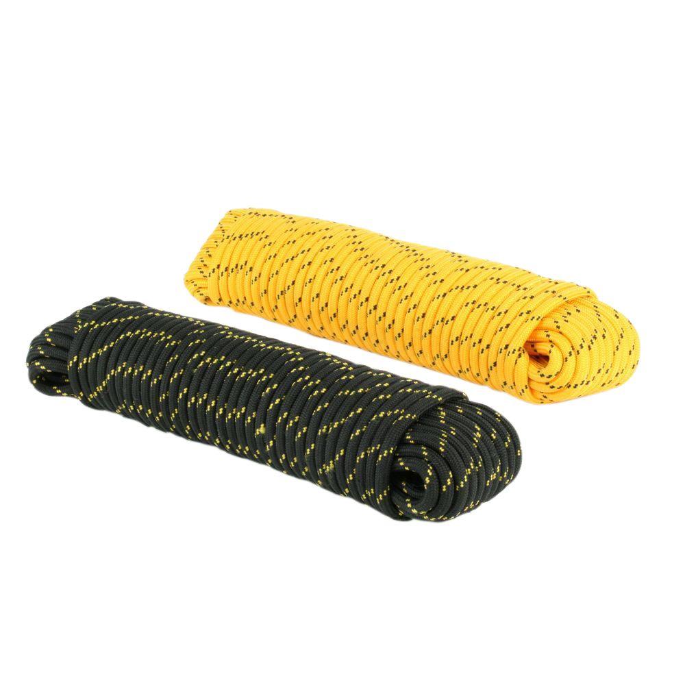

It really does handle like a polyester double braid. I have been using it for 12 years or so and the stuff holds up.
Home Depot sells it in 100' bundles 1/2 in. x 100 ft. Assorted Color Diamond Braid Polypropylene Heavy Duty Rope
I don't think this is true double braid as the inner core is not braided.
I use it for work rope to haul stuff (satellite dishes, cinder blocks, etc.) up onto roofs, and as the pull line on my extension ladders. Much better hand feel and knot holding than regular poly triple braid.

Chip, that version of polypropylene rope doesn't have any UV resistance, it will disintegrate in a season in the sun, and become very weak prior to that. It isn't a double braid. Just basic rope for all the kind of things you mention, but when it fades, throw it away, it is weakened.
I have had the black version last for several years on my extension ladders stored in the sun on the rack on my truck. The lighter colors do break down quicker. I would definitely not use it for towing, but changing out a painter every year or so wouldn't bother me, and 100' would make a whole lot of painters.

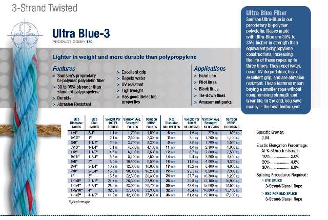

So, I did a little research. The rope that I was referring to as a 3-strand polyester is actually a Sampson 3-strand bi-polymer rope. I guess I was misled :doh:by the label on the product at WM which I believe read "polyester." I'll have to check on that next time I'm in there.
Anyway, here it is, and it floats, as I thought. This would be a good rope to use for painters and I may switch to it completely.
