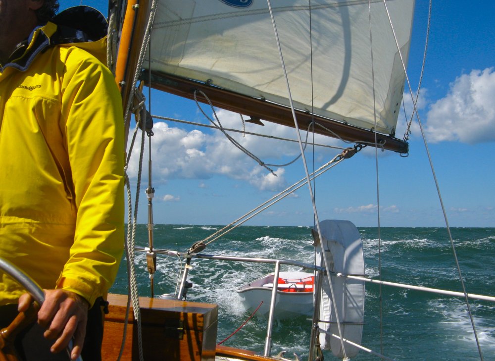

When our dinghy painter wears out, I buy a 20', 1/2" dock line with a loop spliced in one end. The bitter end goes through a hole in the bow transom, and is tied with a bowline, through another hole in the forward frame.
The loop is thrown over a cleat or winch when we board(easy for kids to remember,...). The dock line gets cleated as well, to the right length when we tow (which is always-no other option as the dinghy is too big to go on deck).
This is our second pram tender. We wrapped the first one and dragged it under the boat 30 years ago. That apparently left something in my brain now that reminds me to tighten the painter before powering(so far so good).
We also had to hunt that first pram down a couple times in the morning. The loop fixed that problem.

@jviss - He has a pram for a dinghy, so the bow end is a transom-looking "bulkhead" (for lack of a better term, though transom IS a better term) running athwartship. It is not at all pointy, like most bows. I think "bow transom" is really clear, but I've sailed prams.
For some prams, the bow end is not much narrower than the stern. They are boats that essentially have two transoms and two sides. If you blow up Tom's picture, you'll see what he means, though this is not as extreme as some prams.
