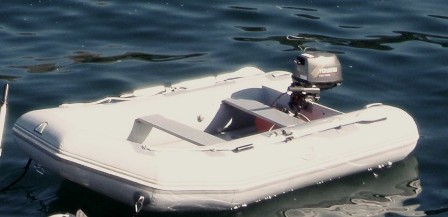

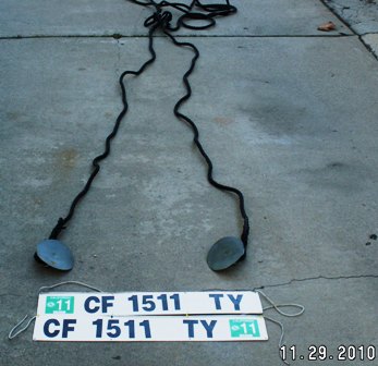

Here's what happened to me the last time I towed in the configuration you show. Now, I tow from the single tow eye under the bow. This was in high wind and steep wind chop. I suppose the 10-ft Achilles flipped, then dove, pulling off of the eyes. It must have torn where attached b/c the last I saw of it, it was half submerged blowing away from me in 30 kt. The bridle is 1/2" black polypropylene eye-spliced around galvanized thimbles to the pad eyes. Yes, it was DUMB to be towing in that. But, those were not the conditions at the start of the trip. I was only 12 n.mi. from marina.
The dinghy lost (but not the engine).

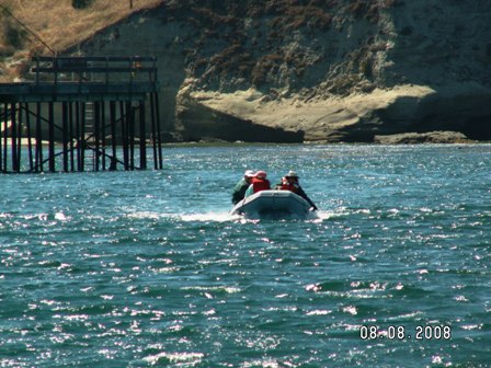

The dinghy in better days--me crew (Admiral on right of pic--port side) returning to ship leaving Santa Rosa Island at Becher's Bay. It was a horrid night at anchor that night!!:yikes: Cold, very windy--anemometer clocked to 35 kt--and loud, moaning wind sounds with the gusts. Behind us lay darkness and the "Potato Patch" between Santa Rosa and Santa Cruz islands. The couple in the dink (stb side) cruising with us on our boat are now deceased--cancer got 'em both. So sad. A cruise to the California Channel Islands was on her "bucket list."
