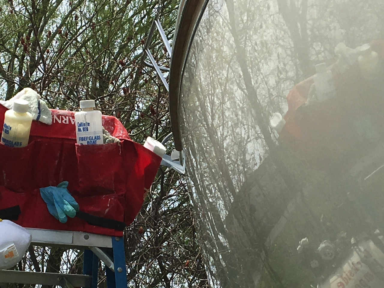

Twenty five year old hull, polished with 3m cleaner wax with a buffer, followed by hand applied Collinite Fiberglass Boat Cleaner and finally some Collinite Boat Wax. Took about 3 hours a side on a 36' boat. No silicone. One of the most time consuming parts of hull waxing is moving the ladder. Use a scaffold. Mine is two step ladders and a 10' 2x10 plank. Much easier on the knees.

I use the liquid, easier to apply. If the gelcoat has oxidized, it really needs to be buffed out with a power buffer and something more aggressive than Collinite, like the 3m Cleaner Wax or TotalBoat Total Buff. Once you have a good foundation, the cleaner and wax will work well.
