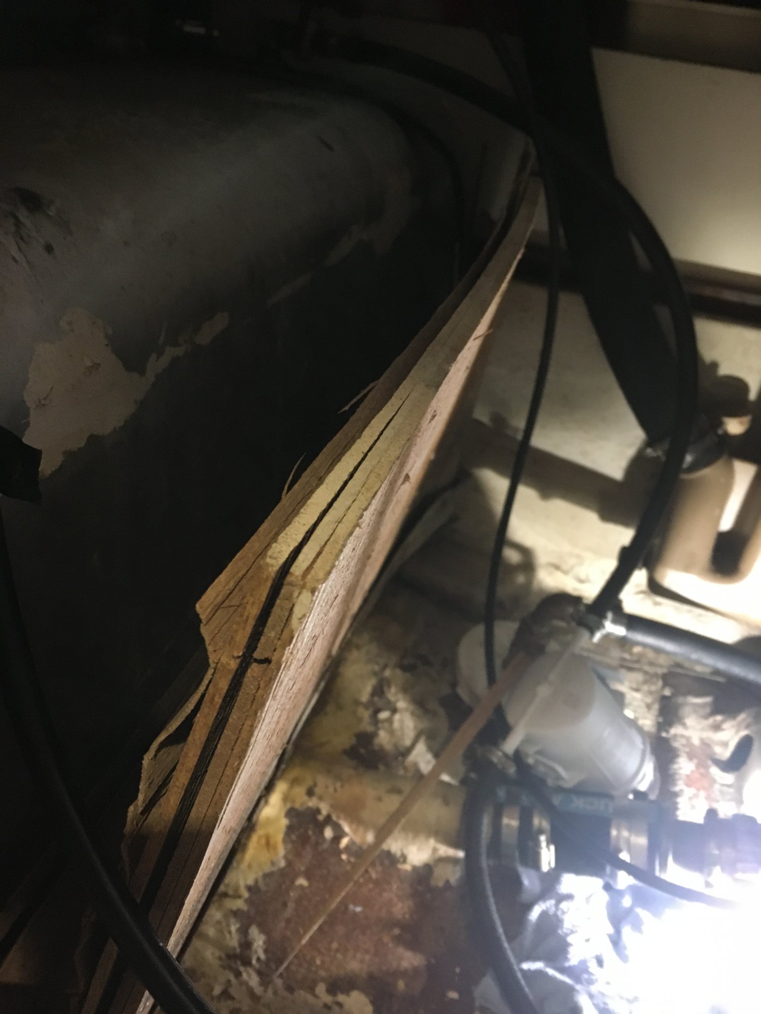

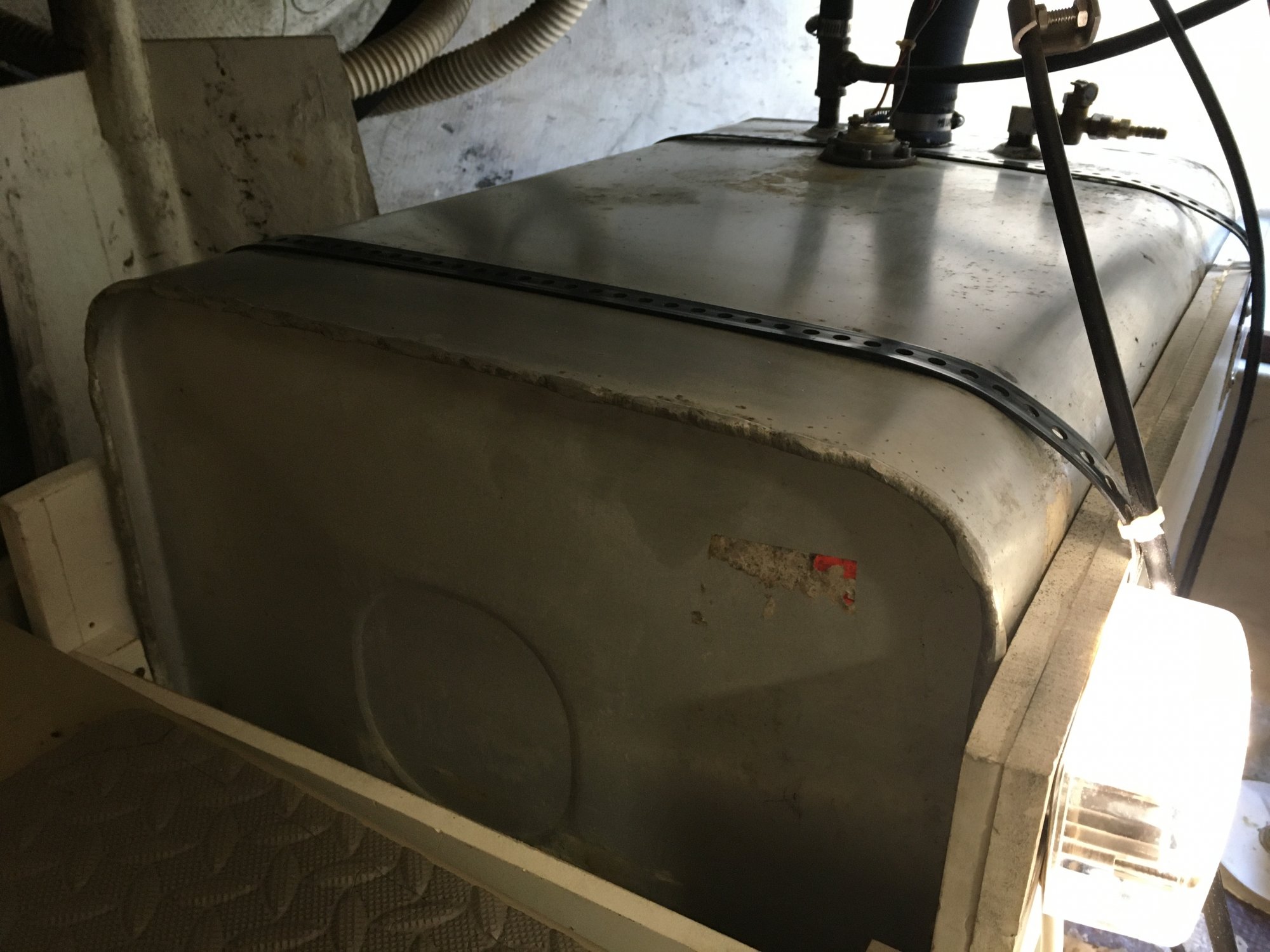

Hey folks, anyone know for a 1983 O'Day 30, which side does the fuel tank come out best. From the lazarette on the port side or the engine access side by the quarter birth. I need to replace the tank holding frame and platform.

On the 34/35 the tank does not come out without cutting either the liner or the tank. O'day installed the motor, all tankage and the plumbing before the liner was installed.
The 30 may have been built the same way.

The tank comes out easily if you remove the motor. If not then you may have to do some surgery either on the tank or on the boat.

Yeah, really no big deal to cut the liner, it's mostly cosmetic and with care can easily be repaired. I sweated it on my 34, but sure beats removing the engine (500 lbs) or cutting the tank up.

I followed SailingCal21's advice and cut the liner in the quarter berth using an oscillating tool. It is not in a visible location and the piece I cut out I backed with a piece of plywood and screwed it back in place then covered the joint with a nice piece of oak. Looks great and now I can remove it whenever I need better access to the engine, steering system, batteries, or fuel tank. With the liner cut the fuel tank slides right out no sweat.

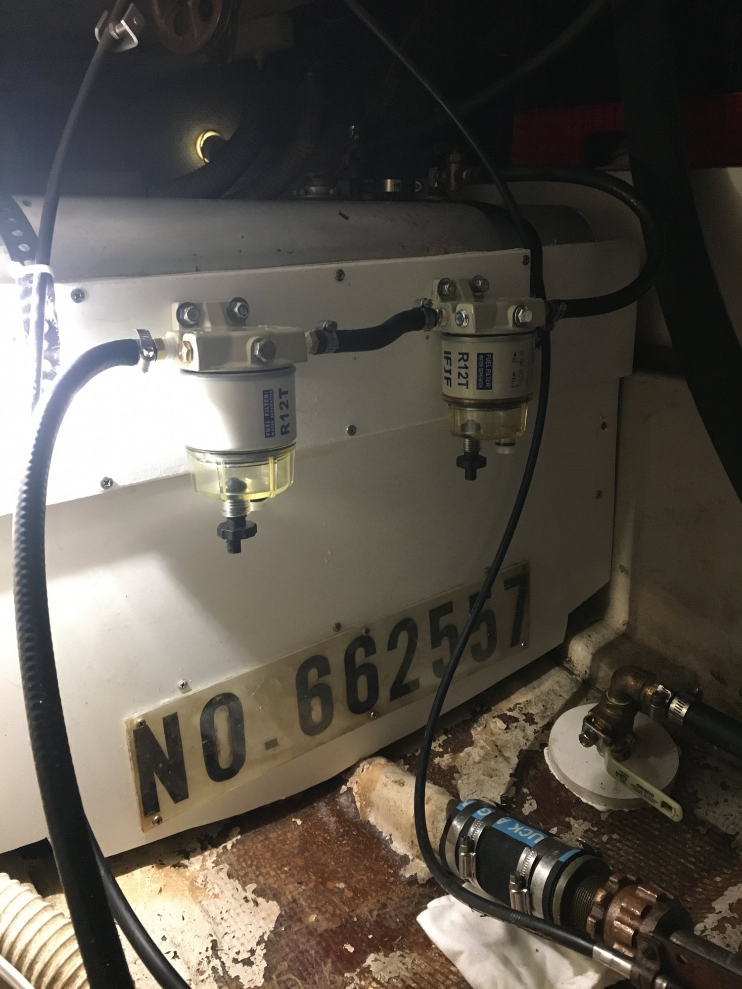

Looks good!... Where is your lift pump mounted? On my 35 it is mounted to the "bulkhead" between the tank and the engine compartment. Not sure why you have two R12T 10 micron Raycor filters in series. Do you still have the OEM filter on your engine?
Aug 11, 2011
1,020
O'day 30 313 Georgetown MD
Pump is mounted on the bulkhead, which is over the engine. The picture is how it was first set up. Since then it runs through a 30 micron and finally through a 10 micron. Yes the original style filter is still on the engine. I use a Napa Gold 3390
This multiphase of filtration is to avoid any water getting into the engine. With two viewable filter bowls, I can see if my fuel is contaminated. I'm trying to avoid my experience with engine failure.

I cut my aluminum tank in parts to get it out. Replaced it with a smaller plastic tank.

Different boat. When I replaced my fuel tank I ordered a new one with a threaded hub for the fill inlet. This reduced the height of the tank so that I could slip it in. Afterwards I screwed a hose barb into the threaded hub. May help if you have to cut the fill neck off to get it out.

I did the same - the tank was 34 years old without any way to inspect it without removing it. Turns out the tank was in exellent condition. However, the cost of the plastic tank was about the same as two inspection ports which would have been required (center baffle blocks access). I like the smaller size (19 gal.) and the fact that I can see the fuel level in the new tank.

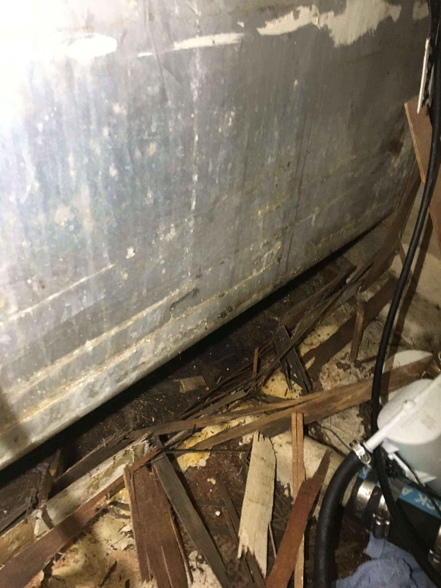

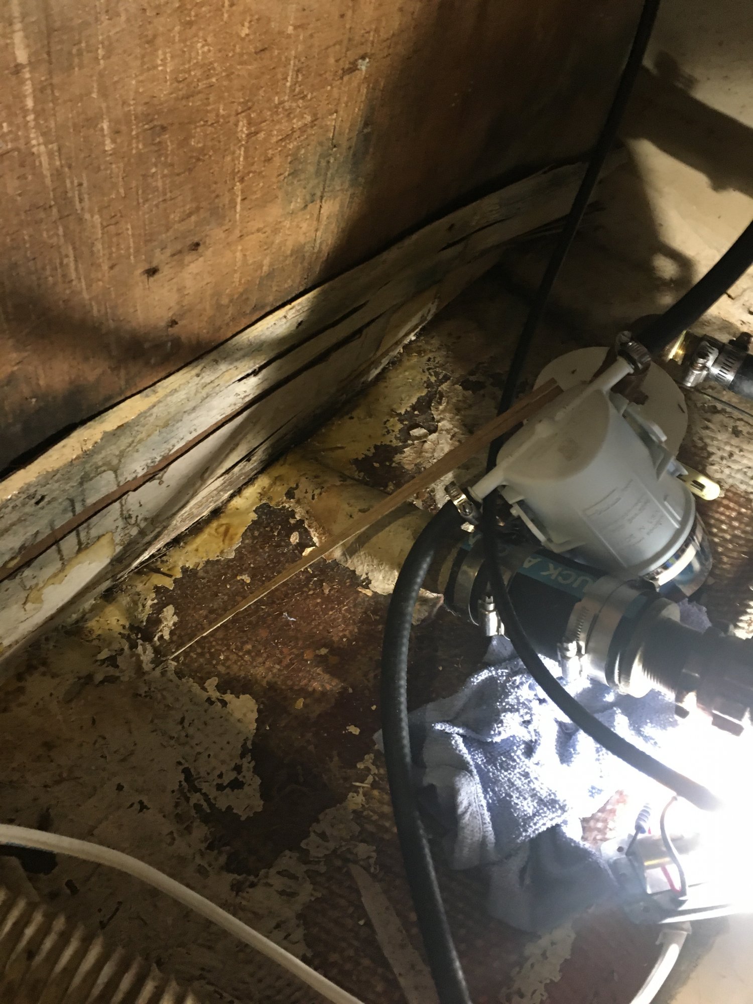

Wondering how much of the rot was caused by tank condensation.....
If you mean condensation inside the tank, then probably none. More likely corrosion was caused by water trapped between the tank exterior bottom and the base it sits on. On my old boat the original fuel tank sat on an unfinished piece of wet plywood. Leaked after forty years through small pin holes on the bottom. Best current practices consist of having plastic strips bonded to tank bottom to keep tank from resting on a wet surface.
1,385
Catalina 34 Casco Bay
Exterior sweating...
