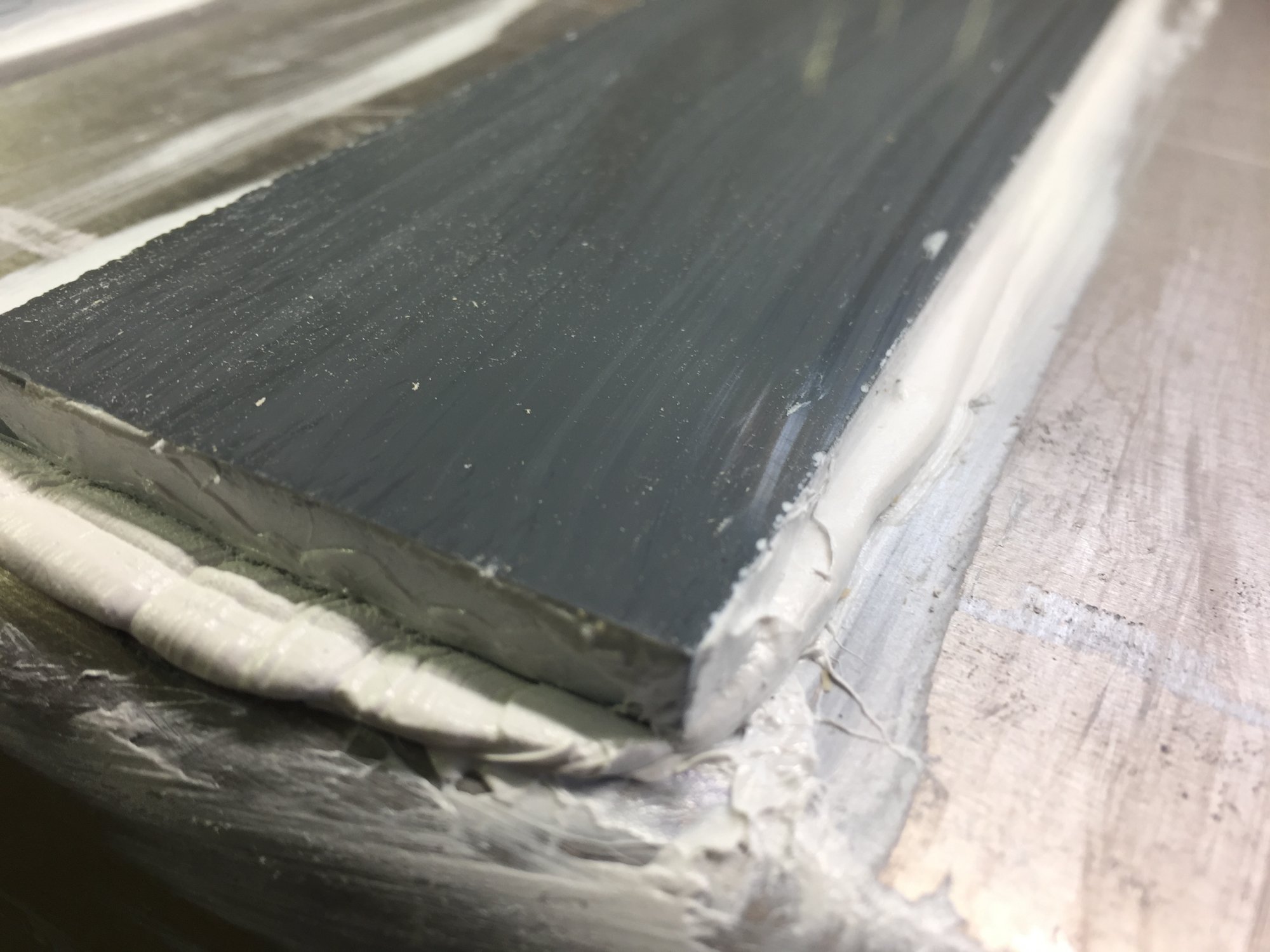

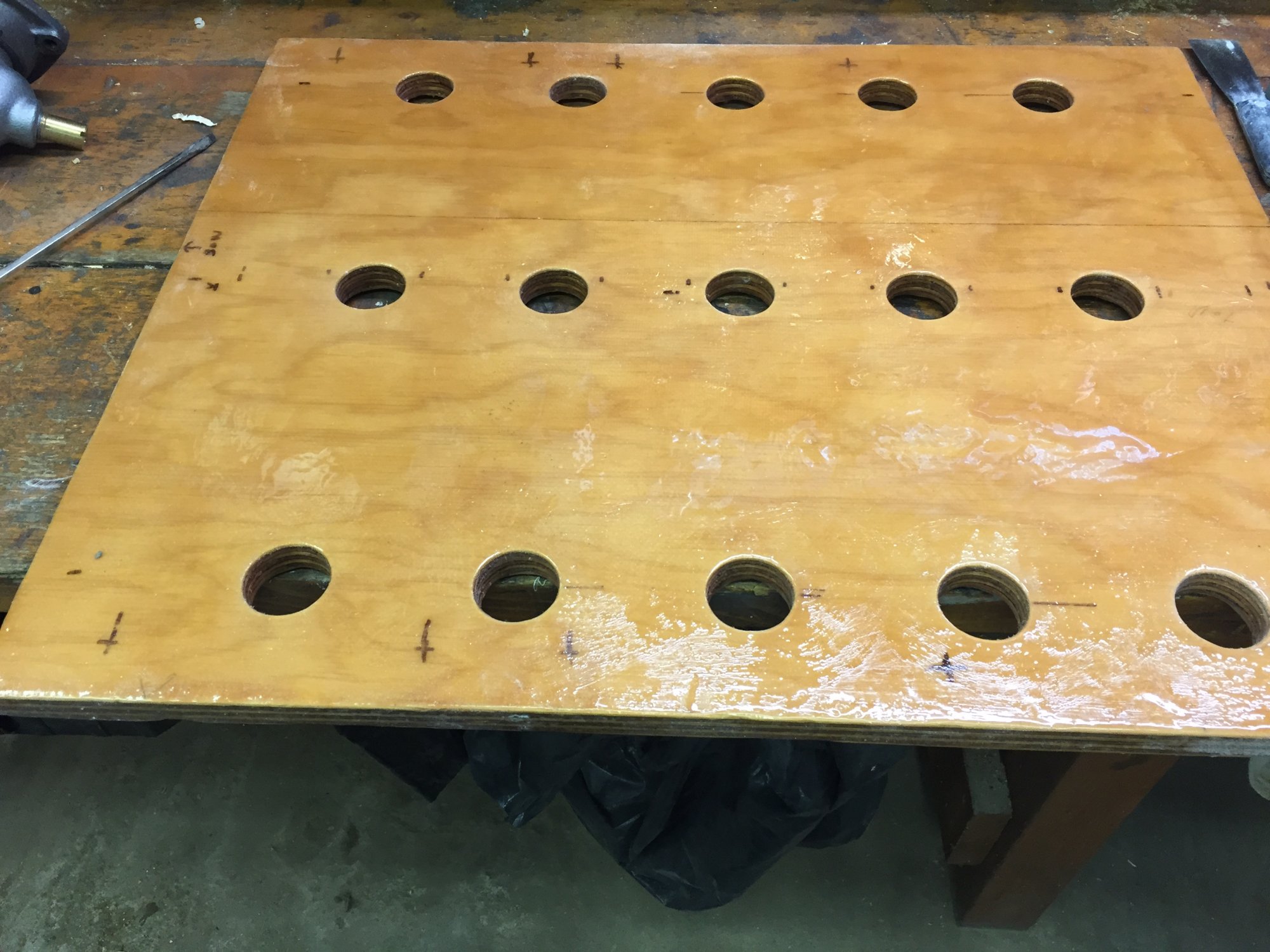

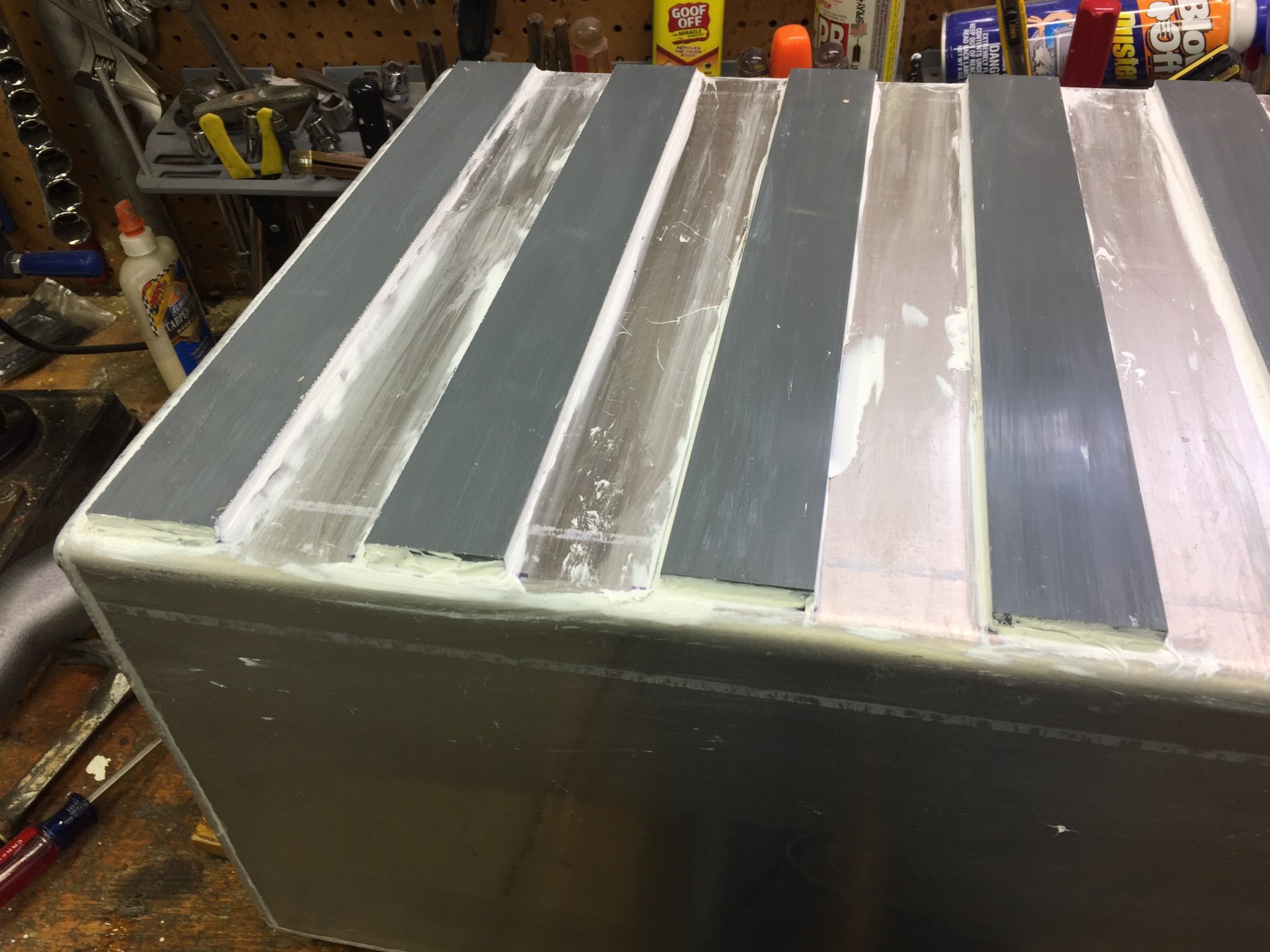

Exterior sweating could lead to the wet plywood mounting base. But the culprit for marine crevice corrosion is moisture and the lack of oxygen, which prevents the metal's (aluminum, stainless steel) surface from forming its protective layer.
RoyS
Jun 3, 2012
1,742
Exterior sweating can happen. Also, with an original propeller shaft packing assembly, water can be thrown up by the spinning shaft in front of the tank. Rudder shafts often leak and splash behind the tank. Once the tank base gets wet by whatever source it will stay wet unless it is sealed and designed to drain and it is separated from the tank bottom by bonded strips of plastic or some other equivalent arrangement. Keep in mind that even with the worst production boat practices and thinner tanks, they lasted thirty to forty years.

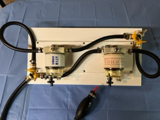

Well, A new year and a new vigor to get things done. Well, let's say, damm it's bloody cold, let me see what I can remove, take home and re think this set up. And.....da dah, here it is.
I received some private messages from this forum, thanks for that, suggesting switch valves so that if one clogs, I can easily switch to the other. Of course this makes perfect sense. It's not often I take action right away, but I do listen. Thanks for your suggestions. Eventually, I would like to hard tube it, but I'm trying to use some spare stuff I have to help fund the bigger needs (wants)
