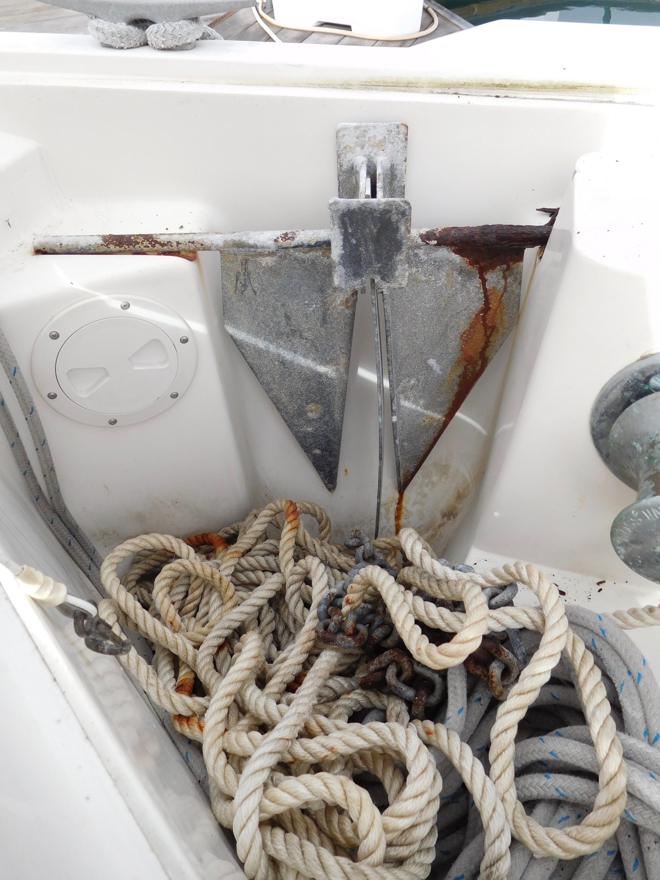

Proud new owner of a 1989 Catalina 30. During survey, the Danforth anchor was found in the chain locker, rusting-away.
So what about rust? If the main load parts are 75% of original diameter, it should be good to go! Unless the anchor is your "show piece", I would use the "good for sand" Danforth.
Note: Static rust is your friend. Rusted surfaces, that don't have the rust removed, stop rusting. Locker storage sounds like Static rust.
Jim...
PS: Anchor parts are 125% over designed for their ratings. ;) get the 75% now?
I calculate that 75% of original diameter remaining means there is only 56% of the original cross sectional area left. This translates to only 89.5% of the original rating. Is that a problem?
JamesG161
Feb 14, 2014
8,020
Hunter 430 Waveland, MS
Well pies aren't square.:p
Since chain size is the diameter of the bar stock used to make the bend, I thought for simplicity diameter but ok then ≈90% of the load cross section, instead of diameter then. Should be good to go also.
Unless...
Read "rusting-away" as disintegrating. Wish I had pics, but I don't.
Then that means that the anchor locker had water intruding , over and over, and thus not static environment.
some times is it just a few links and they can be replaced.
I like Danforth in sand and Bruce in mud.
Jim...

Here's the Danforth as I found it in the boat during the survey.
Obviously needs replacing. Hence, again, my question for the thread.
Jan 27, 2008
3,092
ODay 35 Beaufort, NC
From your pictures it doesn't look that bad. Take a wire brush to the rusty areas and then spray paint it with some galvanizing paint. Petit sells some paint in a spray can that has a high zinc content, or check around, you might be able to get it regalvanized for a reasonable price. It looks like the anchor locker is set up for a Danforth, any other brand you might have to figure on how to mount it on a bow roller or rail or deck mount. You should have a backup anyway for emergency situations. Defender often has really good deals on Lewmar claw anchors, check out their clearance section. They currently list a 22 pound claw for 45 bucks. You won't find a better deal even at a consignment shop probably, but the shipping might be outrageous. If you can go to their store and pick it up it is a great deal.
Here's a spray can for cold galvanizing said to be for old rusty anchors and other metals. http://www.defender.com/product.jsp?path=-1|2200442|2200456&id=2021857

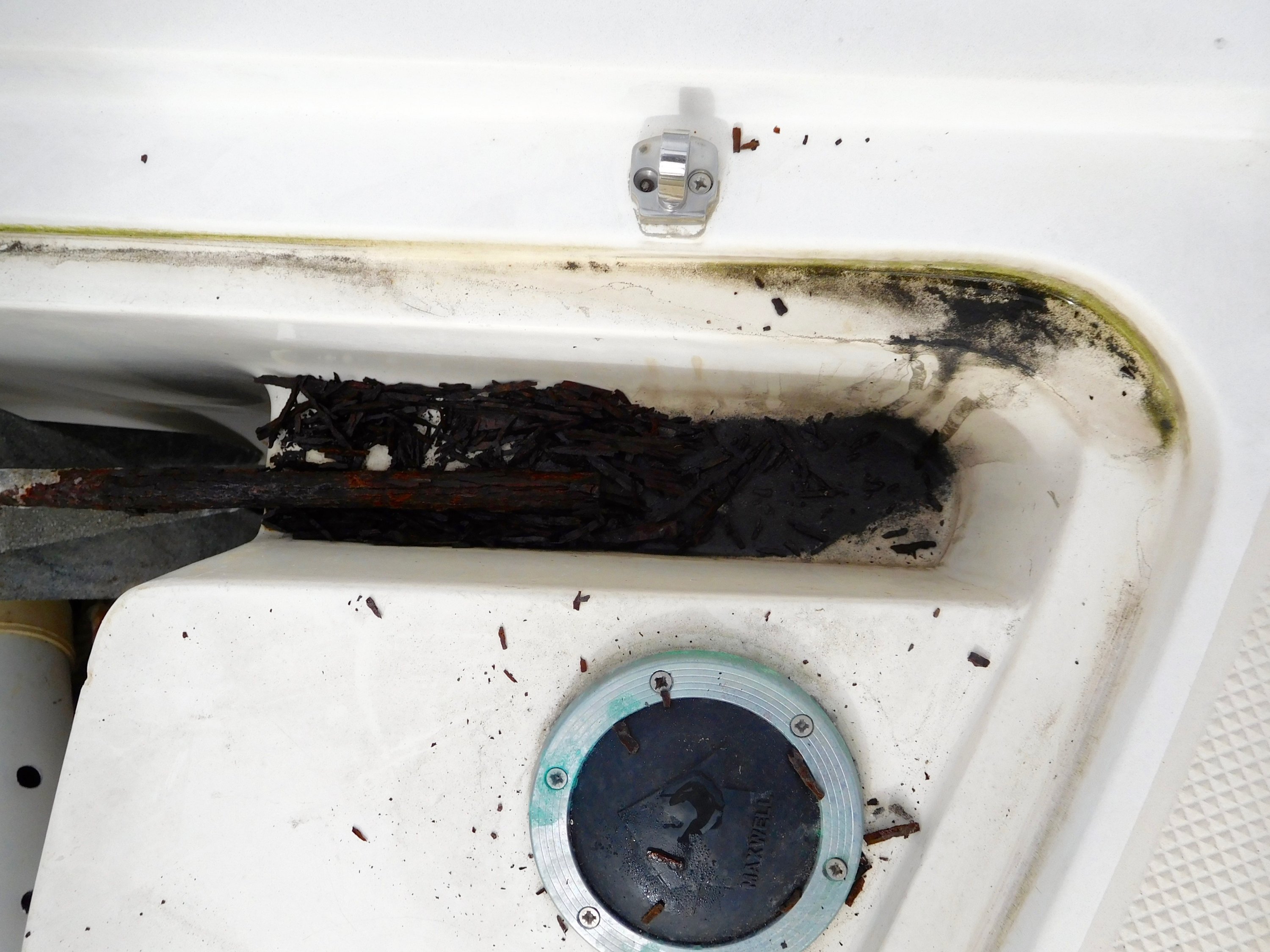

Please note the reason for continued Iron corrosion in your 1st picture x0193. The upper right shows the water path from deck to the chain locker. This continued (non static) bathing will happen to a new chain if you can't prevent bathing the anchor/chain. You might just shift the chain more aft. There should be a locker drain, perhaps it is plugged.
Jim...
Already on it, Jim. Thanks.
I just took possession of the boat two weeks ago. The previous owner left everything as is. I have a lot of cleaning-up to do, as the boat saw little use (though regular maintenance and engine starts) over the last couple of years.
The anchor will be replaced. I'm not a "good 'nuff" kinda sort when it comes to safety. Why incur thousands of dollars in damage repair over a few hundred dollar anchor and rode?
