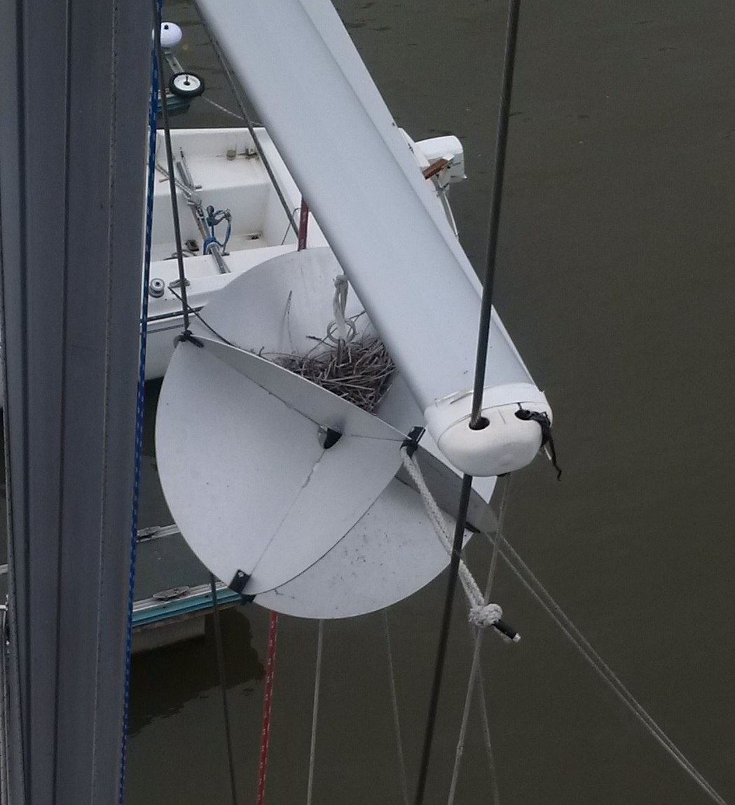

The Davis Echomaster manual details specifically how to rig the device with blocks and and a tether to the lower shroud. Mine has been installed year-round at the first spreader for more than 5 years, through gales and summer sun.
Ditto. Cheap insurance and pretty much trouble free except for the time a bird tried to nest in it
