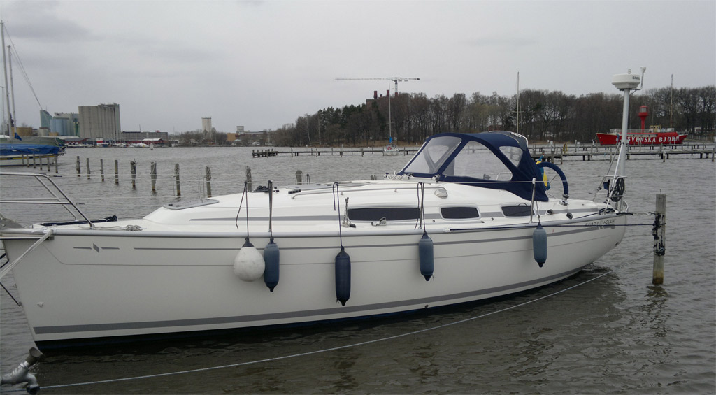

My Davis aluminum radar reflector goes up in restricted visibility, namely when in fog or when out at night; otherwise, it's in the stb cockpit locker. I hoist it to the height of the upper spreader where there is a block. Takes only a few minutes. I don't like to leave it up hanging from a halyard b/c that line will chaff through eventually and the reflector will come down--hard. I also doubt it would last long up there in rough conditions of shorter duration for the same reason. I've been wishing to change to wire for the section near the ring on the reflector that goes through the block, but that requires a rope-wire splice that I'd have to pay to have done. I frankly do not have much confidence in their ability to significantly improve detection but I put it up for prudence. I've not had much luck hailing vessels without knowing the name.
