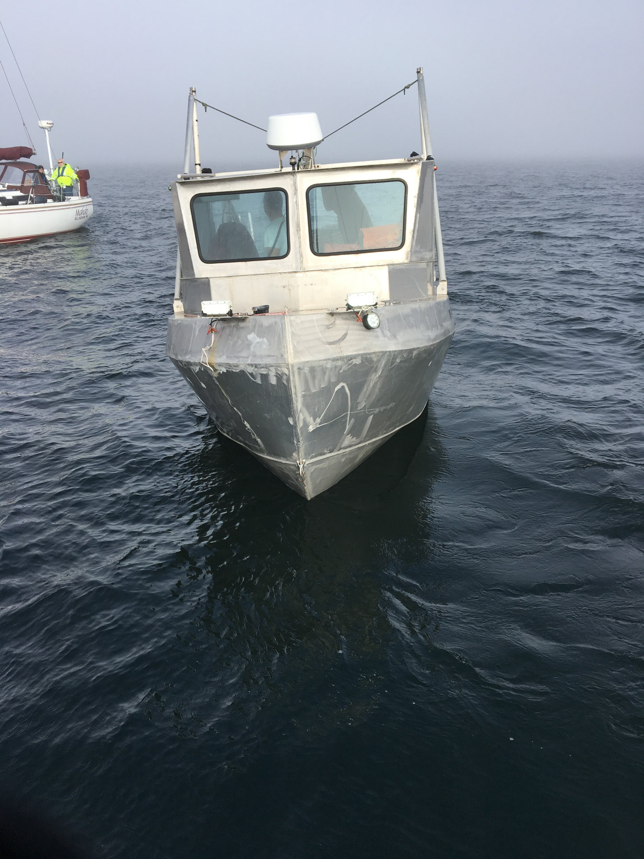

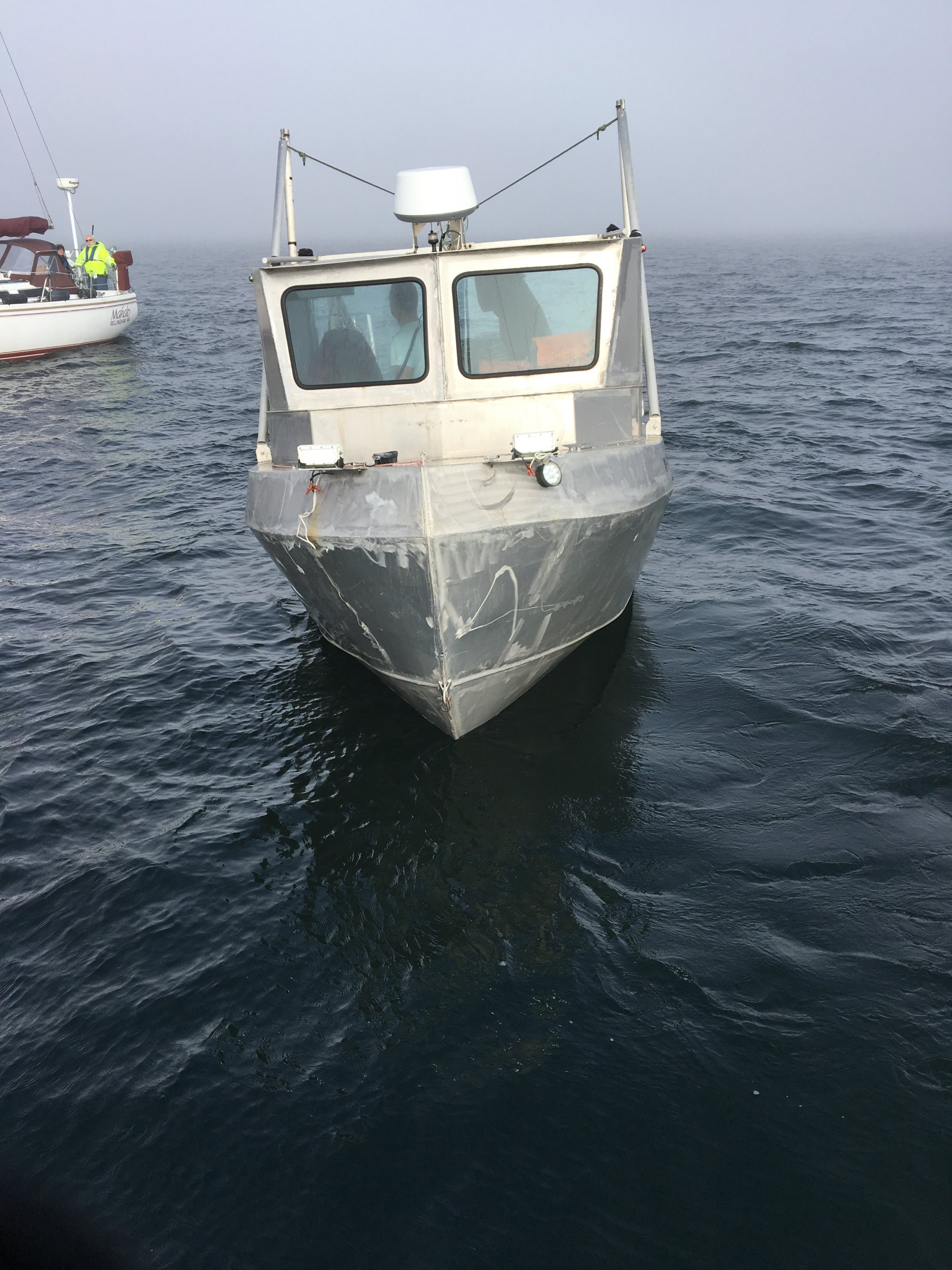

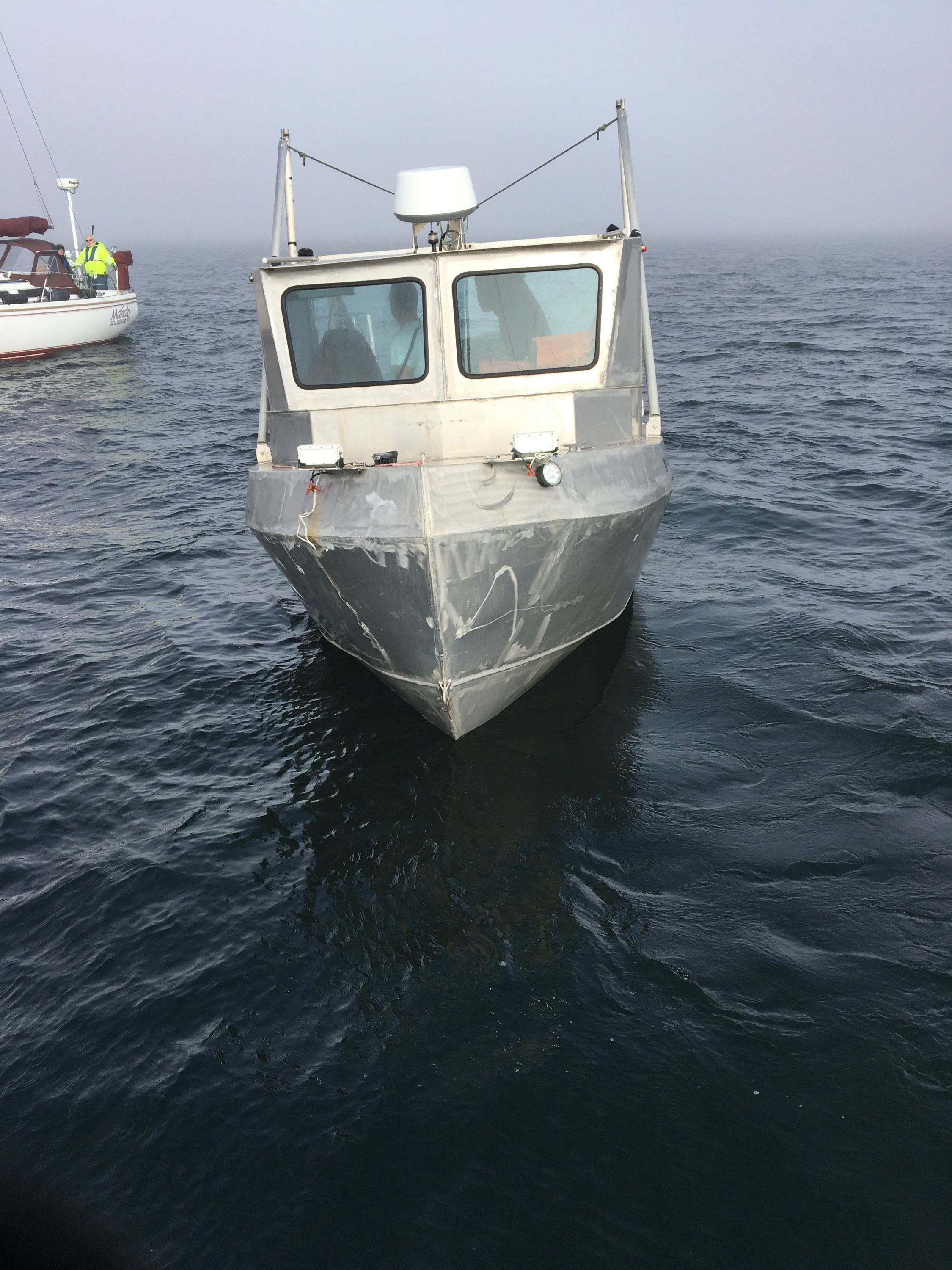

I am of the trend to have all the tools that can help. AIS, radar, and a radar reflector. In my May 2017 adventure none of it helped. The boat did not have AIS. The radar signature was too small and the speed of the fishing boat did not yield a good track able reflection (30 plus mph in fog 50-100 yards visibility). The boats surface was all metal and side on would have made for a good reflection. Head on the sharp angles deflected signal angularly away from the boat.

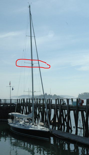

We have a Lensref mounted on the forward side of the mast and protected by a SS "hoop" from lines and the sales snagging it.
