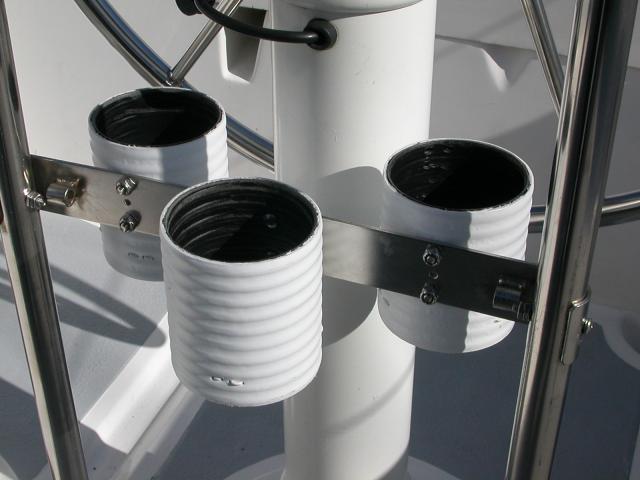

Picture shows my DIY cup holders mounted within the pedestal's grab rail on the fitting that I also can attach the cockpit table. The cup holder location is convenient for the helmsman and passengers sitting on the side lazerettes. Also they are not in the way of anybody moving around.

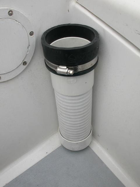

Also while I'm at it, also attached is a pic of a "matching" winch handle holder.
The tubing for both is 3" pvc drain pipe with the white plastic coating. I've got enough of the pipe still in my garage to make a dozen more holders. The 3" size is perfect for 12oz aluminum cans and smaller styrofoam cups; but not large enough for coffee mugs. So, if I were to do it again, I might use 4" solid white pvc pipe. And round off the edges for a more polished looked.
The rubber collar on the top of the winch handle holder is to absorb the shock of dropping the handle into it.
