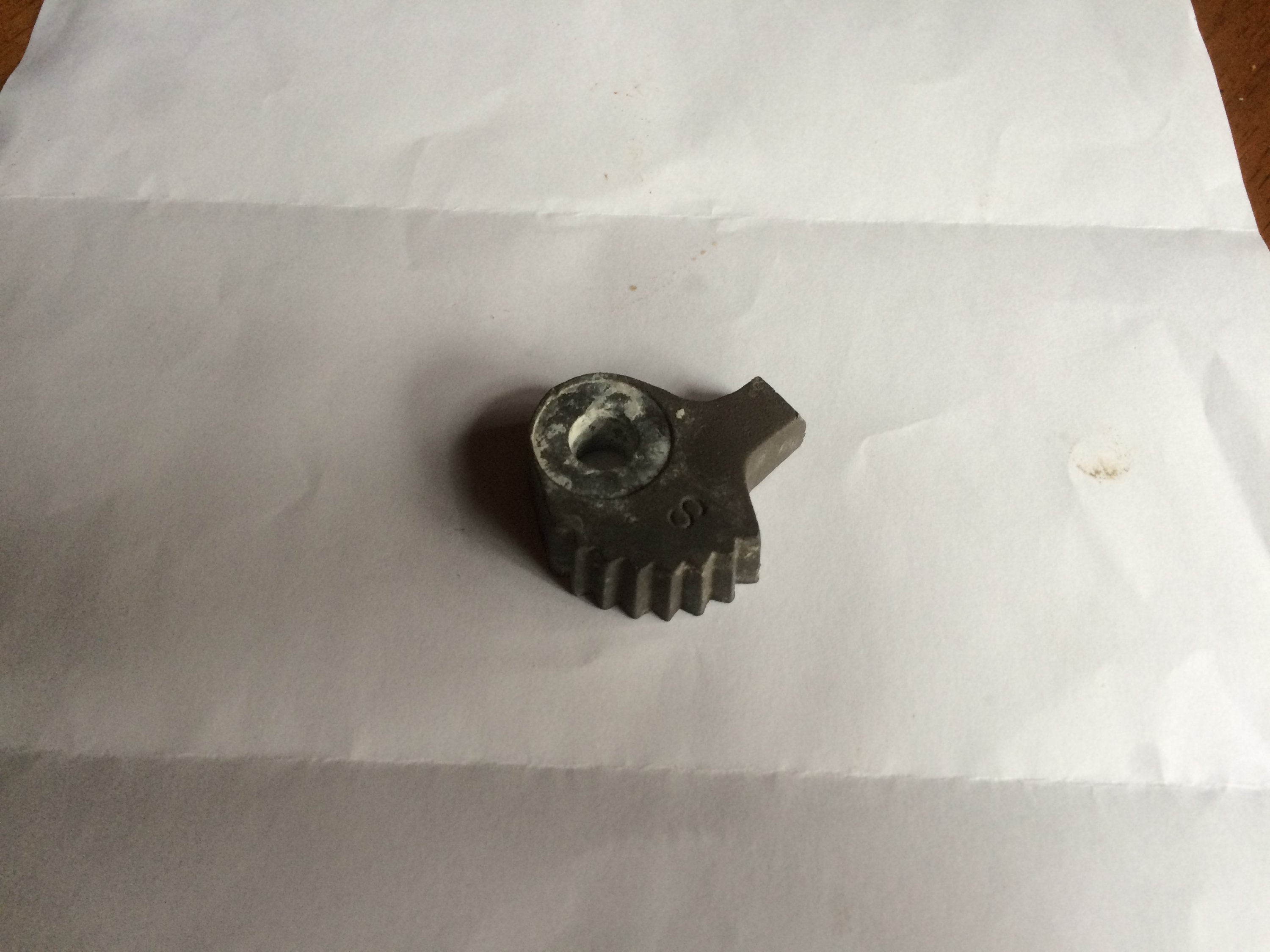

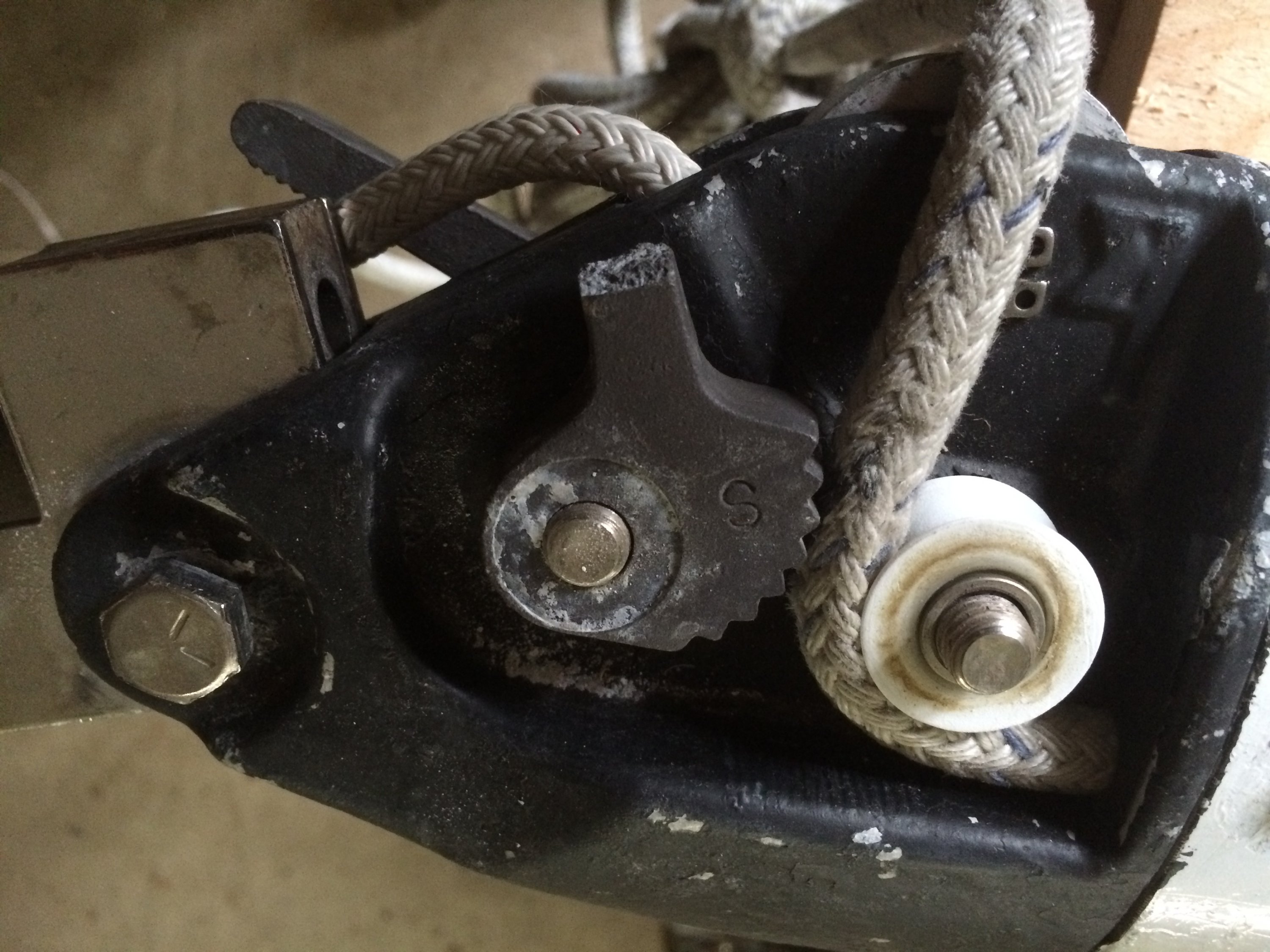

I have a 1984 Hunter 27 I need the Reefing/Outhaul Line jamb on the Starboard side of the boom. I would assume that this part would be common across the Hunter line, but I've been wrong before. The salvage yards I contacted are not willing to part out the boom. Anyone one know of one that will? I've been told by a welder that it was a White metal casting and could not be welded. I suppose last resort would be to machine one out of solid stock aluminum. One pic is of the piece removed the other is of it in place

Since that is the operating handle, you could grind the break flat and drill/tap the flat end.. then screw a stainless stud into that then carve a little handle with a hole through the center .. slide the handle over the stud put a nut on the end and ya done..

DAMCo (Dwyer Aluminum Mast Co) have replacements for that for much less than Rig-Rite will have. They're great folks with a great online catalogue. Their DM-375 boom corresponds to the Kenyon D which is common to many boats including our H27s and H25s (https://www.dwyermast.com/items.asp?cat1ID=30&cat1Name=Booms&familyID=6&familyName=DM-375+Boom).
I nearly bought one of these but elected, at least for the present, to customize and re-rig and re-use my original boom. In some ways it's more fun that way (and also cheaper ;)).

That looks an awful lot like the gooseneck on my old 1979 J24, since sold off. If you have any old j/24's in the yard that are "parts Boats", you might be able to find a boom or gooseneck with that part on it. Come to think of it, I think we took those jaws off the J/24 because we rigged the outhaul to a cleat on the boom and removed all the reefing gear. I may have them in my spare parts box. I'll do some checking and post later. Looked in the spares boxes and no luck.

I think I have your part and others. I scrapped several Hunter 25 and seems like many of the booms had that cam. Let me know if you still need it. I am in S.E. Mass and have tons of parts.
