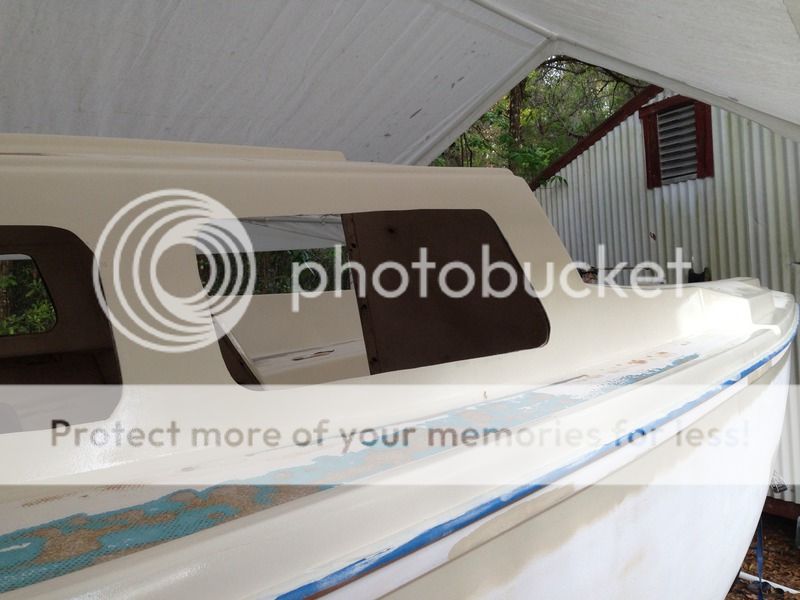

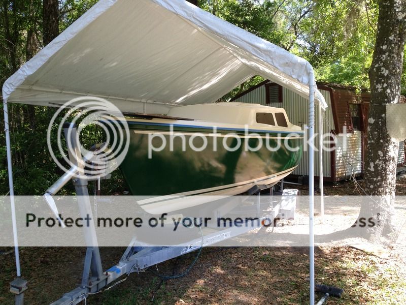

I have always used quality paints on my projects in the past (PPG for auto or Awlgrip/awlcraft for boats)... I decided to cheap out on this one since this was supposed to be a budget resto. I am using rustoleum marine topsides paint and rolling it. research indicates that just rolling results in a better finish than rolling and tipping with this particular paint. well... I am not happy. you have to wait 24 hrs before the next coat, sand with 220 then re-coat. I just finished the 3rd coat and feel like I need at least one more. and its got a decent amount of orange peel!! I am wishing now I would have used a better paint (even automotive) and sprayed it... live and learn right?

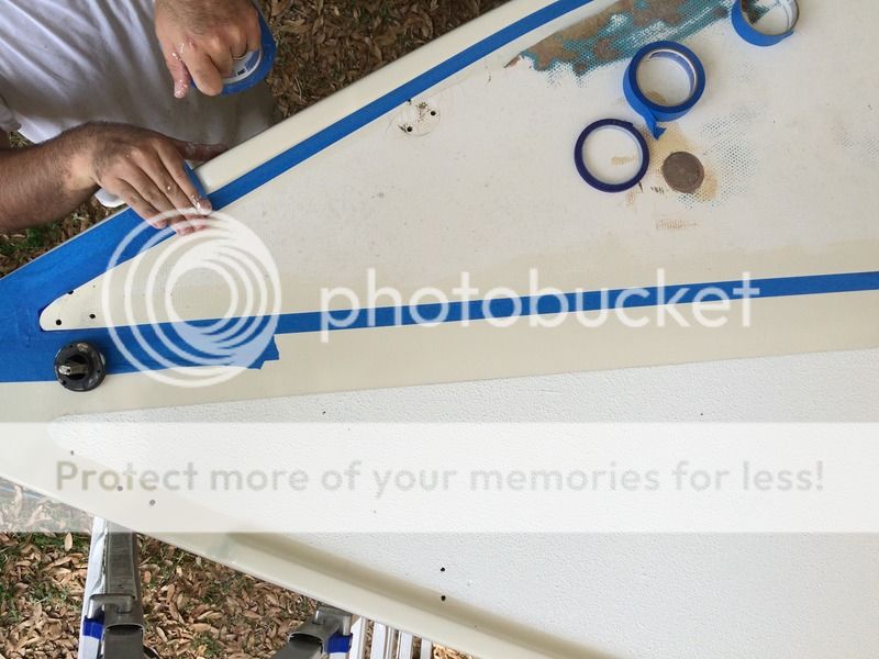

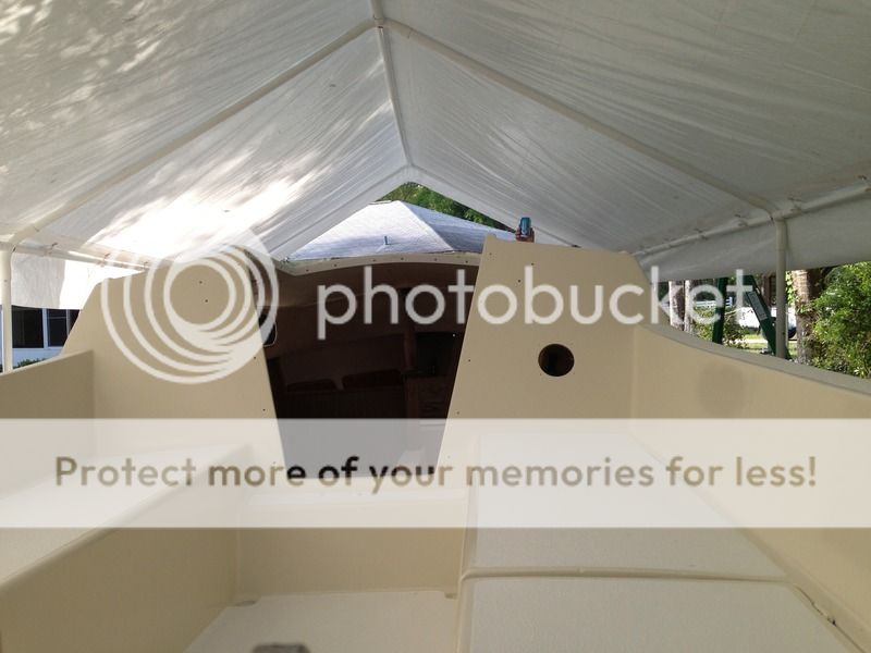

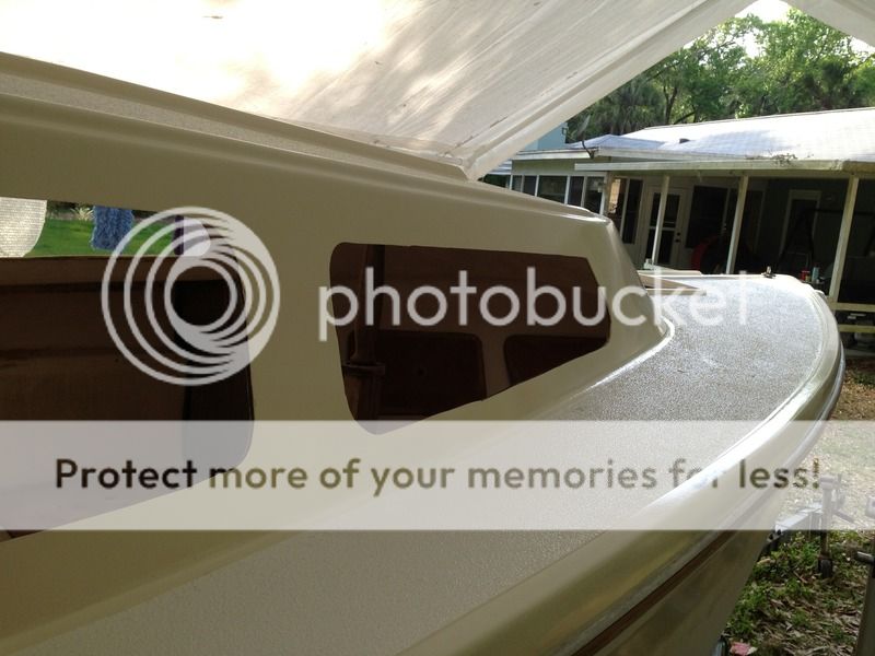

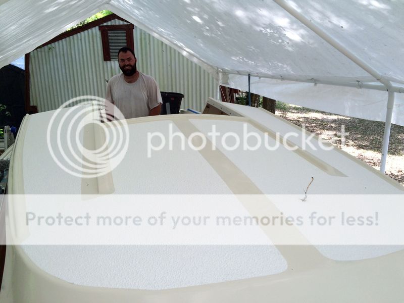

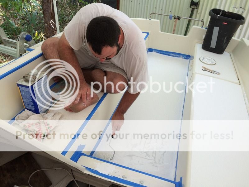

spent yesterday masking and kiwigripping. This is the step where it finally hit home that it is coming together!! Thanks to Gene for helping me get it all down (its VERY easy to apply but it is REALLY nice to have someone spreading and someone rolling behind).
roll roll roll your grip...
gene caught me not working... I was admiring the cabin top!!
Sep 30, 2013
3,719
That really was fun, watching the boat come alive a little more with every passing hour. Too bad every day's work doesn't provide that level of gratification!!

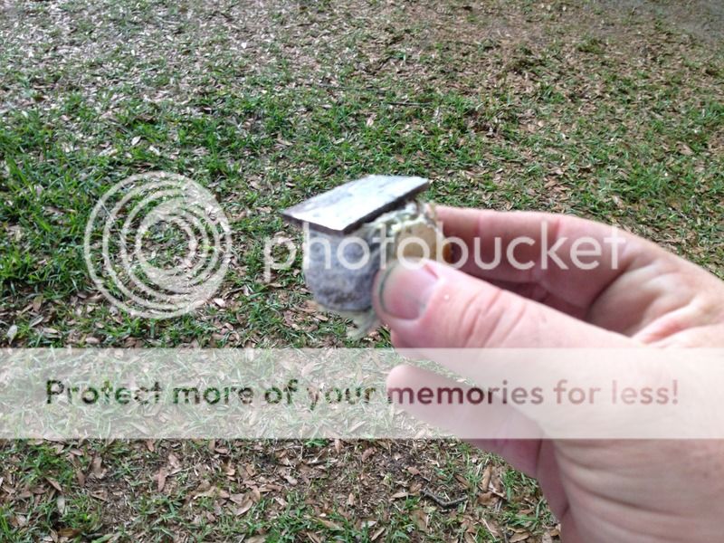

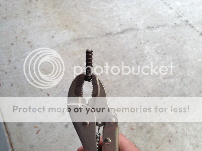

well today may, arguably, be the happiest day in the resto so far!! the main cause of this entire rebuild was solved... after 2 months of alternating my home brew of penetrating oil and pb blaster I tried the stbd broken keel bolt again. I thought I was hallucinating when the vise grips moved!!!
of course I still have the port one to deal with but it doesn't require any cosmetic glass work. this just sped up the interior work considerably!!!!

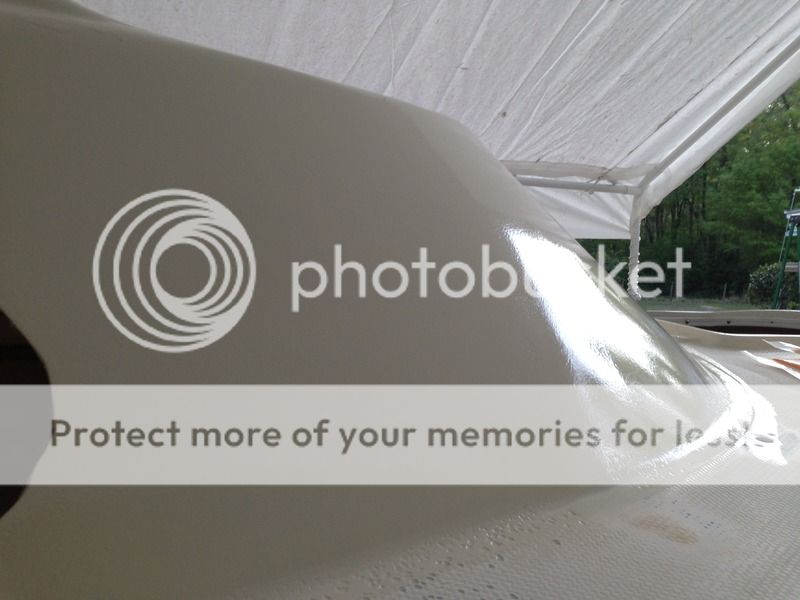

well over the past couple of a days a decent amount has been done. I drilled and tapped the keel the covered all bare metal with thickened epoxy. now all I have to do is finish shaping it and it will be ready for paint

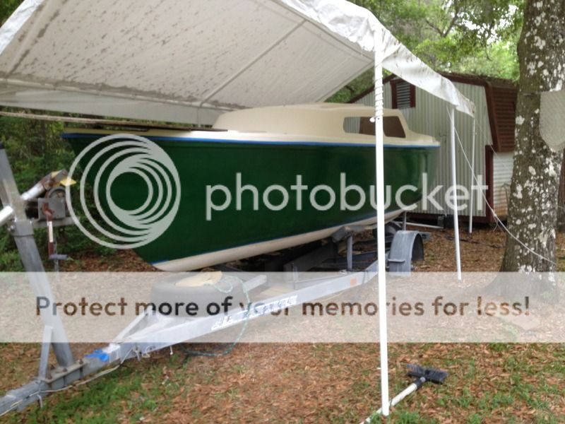

then I painted the hull. today was the second coat.
Apr 1, 2010
398
Cal 33 and Sea Pearl 21 . Crystal River, FL

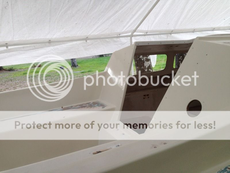

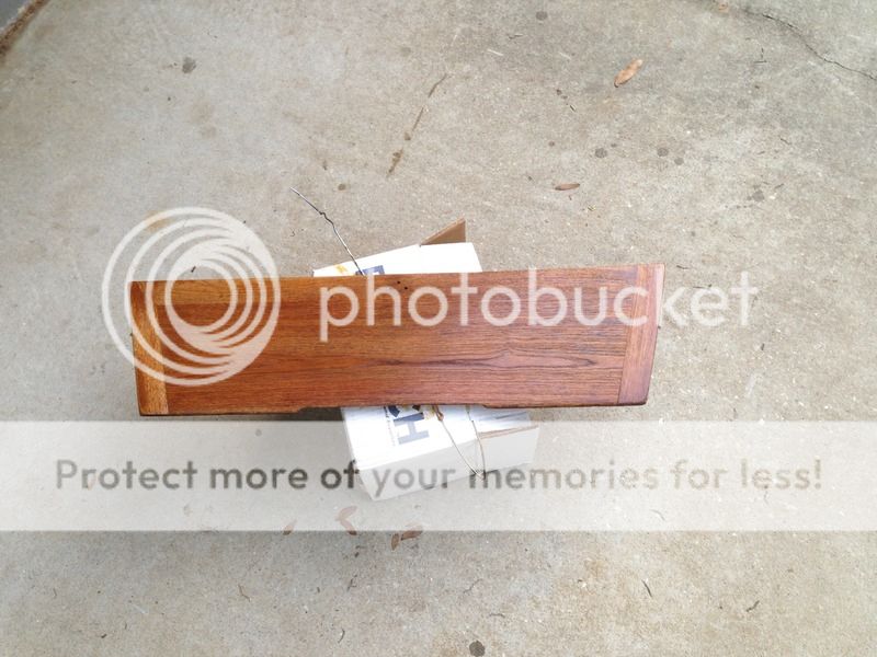

finished painting the exterior this weekend. then I fiberglassed over some of the holes in the cabin that I will not be using anymore and scrubbed all of the teak down thoroughly. today I sanded the teak and put the first coat of cetol natural teak on. tomorrow I will be putting on the second coat and probably start fairing the problem areas in the cabin....

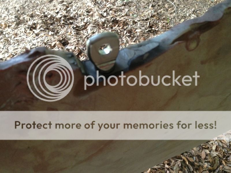

well what an interesting day... a typical "day in the life of david" kind of day...

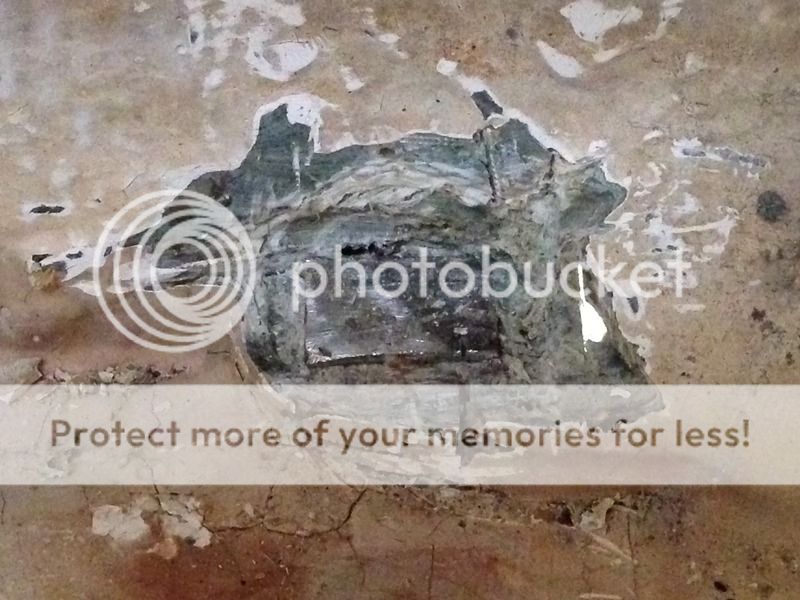

all started well with exposing the weldment

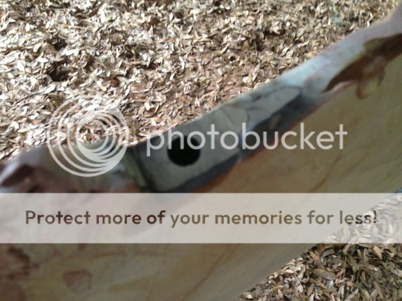

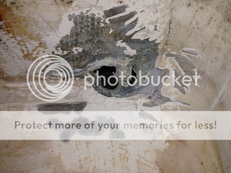

I try to drive it through from the bottom with a hammer punch with no luck, move on to an air chisel, still no luck. finally get to working from the inside and get the weldment out. problem is, the weldment isn't all that I got out
which resulted in this
I don't know if it is clear in the pics but I believe that what I removed was a repair that was done previously. there were glass strands mixed in to make a thickend type resin but there were not ANY layers of glass along the bottom, which would be the hull of the boat.
for the repair, I have already ground/tapered the area. I am going to line the back of the old hangers with wax paper then start layering in biax starting just larger than the hole and gradually working up to about a 6x6 patch. I am planning on roughly 10 layers and hoping for a thickness between 1/4 and 3/8" of solid glass to hold the new weldment in position.
it ALWAYS something!! one step forward, two steps back!!!
