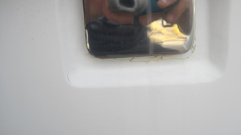

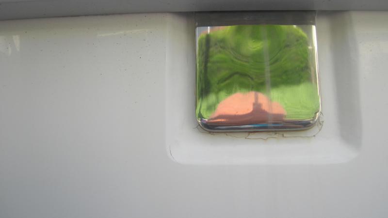

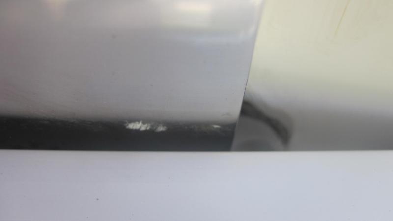

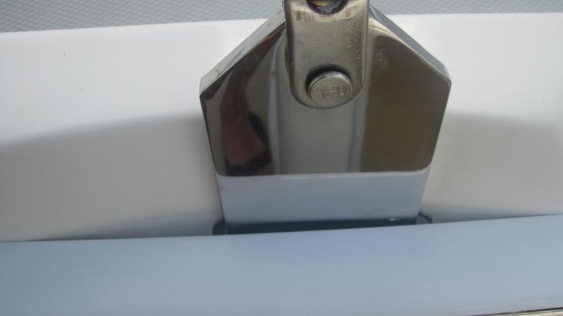

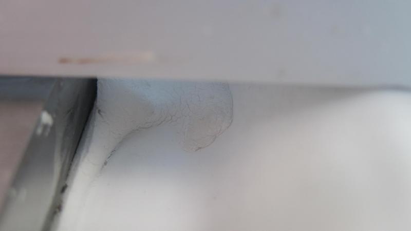

OK here is what I am talking about and hopefully will start removing
the old 5200 with a heavy screw driver and have one of those small dremels.
I only really have one side that is leaking and only just found the minor leak when cleaning off the shelf where my wife store her kitchen stuff,but I will
re do both sides at the same time.
The stainless plate is bolted with 3 bolts on the inside and being such a minor leak after all these years the boat is a 2007 so not bad that I need to redo the plate now.
nick
