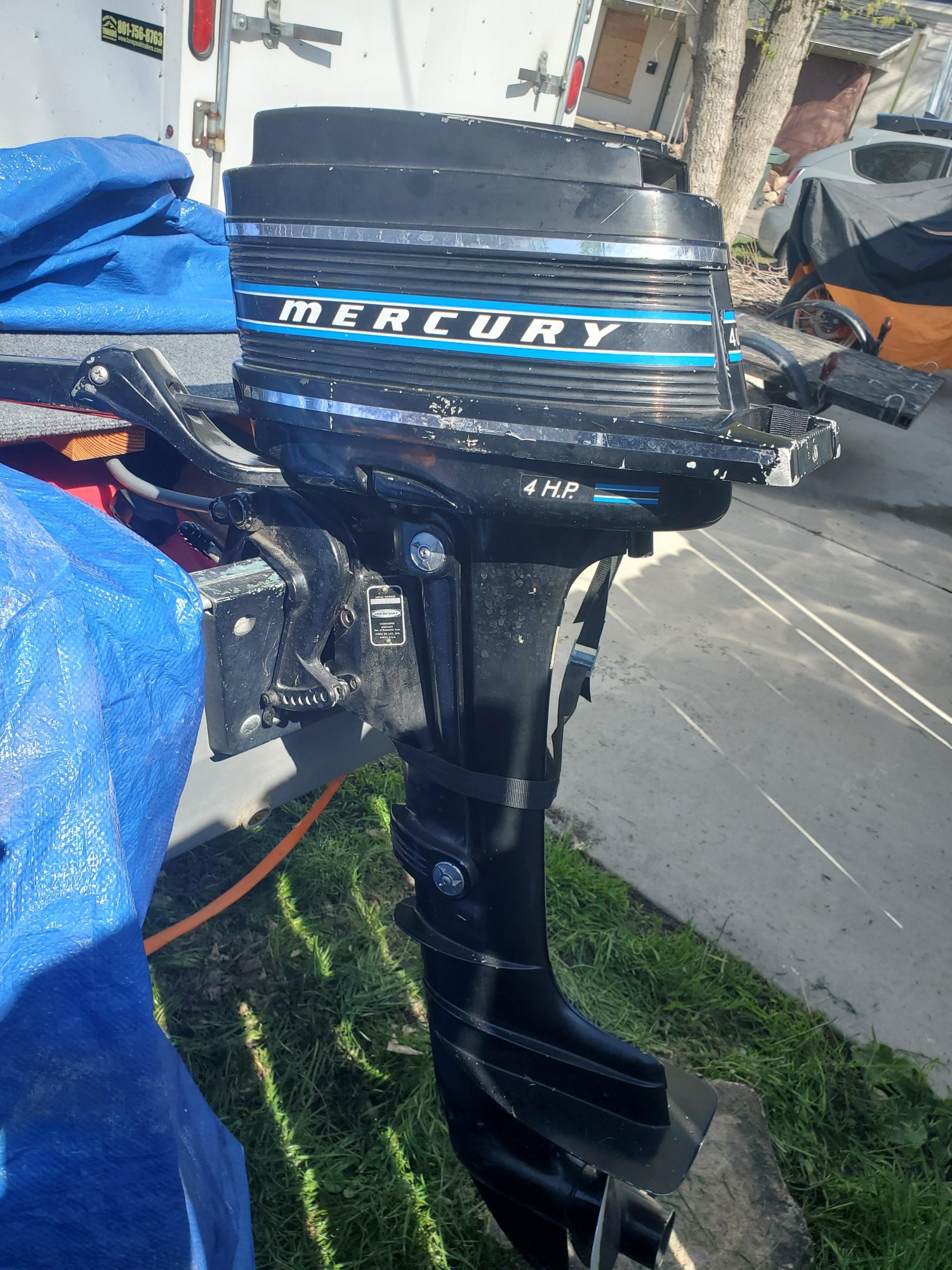

Hello,
New to Outboards and don't want to do something dumb. This motor was said to still run good. But hasn't been run for 5 years. What are the first steps and what not to do? 1973 (ish) Mercury 4hp outboard. Came with my 1971 Catalina 22.
I know I need to get good gas...
1. But do I have to drain any old gas inside?
2. Think mix is supposed to be 50:1.... what kind oil do I buy?
3. What kind of gas? Ethanol free? premium or anything from the gas station?
I have a barrel I can fill with water to run it in.
4. Any risk to damage it...should I test to see if its not "seized"..
5. I see lot people taking spark plug off and spraying some kind oil into it. Necessary? If so what kind oil?
6. Should I loosen the bottom "gear" oil nut to see if the oil is black/creamy/clear/ or even empty?
7. its definitely a 2 cylinder, right?
Any other info greatly appreciated. I basically know nothing so clear and specific steps and products would be great!!!
