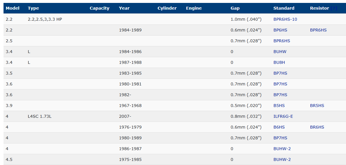

4. Does it need a specific spark plug?

4. Does it need a specific spark plug? - Just match the one that you take out. There should be a designation on the side. Could be an old number but it's usually easy to find a modern equivalent.

How do I know which plug to get?

There are several ways to know which plug to buy, it should be in the manual, it may be on a sticker on the engine or inside the cover, and it it printed on the plug. Auto parts stores will have a cross reference chart for the different brands.
