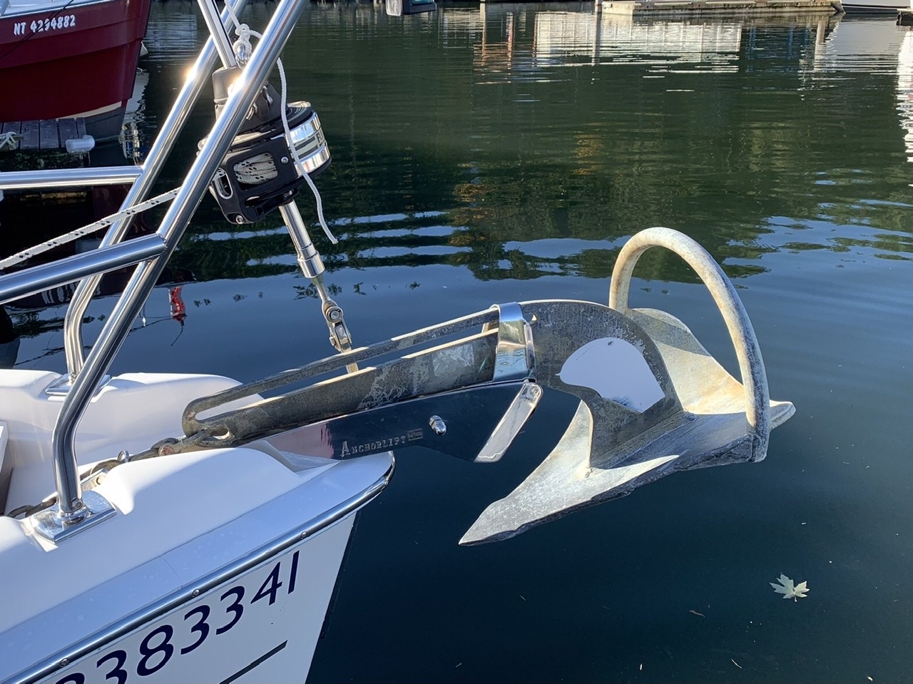

In any case, back to the original question, the Danforth probably would fit better in that roller than a plow style, so if you anchor in places where a Danforth is effective it might be worth considering.

There is a reason they are called plow anchors. I am referring to CQRs here. It does not take a close inspection to determine that plow anchors were designed after farm plows. If you look around your marina at those boats still clinging to CQR anchors, you may notice how large they are relative to boat size. This is probably because after a CQR unexpectedly drags (plows) current wisdom in plow anchor world is to get a bigger one. Then you find you need a windlass to lift the beast, then more batteries for the windlass, then bigger battery chargers and alternators. IMHO you would be better served by buying a scoop type anchor sized for your boat based on manufacturer's suggestions. There are many choices of manufacturers of scoop type anchors. The near vertical stem on new boat designs will be an anchor interference problem no matter which type anchor you have. Bigger and heavier anchors will only exacerbate the interference problem.
