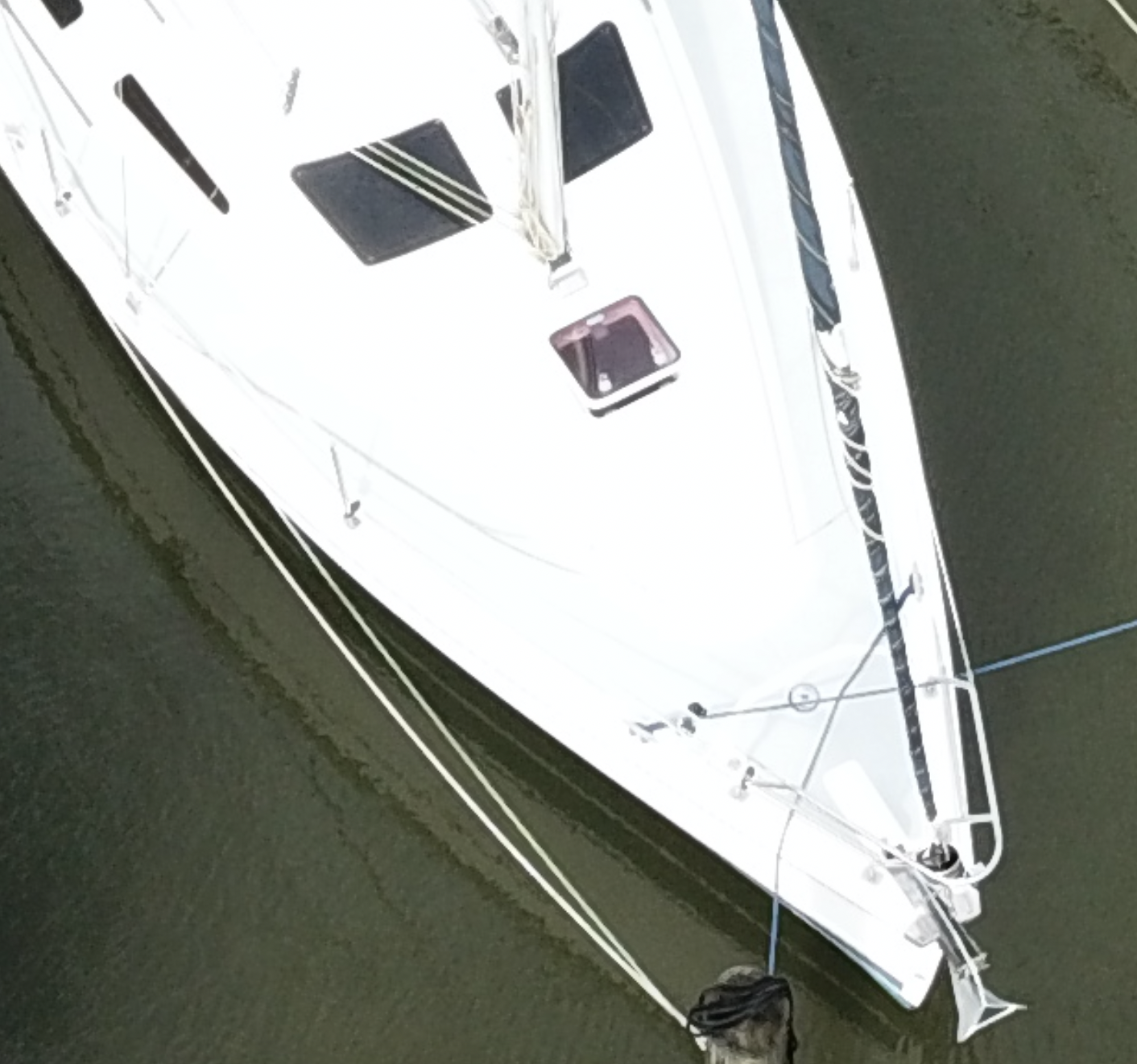

I have a 2005 Hunter 33 and replaced the Danforth with a Delta spade anchor, 22lbs. I kind of wish I had gone up to the 35lb however the salesperson at West Marine talked me out of it. The 22lbs is rated for boats 25'-41' so we are right in the middle. We sail in the lower Chesapeake with mostly sandy/muddy bottom and have never had a problem setting or holding us nicely in place. It works well on the stock roller and windlass. I'm pleased with it overall but would have only considered larger for overnight on the hook I suppose. Sorry I don't have a better picture.
23,932
Two Sails, it is size but also it is displacement.
I agree with you that a 35 would help you sleep with less tension. Perhaps there is a boat owner with a 20 something boat who would love to buy your 22lb anchor. That would give you seed money for the anchor you really desire.
