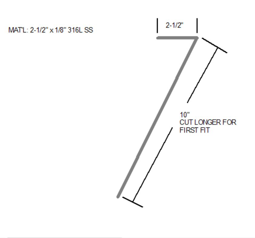

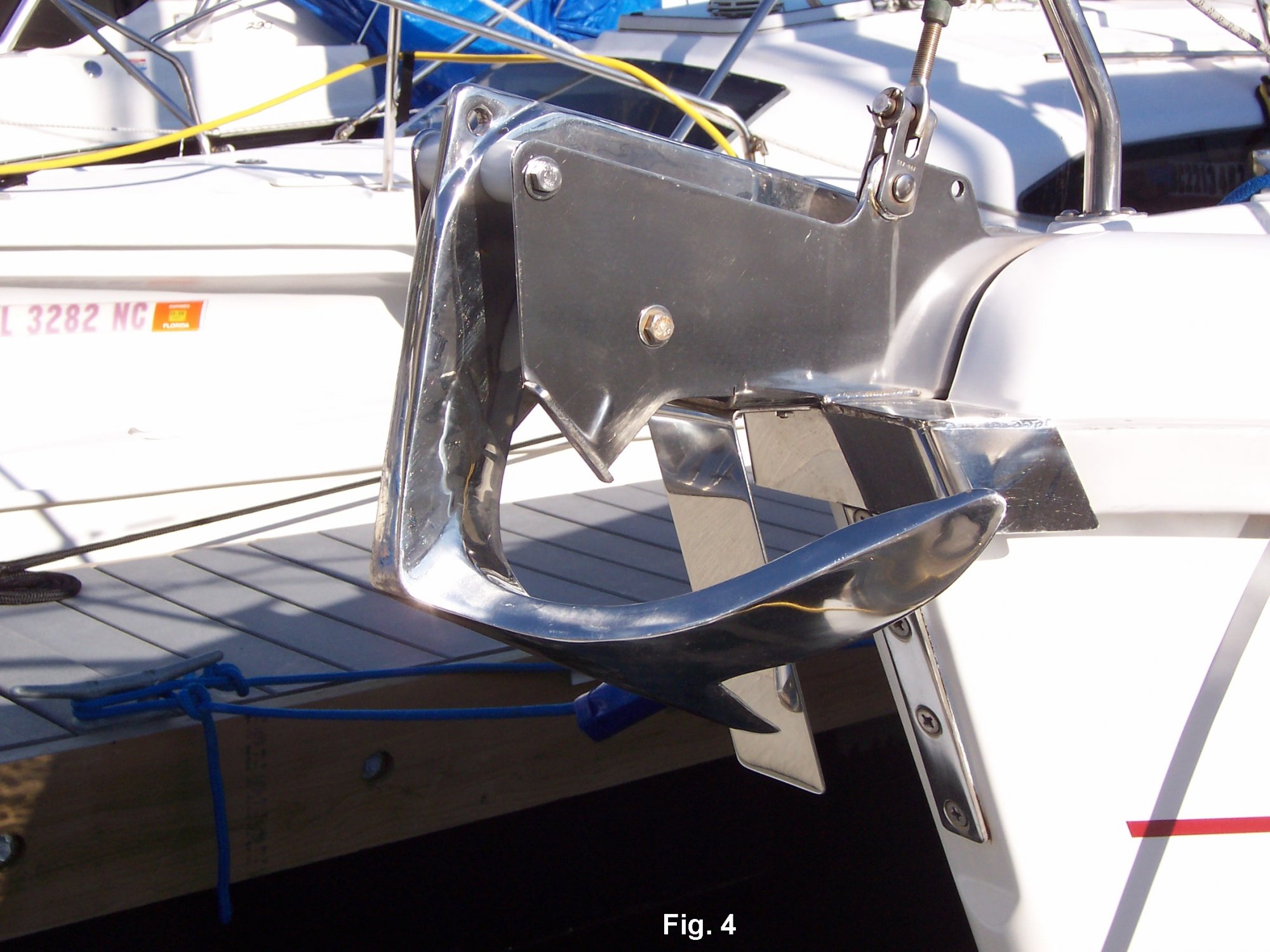

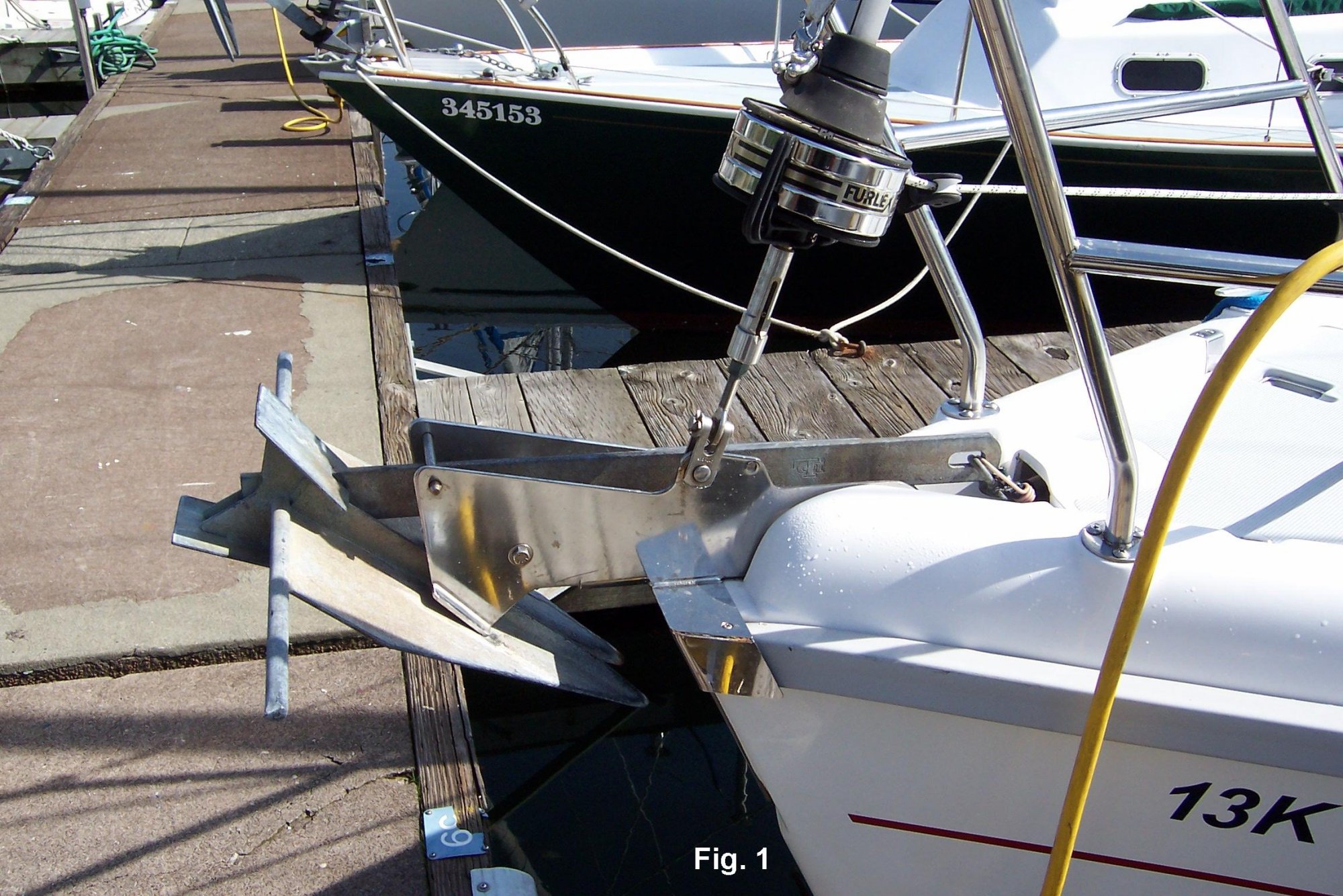

I changed over to a claw anchor (vastly superior) but then I found I was hitting the FG bow when I deploy. The solution to this was to fabricate and mount a deflection plate as shown:
This is the original setup and no hitting of the bow:
This shows the claw anchor and deflection plate:
Without seeing what is currently installed, perhaps you can sell your client on having you fab a deflection plate for him and then he can decide what is the best anchor for his area of useage.
The top is hot bent, hence the need for "L" SS or it will corrode severely given it's location. The 2-1/2" piece is bolted to the underside of the existing anchor mount with four 1/8" machine screws.

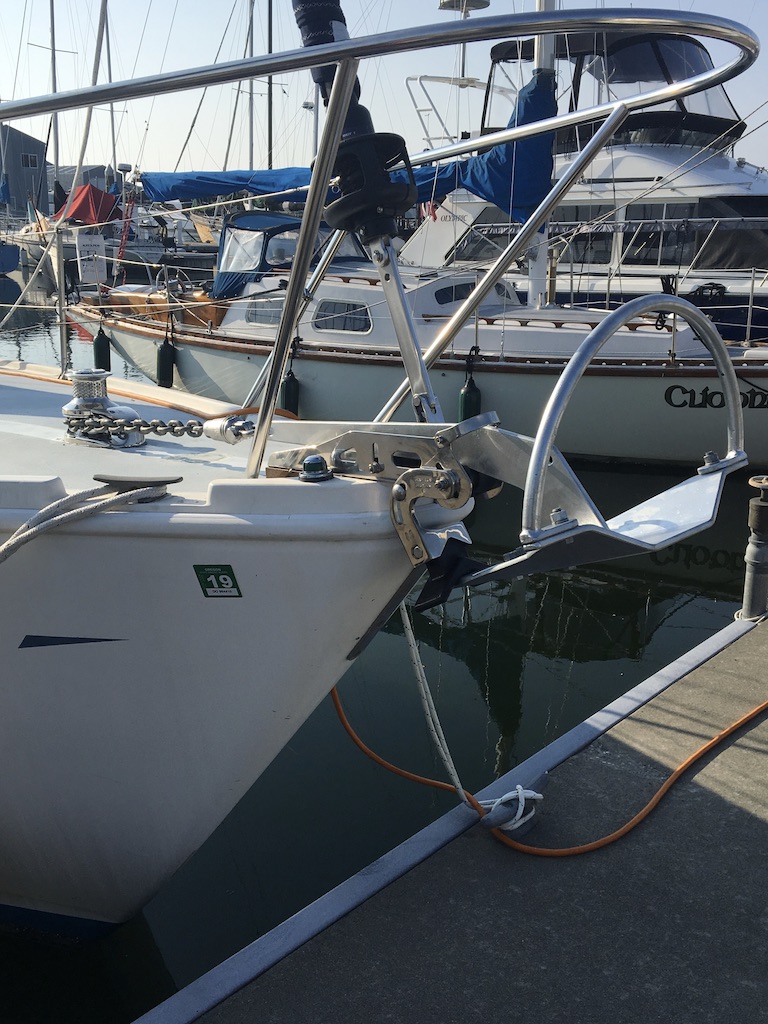

I have a dog in this fight... I bought a 35 lb Mantus anchor because of it's design features and holding power. I then bought a Mantus Bow Roller because of it's length and structure to attach to my boat.
And to solve the issue of keeping the anchor from "tipping" the bow of the boat, I installed an "Anchor Guard". The anchor retrieves up onto the roller and the anchor tip snuggles into the Anchor Guard, keeping the bow of the boat from getting dinged and chipped.
The bow of SV Hadley

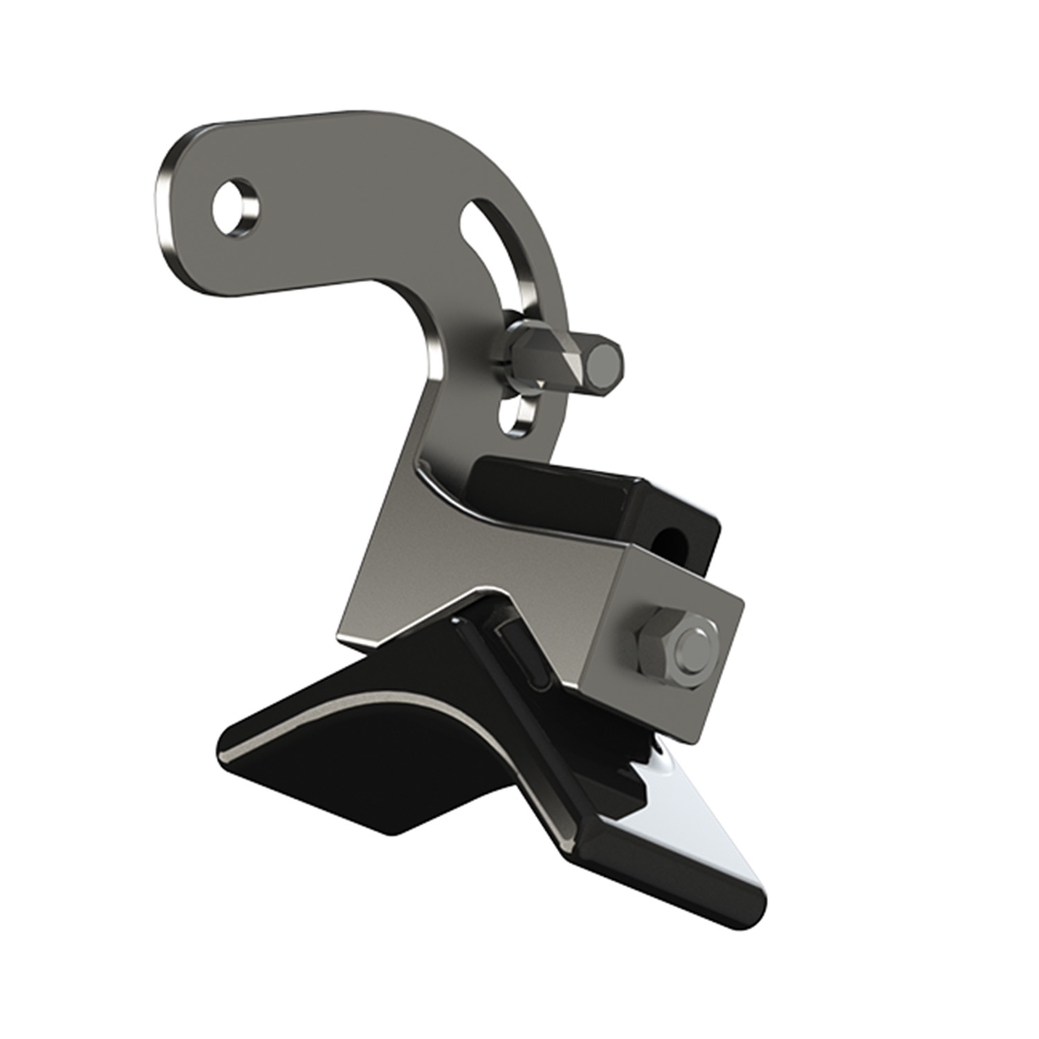

@geoffreykwright, make/model and a picture of the current bow roller would go a long way in the members providing sensible advice. FWIW I have an Anchor Lift bow roller with a Manson Supreme anchor - 35 lbs. I do have to take care when the anchor swings and rotates into position as I bring it up and into the bow roller. My H33 is a tad newer thus the bow is a little more plumb than the 2005 but knock on wood no gel coat chips . . . yet. I have had very good success (luck) with the Manson holding but if shopping today I would seriously look at a Sarca Excel anchor - 16kg (Anchor Right) or maybe even a Kingston Anchor - 35 lbs manufactured in your own backyard would fit the bill.
