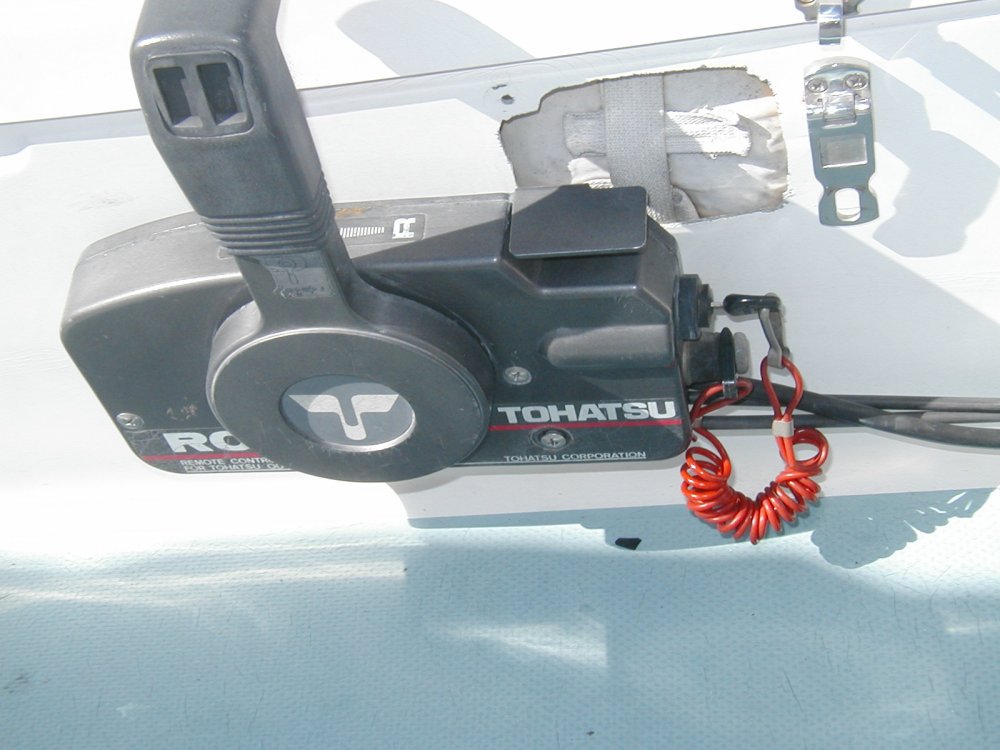

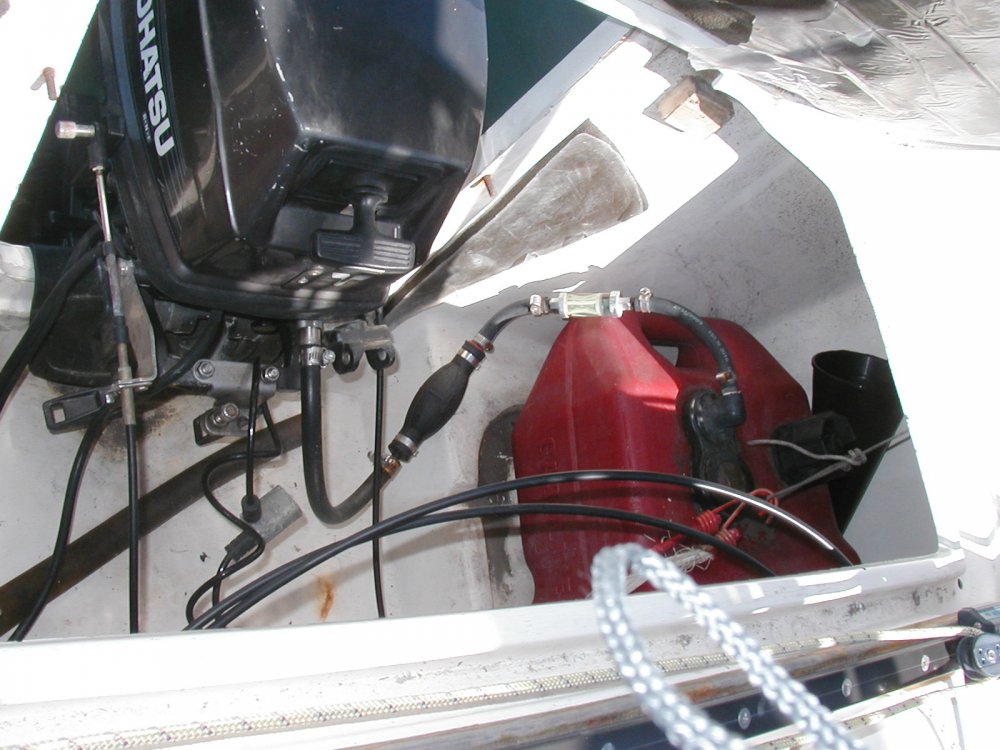

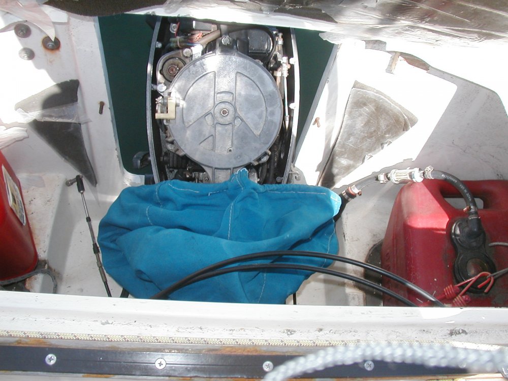

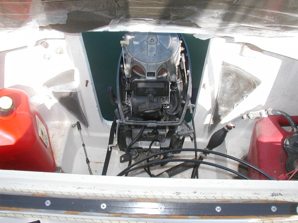

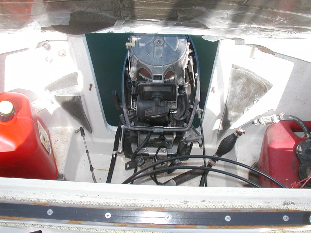

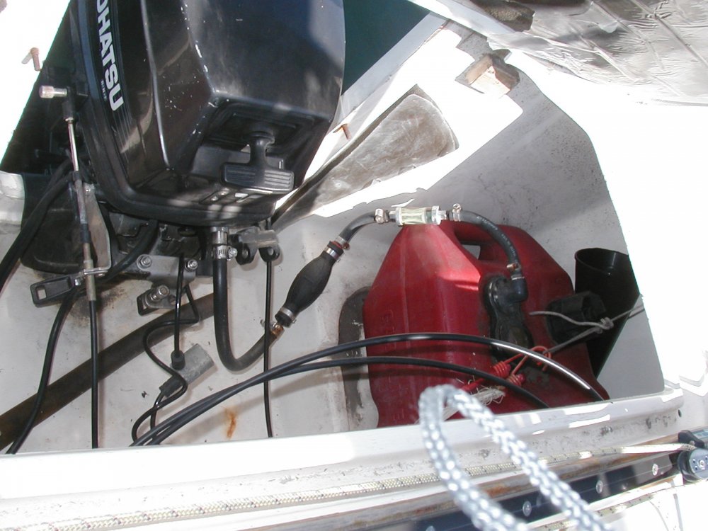

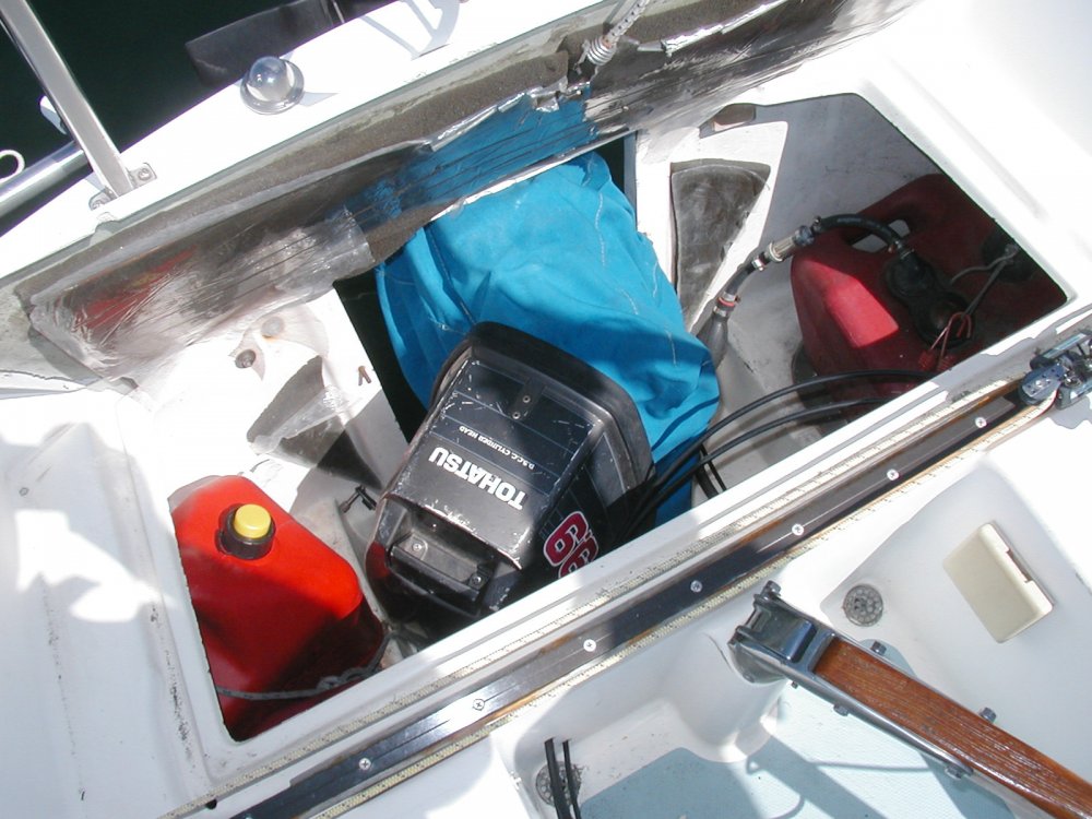

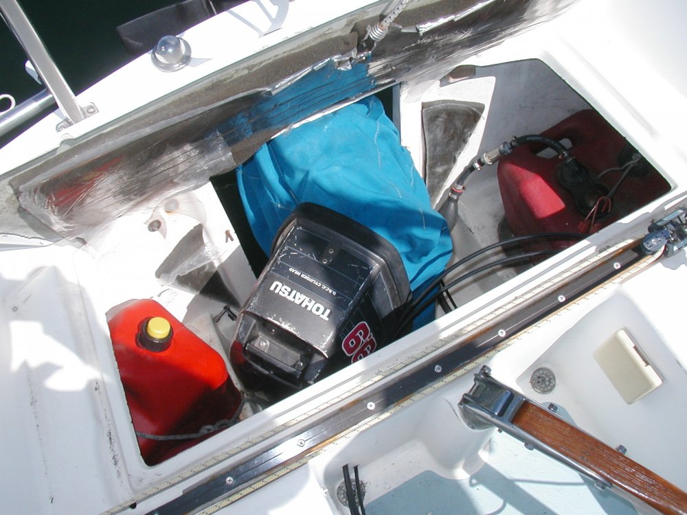

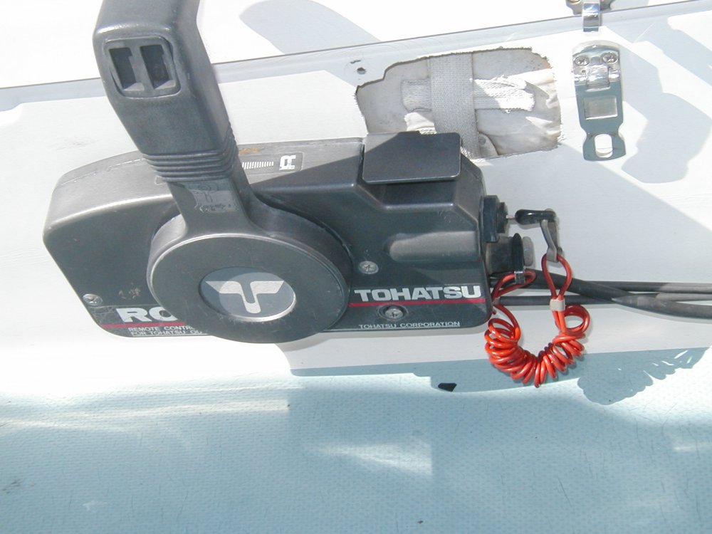

Impulse aug 04 008.jpg Impulse aug 04 025.jpg Impulse aug 04 026.jpg Impulse aug 04 027.jpg Impulse aug 04 030.jpg If you want 9.8hp or larger, the old Johnson and Evinrude's are the only type that will tilt up into the original configured motor well... Later models will have a higher profile cowling and they won't clear the opening without modification. My boat came with a Johnson sailmaster 15 hp... that fit perfectly... however... it was beyond repair with worn crankshaft and bearings. If you're handy around OB's look for something like that.
Oh, I forgot... you already have one . Well, then call around and see if you can find a mechanic to work on it.... You might try Amber Marine in Costa Mesa... though it's been a while and the mechanic could have retired ... or died???
Anyway, I found a 5 year old Tohatsu 9.9 back in 2000, that came off a Mac 26m... seems the guy wanted 50hp so he could pull skiers I guess. It was a remote control, no tiller, electric start... PerfEct! It would tip up into the opening if you pulled off the cowling/cover... so that's what I did thinking I'd modify it after a bit.... heh, heh.. that was 18 years ago... and that mod is still on the drawing board... because you get used to it. I paid $800 for the motor and another 250 for Amber Marine to dial it in with proper parts, tune up, etc. Totally worth it.
I only tilt up the motor when the boat is docked or moored... it's got a canvas cover and actually sits completely inside the motor well.... NO problem.
When I'm using the boat... the motor stays down, cowling installed, gearshift in neutral ready to go.,,, just like an inboard.
My advice is to try to find an electric start, remote box motor.... and as long as it will tilt up by taking off the cowling... that's about the best you can get right away. Be aware that the C27's swept back rudder may interfere with an extra long shaft.... Measure what you have now to be sure, long (20 inch) will work I think.
The remote electric start is awesome. Four stroke's are more efficient but heavier... 10hp is more than adequate to push the boat along a 5+ kts through chop or current. 15 is ideal.... be sure you check motor weight tho. Over 15... too heavy, over powered. Good Luck.
Tohatsu makes a lightweight 9.9 that's got good reviews. You can't buy new 2 strokes in Ca,
There are various mods for this C27 issue... so start looking.

View attachment 155734 View attachment 155735 View attachment 155736 View attachment 155737 View attachment 155738 If you want 9.8hp or larger, the old Johnson and Evinrude's are the only type that will tilt up into the original configured motor well... Later models will have a higher profile cowling and they won't clear the opening without modification. My boat came with a Johnson sailmaster 15 hp... that fit perfectly... however... it was beyond repair with worn crankshaft and bearings. If you're handy around OB's look for something like that.
