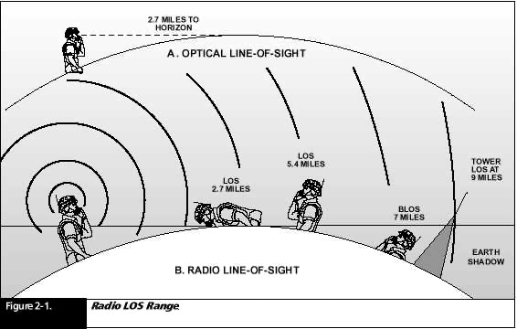

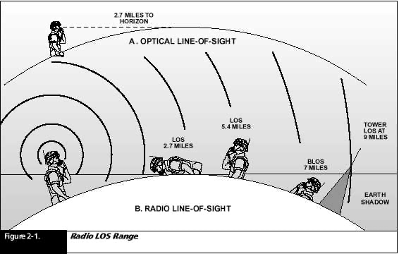

24,745
Know that VHF radios are line of sight.
How far should you be able to talk/listen?
Likes: BAD ORCA
Jun 11, 2004
1,933
Oday 31 Redondo Beach
The line of sight distance is 10 miles to the horizon. An antenna on a masthead 20 miles away can just see your masthead at the horizon level. This works unless you are member of the Flat Earth Society in which case LOS is infinity.
I'm not sure where the 10 or the 20 come from but I think I get what you are trying to say. Are you trying to explain that you have to factor in the line of sight from the antenna height of each of the radios and add them together?
14,159
Yes. It has to do with the curvature of the earth. Other things can shorten line of sight, such as buildings and mountains.
