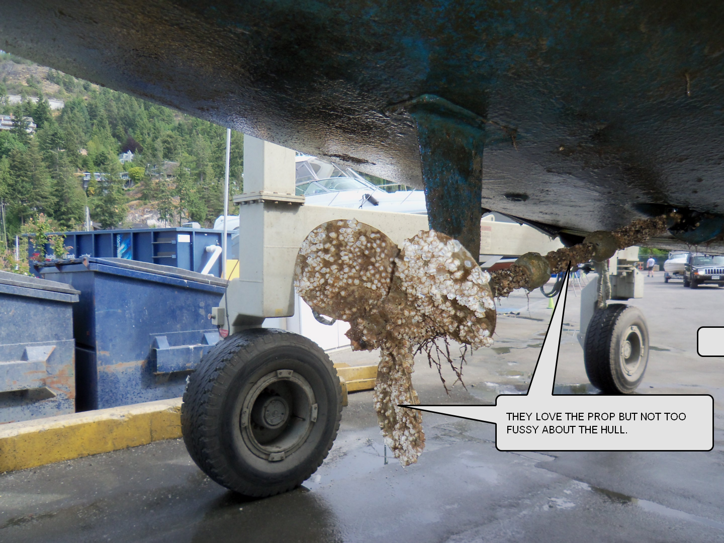

Ralph, that picture makes me want to grab my sanding blocks!
Buddy's going the B-ham next wk - he could get me some Trinidad.
But..... don't think I can apply it over Primocon, which is all over the keel and I'm not keen on taking that down to whatevers covering the lead + the fairing Clint did to the leading edge.
